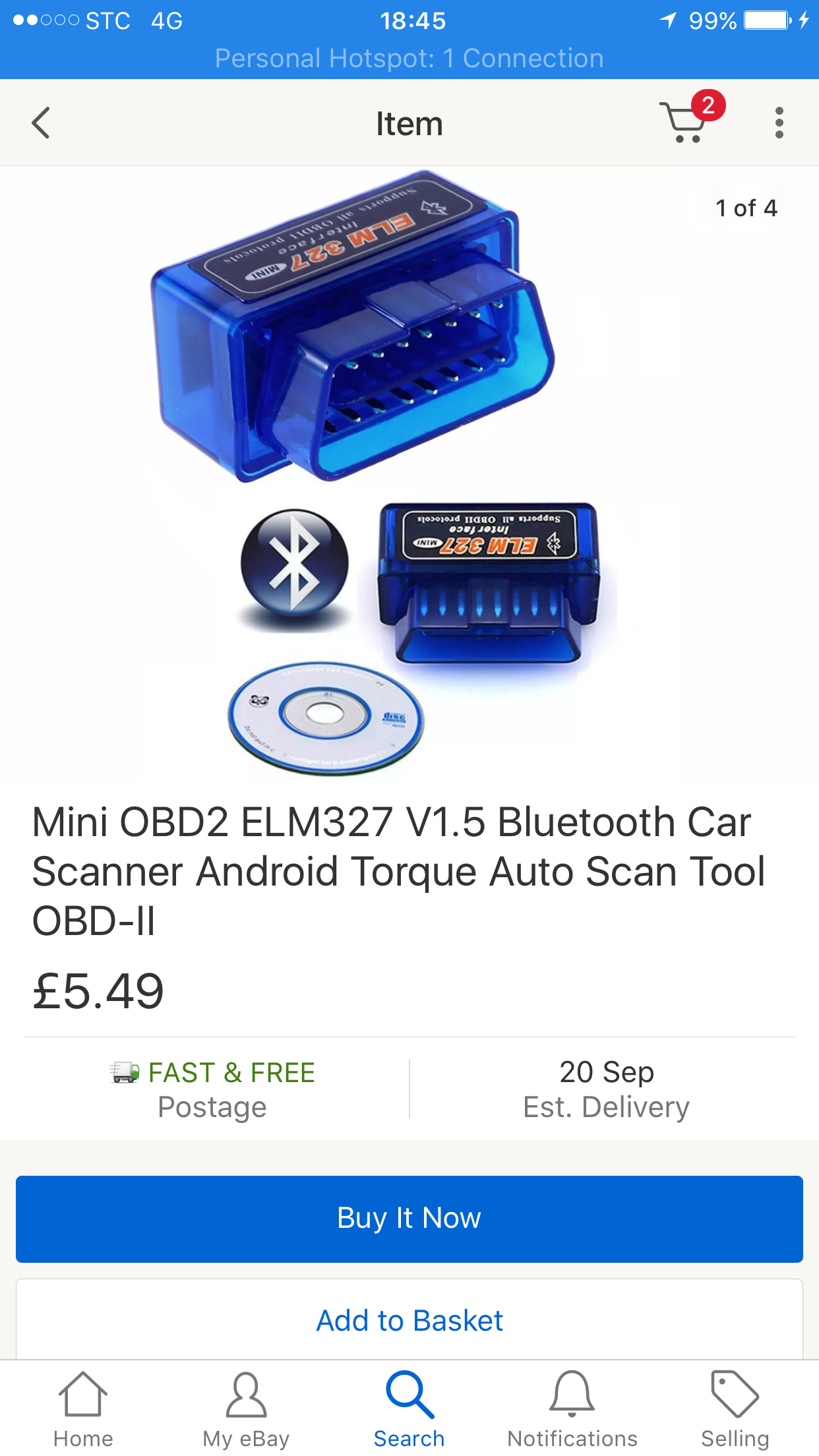

Get one of these and download the app 'Torque' from the google play store. Allows you to read the fault codes and also reset them if you want.

Markwes wrote:Get one of these and download the app 'Torque' from the google play store. Allows you to read the fault codes and also reset them if you want.
And these work ok yeah?

Post by Markwes » Sat Sep 17, 2016 5:57 pm
Yes they do the job and are cheap.
