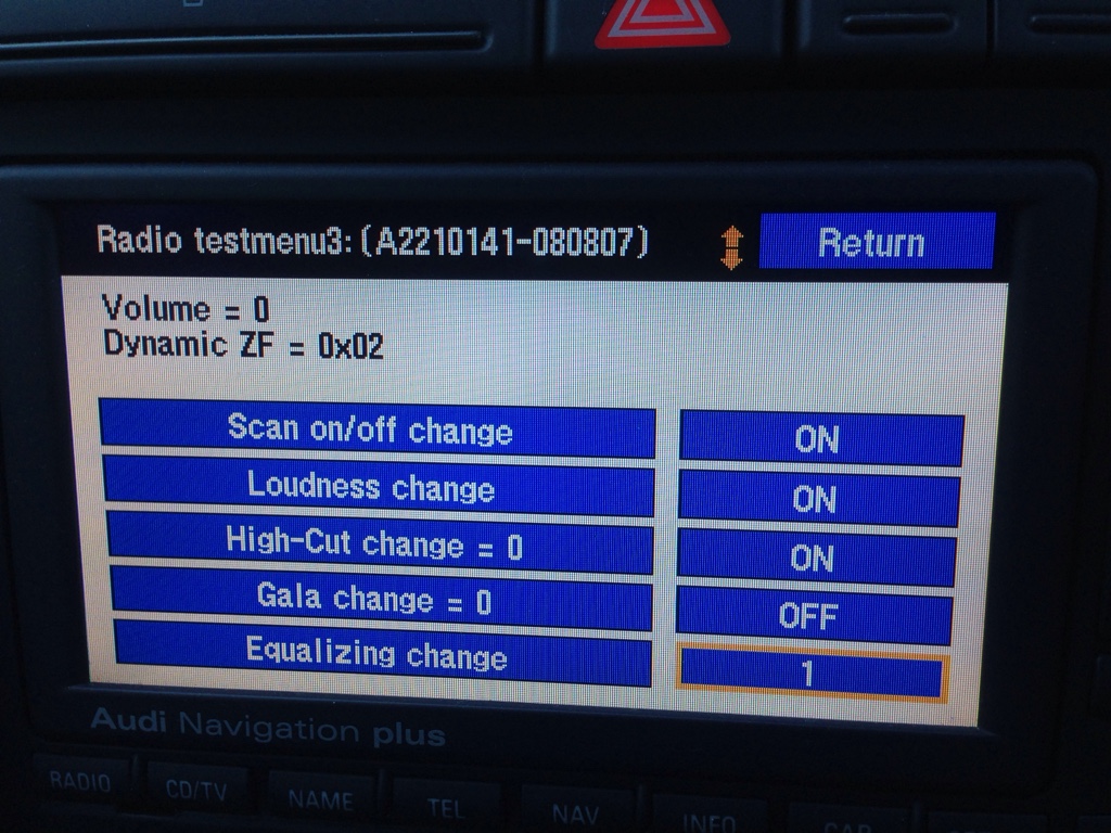

Re: Rnse startup volume
That's what the bottom setting is in radio test menu 3. Adjusting it doesn't change the start up volume
. Anything else I can try?
. Anything else I can try?Re: Rnse startup volume
Do these settings look correct? Cheers

Try loudness to off. I tried this the other day and it seemed to work when I turned the car off and on,but not been in the car past 2 days to see if it worked.

It's actually the top line "Volume = 0" that you need to change to set the startup volume (if it will work for you...).JmRS4 wrote: That's what the bottom setting is in radio test menu 3. Adjusting it doesn't change the start up volume. Anything else I can try?

Tried adjusting the 'loudness' to off but no good. I can't seem to get access to the top volume. It goes up or down depending on the volume knob being moved but cant seem to make it stick. Thanks
