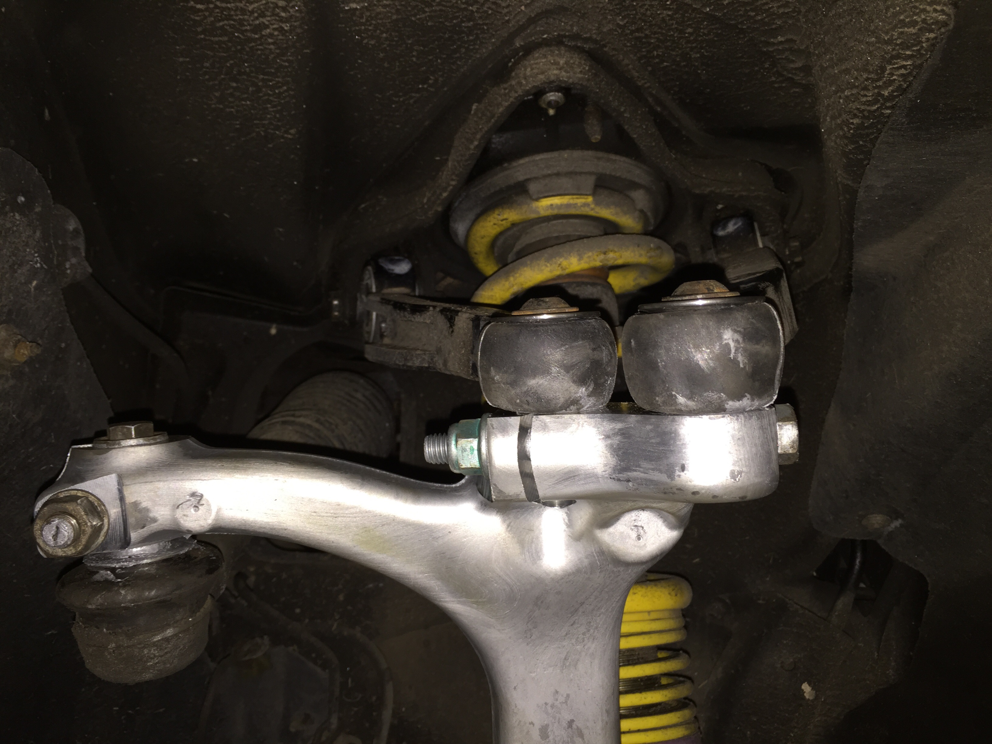

You can buy adjustable top arms that adjust your camber. They are fixed as standard though. My camber is also out due to fitting lowering springs
Re: Fed up with 20's! Advice
+1 you can adjust toe at the front but not camber unless you have adjustable arms.gt2 wrote:You can buy adjustable top arms that adjust your camber. They are fixed as standard though. My camber is also out due to fitting lowering springs

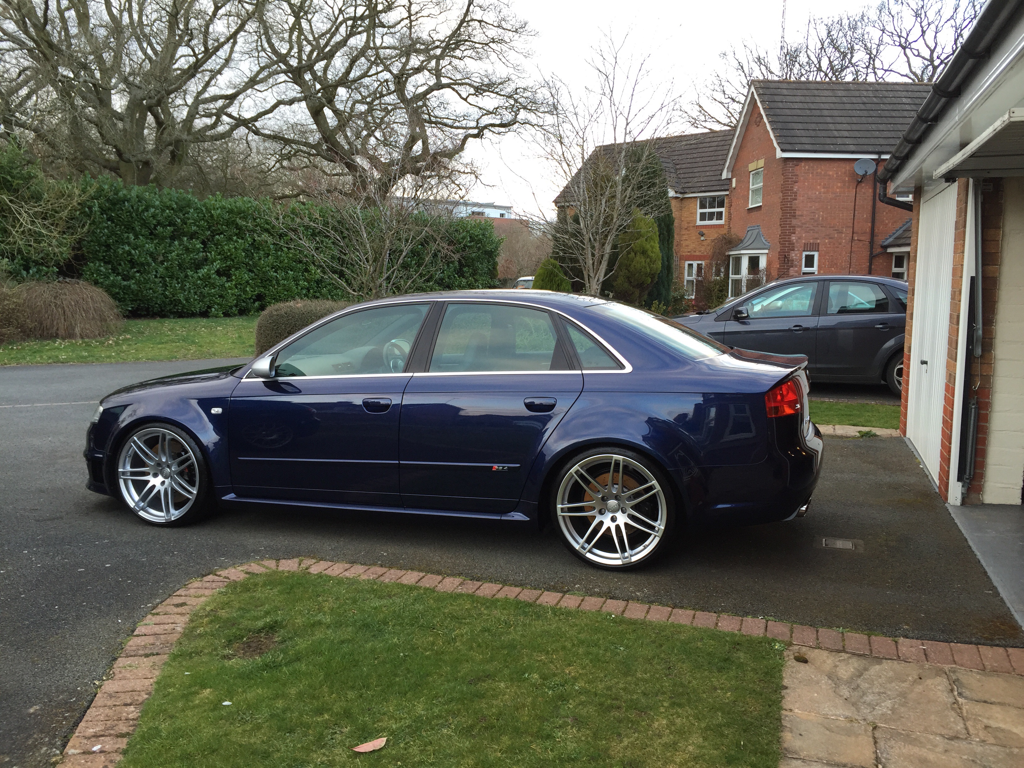

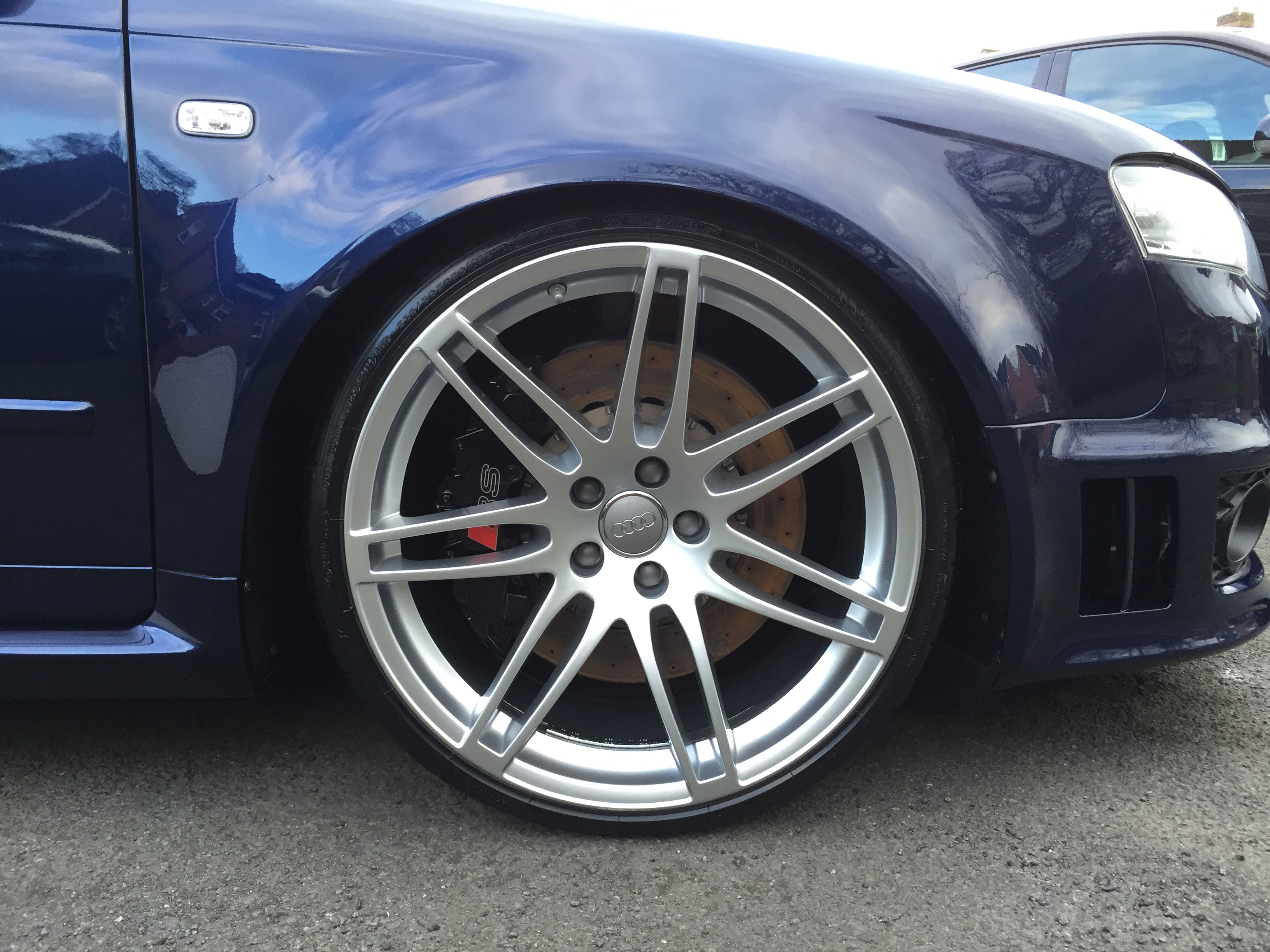

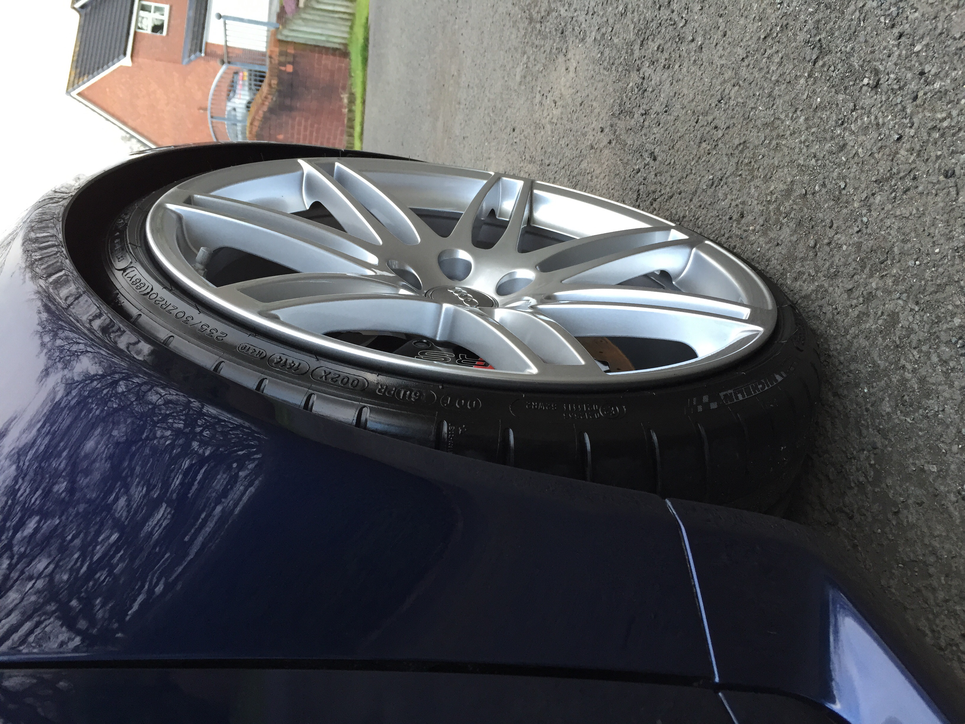

I run:
20" x 9" S5 alloys
KW v3 63.5mm front 64.5mm rear (ground to top of wheel arch)
Adjustable top control arms
Previous:
255.30.20 rolled arches with 5mm spacers = front arch's rubbing all over the place
Now:
235.30.20 flattened & respreayed arche's with 4mm spacers = no rubbing so far
It's been a week with some keen driving too.
On these wheels I did try 3mm spacers but the clearance with the inner edge of the caliper is so tight you can just get a piece of paper to slide in. So when racing & expanding I'm sure the caliper would hit the wheel. So I went for the extra millimetre ie 4mm.
Here's some photographs:
It doesn't look as low as before even though I had it dropped another 5mm all round when the control arms were fitted. The Back KW's are on the lowest setting for their tolerance too.
