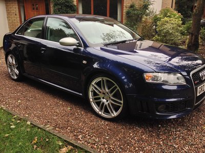

I have reset the 2nr settings under Tyre Pressure on the DIS but the TPMS warning keeps coming back every day or two. There's no loss of pressure though.
It is interesting to hear your advise on the engine start button. Are you suggesting that it is 'normal' to only have to give it a brief press and let go? I find that I do have to 'hold' it until the engine fires. Hmmm...
Photo included below for good order.
Cheers.

The TPMS warning is possibly down to the wheels. Looking at the picture you've posted, the rims are fitted with standard rubber valves whereas the TPMS valves stems are made from metal, so it's probable that the rims don't have any sensors fitted and the car will throw the TPMS light because of that. You can deactivate the TPMS warning system using VCDS software and a suitable cable, although if you plan on keeping those rims I'd suggest doing that, and adding some spacers which it's in dire need of as the wheel offset looks wrong.
Anyway there is a great depth of knowledge on here, so search and ask away
As suggested, get a clutch switch and that should sort out the cruise control problem. I press my starter button until it clicks and then let go; the car will then fire and start all by itself.

Those wheels look like after market copies?

Seeing as you need to turn off your TPMS system anyway, it might be an idea to buy a genuine VCDS cable if you are planning on keeping the car a while. Not cheap, but probably the best single investment you can make for the car.
I had the same problem with my parking sensors, check the car for error codes using a VCDS cable and you should be able to find the one that is faulty and replace it.
If it is one of the outside pair you will need to buy some spray paint to match it to the bumper.
My bumper came off to do this so that front bumper gap can be adjusted at the same time.
