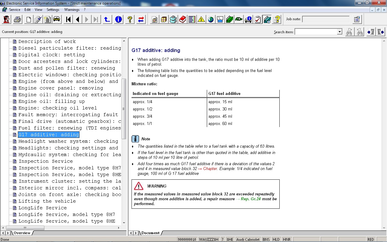

If you decide to use the audi stuff these are the instructions, interestingly it also notes how to tell if you need to do this or not (provided you have VCDS)

Post by Ice_Coffee » Sun Jan 30, 2011 2:23 pm
I would use G17 in combination with DIP 3 Aerosol as they do two different jobs, G17 cleans the injectors, DIP 3 aerosol reduces our coking problem, there is no need to use G17 unless you do the test with VCDS and fail it.
