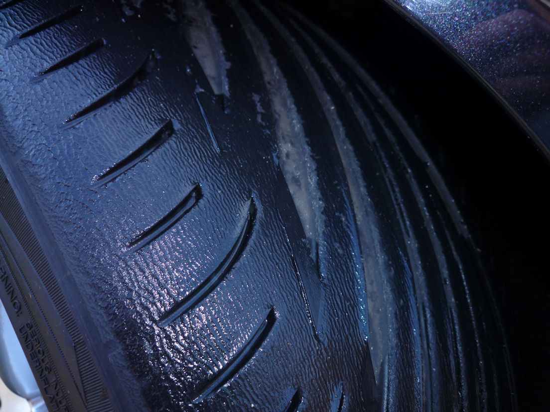

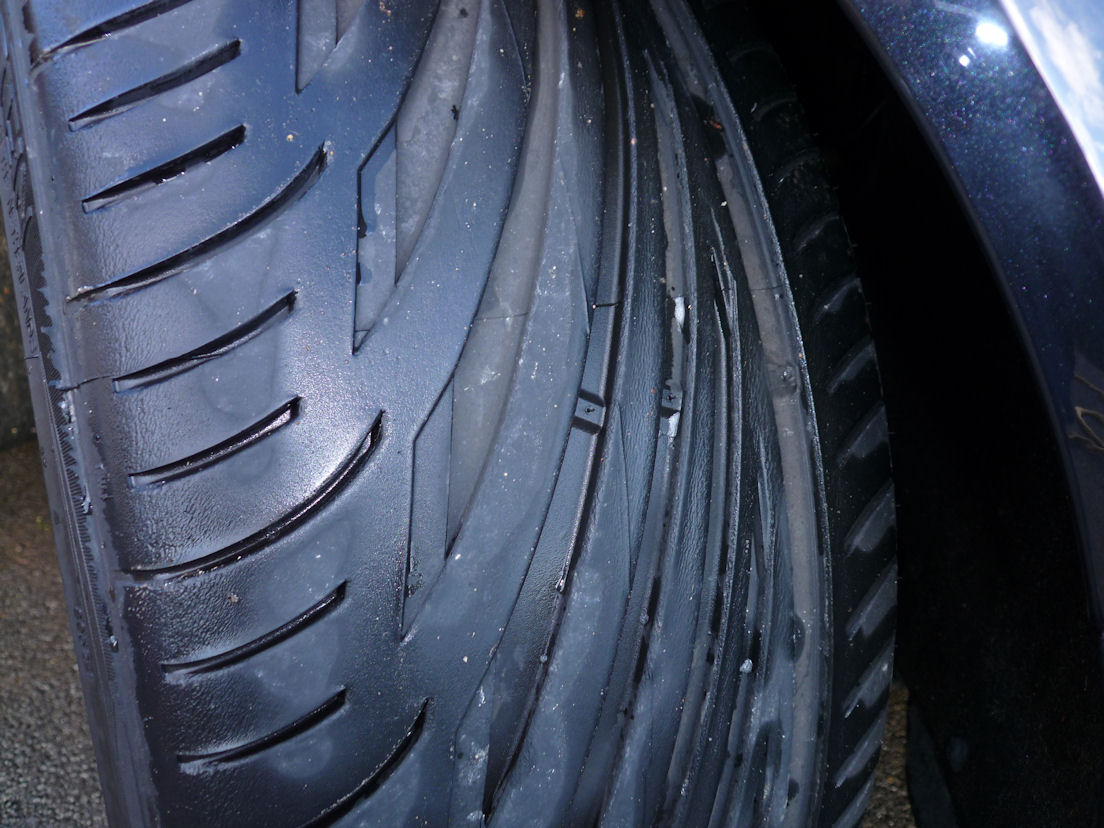

Track? What???
Can you guess which way the circuit went...
:wink:
