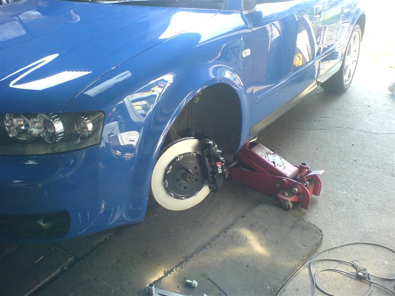

Here's a pic of the test fit :

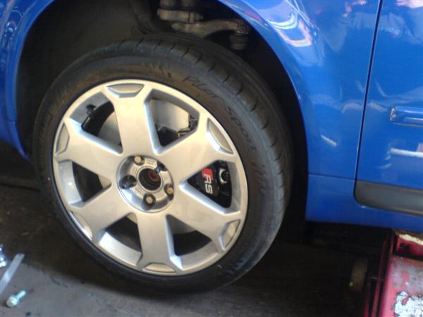

......and with the wheel on :

I hope you had a rubber cup or a bit of wood on the top of that that jack?

Post by Corey » Sun Apr 08, 2007 4:15 pm
Rubber pad

Running 19" Sportecs at present, haven't tried the Avus wheels back on but I am told I can without spacers, however I know others have run Avus wheels plus 5mm spacers.
[/quote]
That look great 8)
I also was told (NOT by quattronic's) by a Tuner that i'd not need spacer's too ........ alas this isn't the case.
With the std wheel i need 10mm spacers to clear the caliper - tried the 5mm but not joy .
