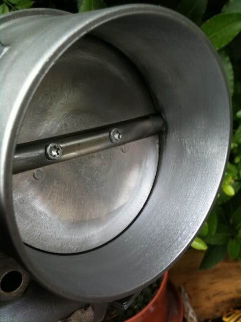

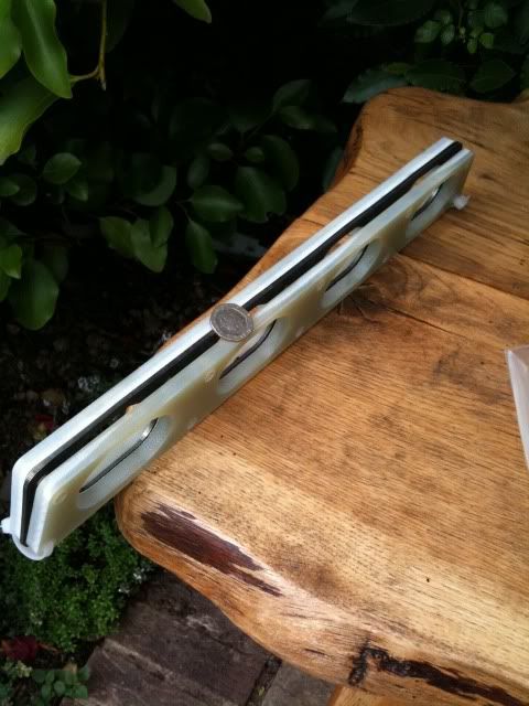

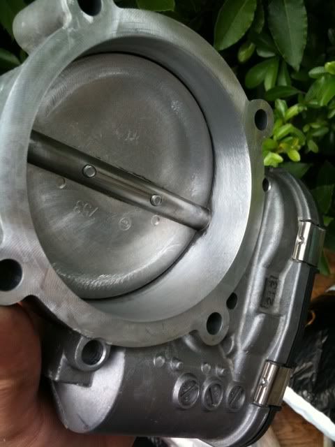

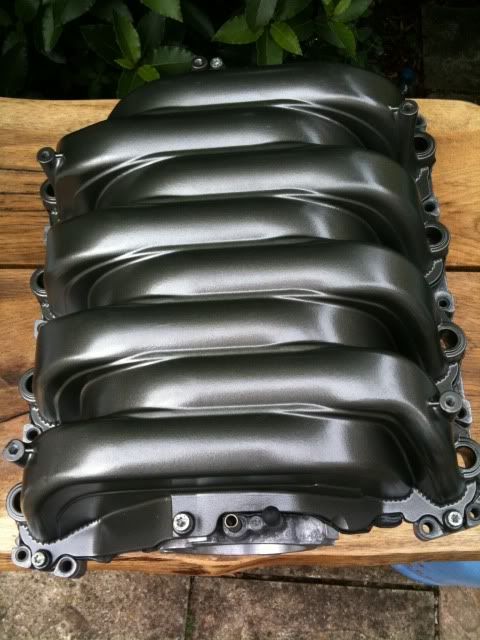

Well its finally here, after customs wanted what seems too much in import tax the robbing f**ckers!! So I thought id start a thread for anyone else interested in getting one.
Hopefully the weather will be ok tomorrow so I can get it fitted. Also got all new O-rings and pintle caps for the injectors to make sure its all spot on when reinstalled.

Right. DONE!!
Roughly 5 hours work, including sorting out a slight cock up and packing up. Very awkward at times and my hands are covered in cuts, but all in all not too bad.
If you engine is like mine give it a good vacuum before and during, I was really careful and still found dust in the valves which I cleaned out with cotton wool and White spirit. So be ultra careful and recheck
The biggest problem is that on the head you have 4 locating pins for the manifold, 2 studs and 2 plastic cones. Both plastic cones had snapped off so just drilled them out, the metal studs were seized in and showed no sign of budging so I took a gas torch to them for 10 seconds a few times. 1 came out, the other snapped off, so drilled that out and them re-tapped the hole with the stud that didn't break. So not bad, just annoying. You then just screw in the 4 longer studs provided.
You then swap over the throttle body elbow and the actuator gear onto your new manifold, fit the gaskets and spacers and your nearly there. Now it's just reconnecting all the vac and coolant lines, elec connections to the from knock sensors and the manifold, seating the manifold and bolting it back in. Then on goes the injector rail, I fitted new o-ring seals whilst it was off.
That's basically it, just need to tidy all the cables back into their positions and your done.
On first startup it you'll notice it revs slot easier and the exhaust does seem to have a little more bark to it.

No, i didnt bother. The manifold is still hot, but now you can hold your hand on it for a while, rather than before which it was almost too hot to touch, if id thought of it I wouldve used my mate laser thermometer before and after to see the actual figures. But the spacers will increase the inlet runners length anyway sotheyll still add torque and they are tapered and port matched to the inlet and head so thatll help aswell

Post by xyber » Sat Jul 03, 2010 5:13 pm
Manifold, Ported and polished throttle body, heat shielding underneath, 2 spacers, 4 Reinz manifold gaskets, 14 longer bolts, 4 longer positioning studs, jubilee clips, repainted in factory paint, 8 new O-rings and 8 new pintle caps and a 1hour long installation guide DVD and P&P $1716.35 / £1129.25
Customs fees £231, but I think I got overcharged by £50 going by my calculations so ill claim that back
So £1360, but then you send back you old manifold (shipping back is about £50 with parcels2go) and you get a $500 refund.
By then end itll be £1000 all in, give or take a bit for the exchange rates. Then the cost of a remap
