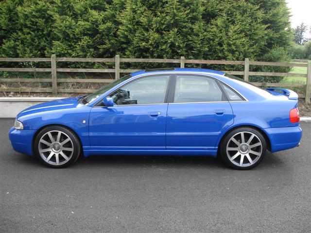

Yep B5 reps. I know there are varying standards of wheel as with most things. The reps on mine are the relatively more expensive ones from Italy I think. There are some cheapo ones from China. Maybe it's the spokes themselves that cause the issue on some!
Image[/img]

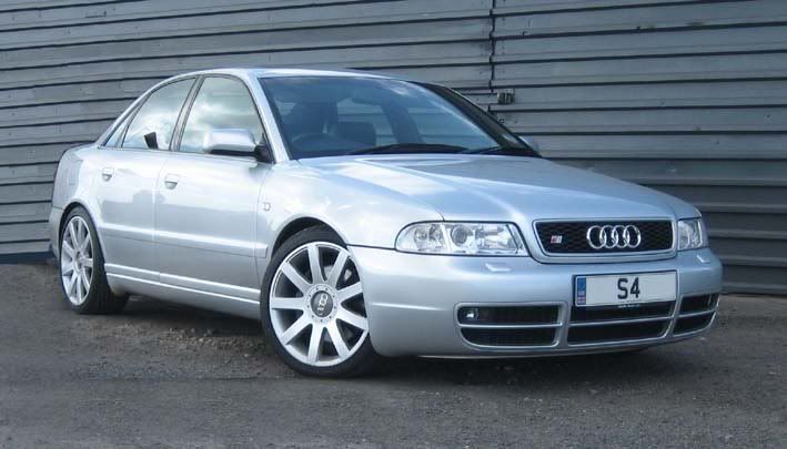

images:

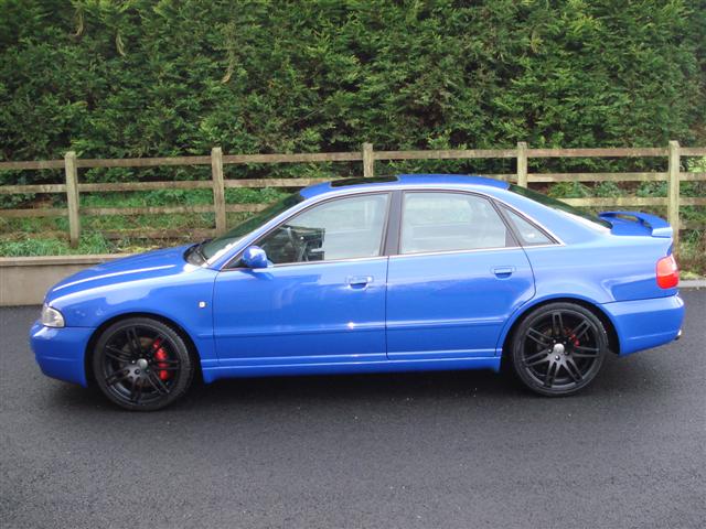

hehe, i think it might be your wheels they look quite flat compared ours.
heres mine on -25mm weitec springs

Post by dazzer » Wed Mar 18, 2009 10:04 pm
Yep think you may be right. Still takes a little closer inspection to see the difference. I was considering getting another set of reps so glad I am now aware of this as I could have been a tad miffed as I don't want spacers on my car.
