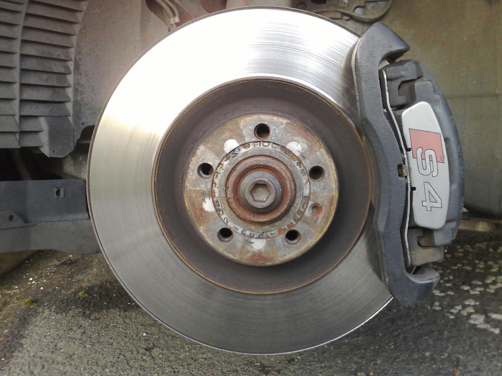

Yes the B6 brakes will fit under the standard S4 wheels etc. Had them on my car but upgrading now to brembo 4pots and 380mm discs. PM me if your interested in them.

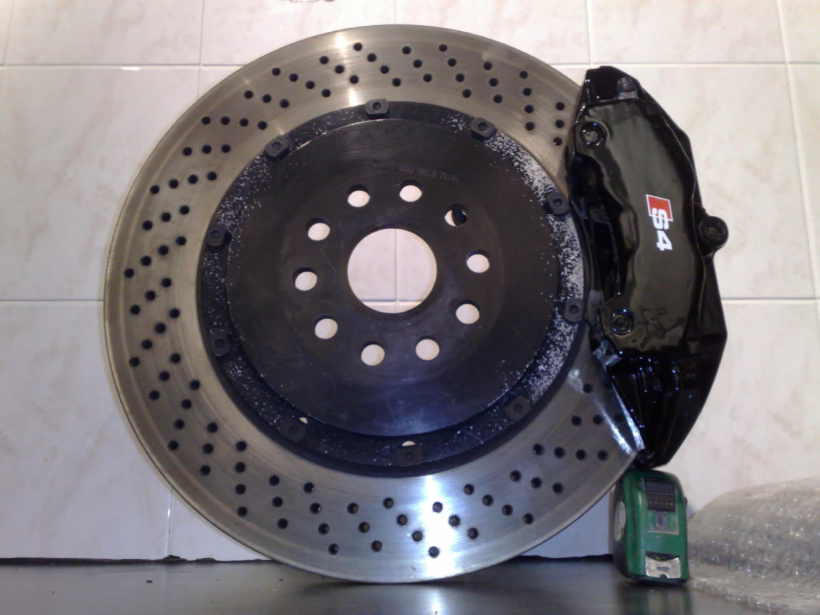

B7 RS4 8pot fronts and B5 RS4 rears with Goodridge motorsport braided hose on a B5 1.8t.
pedal feel is awesome, no sponginess at all, stopping power is great even as I am still getting the break in coating off the pads
wheel/tyres are a little close to the arches, no rubbing but they are coming out a little
