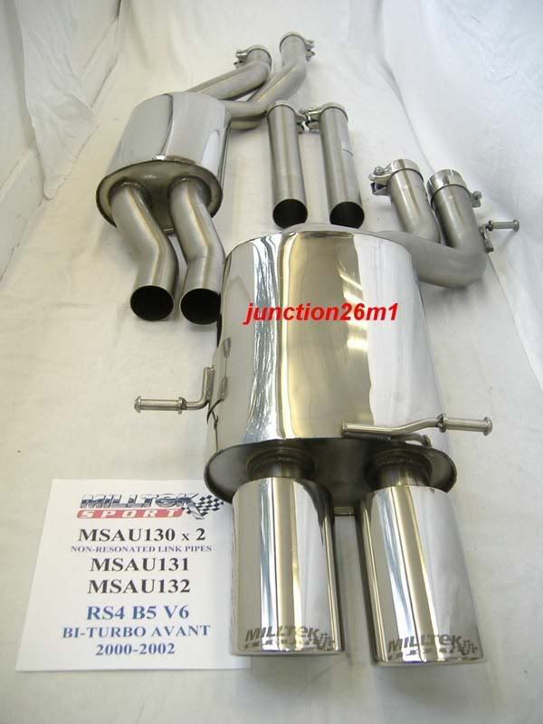

There a thread here which may help. http://www.rs246.com/index.php?name=PNp ... torder=asc
I found £65 difference on the RS4 between this
and this
Not a hard decision
and this
Not a hard decision
The big difference between the two seems to be that the miltech is a dual system just like the original and gives the benefit of keeping to the original design spec of the V6 engine,that being the engine is designed as two 3 cylinder engines running from the same crank and therefore you can measure the emmissions from one bank of the engine separate to the other and this makes life easier when diagnosing certain problems which with the supersprint single is not possible.
Hope that is not too confusing.
Cheers "Bingo"
Cheers "Bingo"
2002 Noggy RS4,AP 6 pots,Revo,H&R big arb's,milltek.
