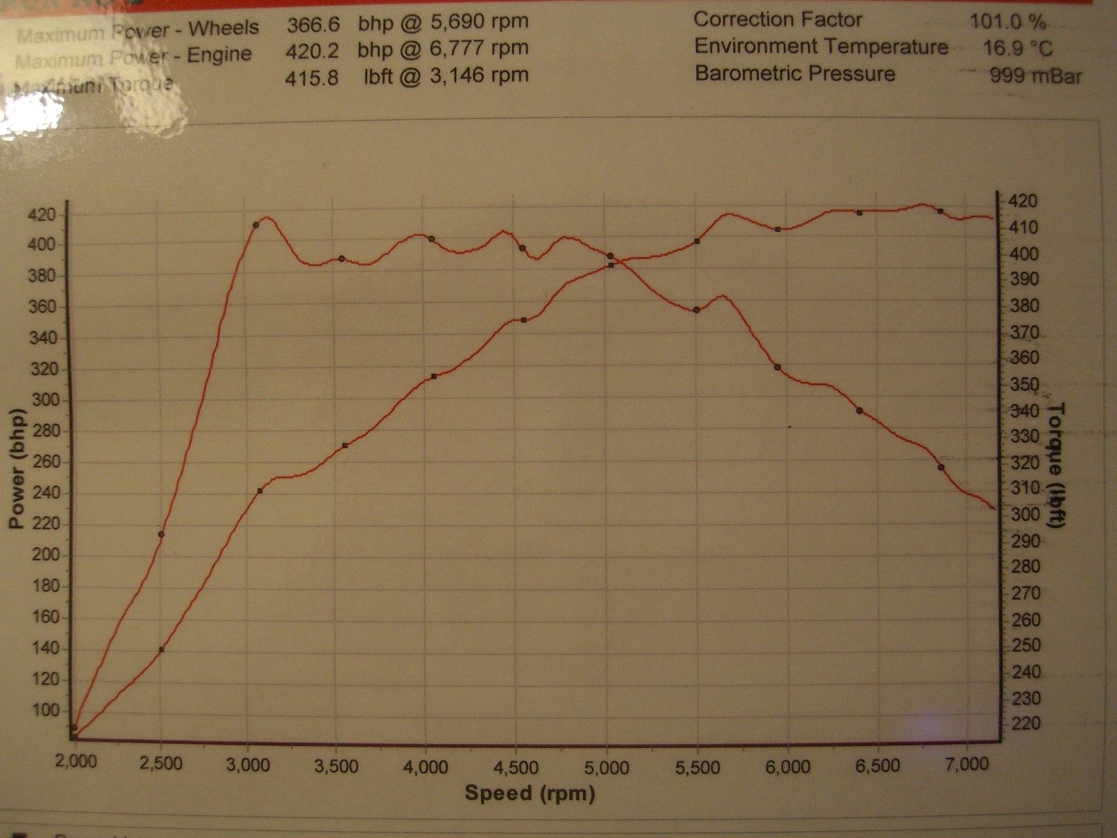

367 whp, 415 torque on the RR today.

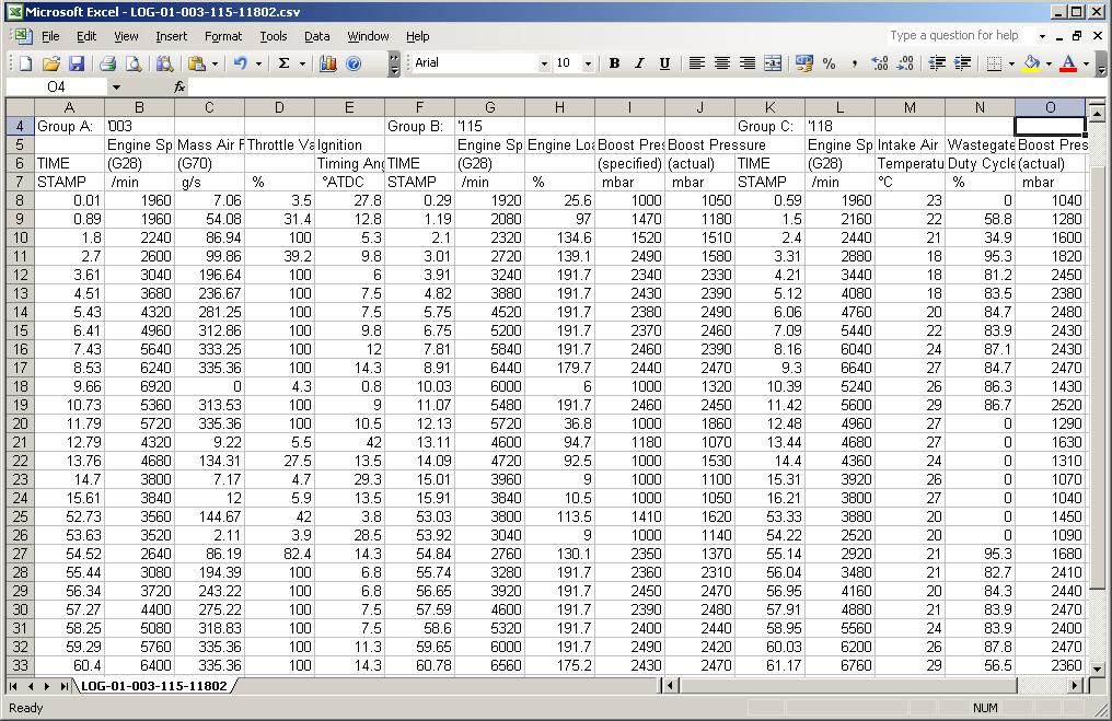

did a quick log, boost seems okay to me, can anyone comment on any of it?

RR's can be dodgy , there are too many variables and some of these guys I am guessing may be on k04's but have done a few other things to improve their results. be good to see all your graphs from the day

Heres todays log:...

not seen k04 hybrid graph before but looking at it you could prob get some more power with a better exhaust or manifolds, seems it was held back after 5500rpm

That torque curve looks way too flat. Sounds like the car may be choking and not breathing for whatever reason... exhaust maybe? Your torque curve should keep rising till about 5k.
Could be as simply as a bad tank of fuel causing timing to be held back.
Hybrid cars quite often seem to play up with power figures, that is why I avoided that route and stuck with the modded K04 route.
Biggest thing I think is the manifolds and exhaust... that is where you can see 60-80HP increase. Sad to say engine out and stupid money. Big thanks to Mihnea who spent 20 mins on the phone convincing me to get the manifolds.
