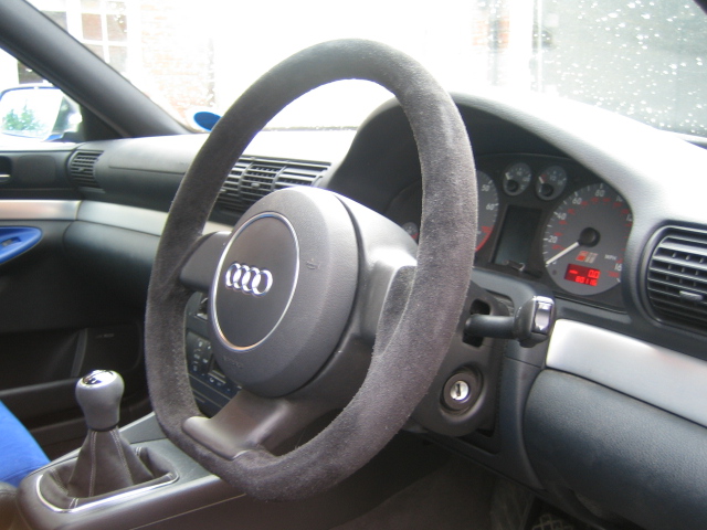

After some detective work and some shopping around on ebay managed to get Alcantara flat bottom s/wheel. Wheel is also available in Carbon Fibre
or Leather (it's a Lambo/Momo part).
Airbag is from an A8 but S4 has a single firing mechanism and new type airbags have a dual firing mechanism so airbag not connected at moment.
Have any of you B7 s/wheel conversions boys connected the firing
mechanism in any way ?

I'd have thought so. You might need a B7 (or similar) airbag control module, possibly an electronic interface and at least a certain amount of re-wiring.
From reading other threads on this (B7 wheel into B5) the airbag control modules are different (single vs two stage) hence I imagine you will need to replace the module. BUT I don't know if the control module will work with other modules in your B5, I don't have the wiring digrams for A/S/RS4s so can't be much more help.
If you are a computer geek like me then it's like sticking the wrong version of a DLL in your application and still expecting it to work, chances are it won't without further work.

I have a TT MkII wheel with dual stage airbag, and I will install it to B5 S4 when I have time. I'm planning to connect the two ignitors together. Let's see hot it works... (and I know about the correct resistance issue)
