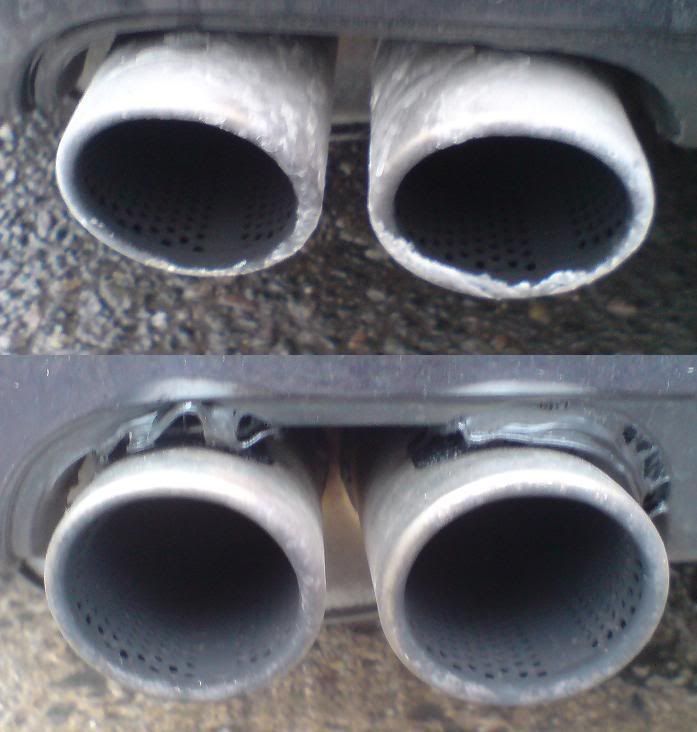

The 3 runs themself were actually quite uneventful, however I did smell burning, and immediately suspected the clutch. Naa... clutch is fine. The f**king exhaust has melted my rear bumper! Before and after pics to follow...

Ladies and gentlemen... I give you the before and after photos of the 'Meltek' exhaust!

OMG!
That pic is scary!
