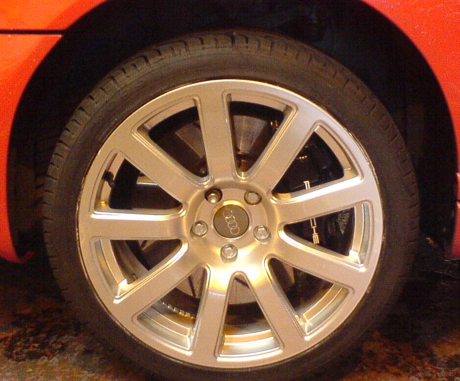

these fit no prob's and no spacers needed..they are MTM replica wheels
these are the ECS stage 4 brakes fitted to my S4 with coilover's
Picture 729.jpg (107.94 KiB) Viewed 829 times

Post by bobbler » Sat Feb 02, 2008 9:56 pm
Those are nice Woody, any ideas where I can find them? And are they 18's?
The only other wheels I really like are the B7's and would rather not buy a set only to find they wont fit either.

Post by s4woody » Sat Feb 02, 2008 11:39 pm
they are 18's with no spacers just a straight fit..even cliveH has them on his car with the RS6 brake set-up..not sure if he has used spacer though..
i got them from ebay..

Post by s4woody » Sun Feb 03, 2008 12:41 pm
well just look at the gap around the discs in my pic..plenty of room..
