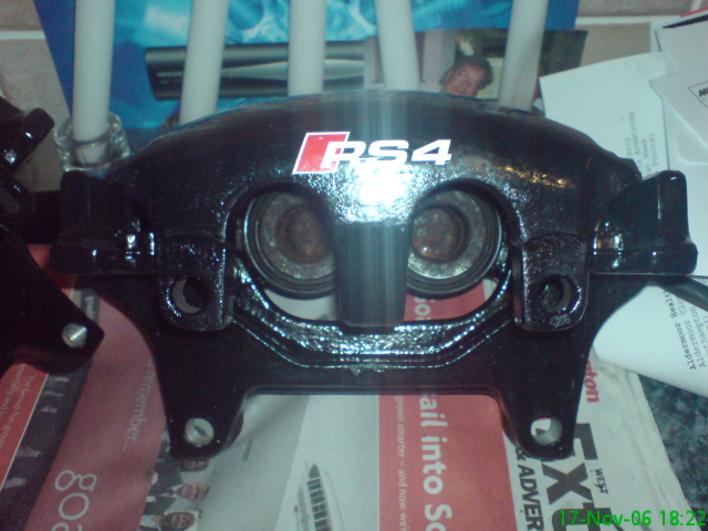

Cheers for all the replies. At the moment I have 18" RS4 reps on so it does sound like the first option is to get hold of a set of RS4 B5 calipers, are they a direct fit?
h8cak
Posts: 1370
Joined: Wed Oct 11, 2006 5:03 pm
Location: Southampton UK
Post by h8cak » Mon Nov 20, 2006 7:43 pm
Yes a direct fit. Very easy. I took nmine back to the metal and re painted them and added the RS4 Brake decals
Wide Body S4
