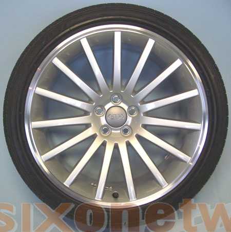

Just saw these and thinking about them
They come in 5/112 et 35
Not sure about fittment.
Will i have any problems with these?
I think im down to 2 sets. Just depends on fittement i guess. If they both fit i need to decide which set i want.
MTM reps
or these.
Anyone fitted rs6 set up with these? They are Audi TT quattor cup reps
