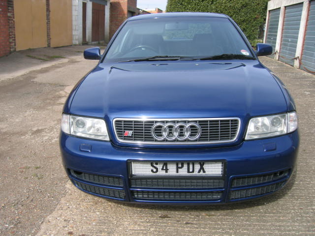

just need to fit my special number plate,note the lower bumper grilles fitted

Good job on getting the lower grilles to fit over the FMIC pipes dude .... what's the secret?
Deus ex machina
rolskii
Posts: 1143
Joined: Sat Oct 22, 2005 1:52 pm
Location: riverside
Post by rolskii » Sun Mar 09, 2008 8:32 pm
S4TAN wrote:Good job on getting the lower grilles to fit over the FMIC pipes dude .... what's the secret?
Time I reckon ... looking good ..... :D
happy dayz .... party ....
quattronutter
Posts: 352
Joined: Fri Sep 07, 2007 12:11 am
Post by quattronutter » Sun Mar 09, 2008 10:16 pm
a sharp hacksaw is the key

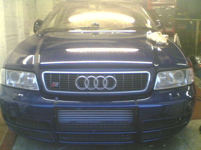

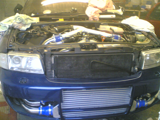

its my own homebrewed fmic,pipework made up from 2in stainless also has a shrouding which you cant see in the pics,stops any air escaping round the sides of the intercooler,every little bit helps...

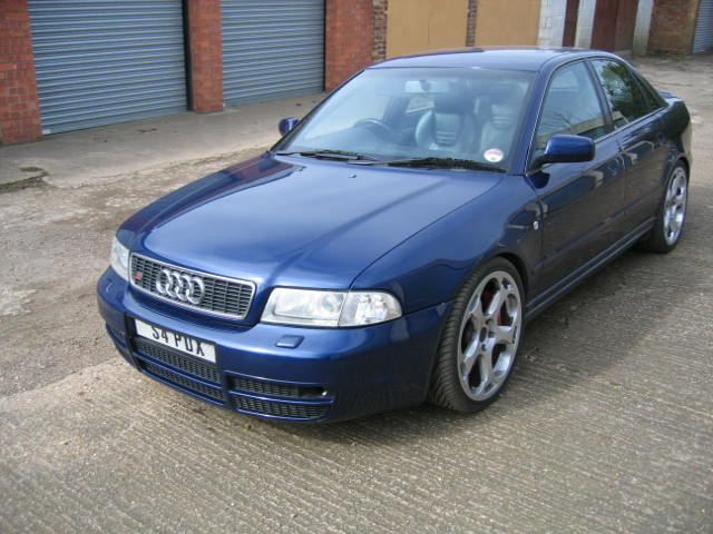

Post by quattronutter » Sat Mar 15, 2008 12:12 am
its alive again 8) just need to rack up a few miles before some map tweaking,then its time for the rs4 panels to go on
