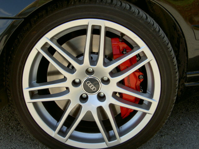

Here are some pics of the RS6 Calipers and RS4 B7 drilled disks I just bought.
Been around the TT course a few times now, perfect! I actually think I need a harness now to hold myself in! :lol:
Do I need bigger wheels ??? :? :lol:

What size have you got there?
18's?
I think the 18's suit them fine. Looks like calipers just cleared the wheel.
Bit like the standard breaks on the avus wheels, looks like smae sort of cleareance between the wheel and the caliper. Discs look fine.
I think 19 inch wheels look a bit too big.
Im going for same setup with RS6 wheels. 18 inch.

Yeah, they are RS4 18"s, and not much in it!, but it works!
Cheers, yeah, think I will keep them, I just need to clean them up a bit, and replace those terrible centre caps!! they look so weathered!

YOu running 235's or 225's?

saf wrote:YOu running 235's or 225's?
255's, they are original RS4 wheels. When I got the RS4 arches etc the 225 looked out of place! :o
Some pics of the 225's with the RS4 wing, had RS4 calipers then, but u can't see them in the pics unfortunately

@Viperbl, looking good IMHO no need for 19's

That is such a cool setup :thumbs:

Viper. I want to run similar setup.
What are your rim measurements and offset please?
I tke it youre running 8.5 x 18 for the wheels. Just need off set info. thanks

eek, offsets, ... no idea mate ... :?
NS Racing put the wheels on for me, and yeah, Diligent did all the body work for me ...
How can I check the offset/rim measurement??
Edit to say around 460 bhp and 450 ftlb.
