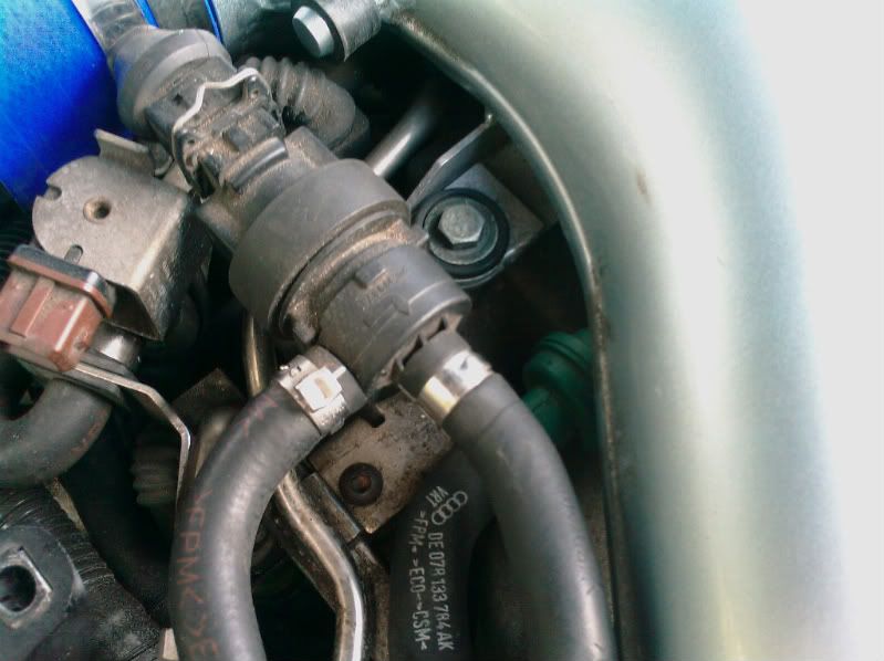

Pressure tested it, there was a tiny leak from the right hand Bi-Pipe (really high pitched whistle) but fixed that. at around 14psi there is a wierd buzzing noise (sort of sound like an air pump) coming from the photo graphed area.
Sound familiar to anyone??
Any ideas?
Any ideas?

RE: Re: RE: Re: RE: FMIC Fitted!
Could be your N75.
the green one way valve that connects to your F hose is not working correctly
The buzzing felt like it was coming from either the green valve or the black solinoid valve. Whats the part code for the green valve? is it worth change the other green valve at the same time?
the green one way leaks then air foces through the black solenoid(making hte buzz noise) and pressurises the fue tank!

Re: RE: Re: RE: Re: RE: FMIC Fitted!
Can't argue with the god.Doug_S2 wrote:the green one way leaks then air foces through the black solenoid(making hte buzz noise) and pressurises the fue tank!
Makes sense.

RE: Re: RE: Re: RE: Re: RE: FMIC Fitted!
Changed both the green valves (the one not in the picture had gone) and boost pressure tested, all was okay, but just been out for a drive, and it was only making 5psi again, ignition off and on, and back to normal.
