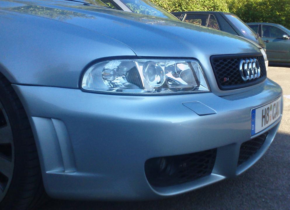

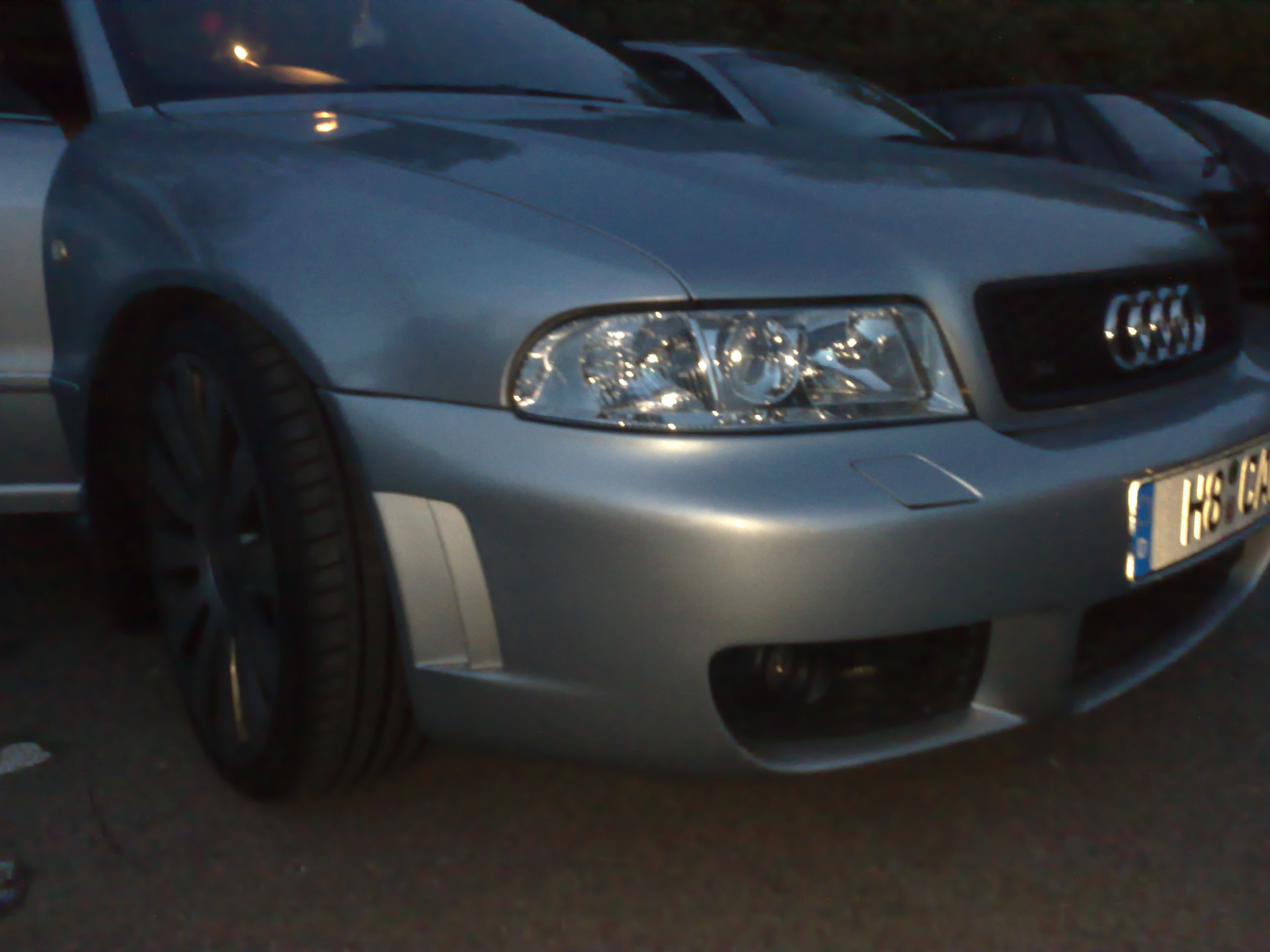

facelift headlights
Post by h8cak » Tue May 06, 2008 7:09 pm
Some pics, What do u guys think?

Post by Stigter » Tue May 06, 2008 7:17 pm
Looks miles better. Anyone got a set of facelift lights?

RE: facelift headlights
Post by h8cak » Tue May 06, 2008 7:22 pm
Ive got a spare pair of A4 facelift lights. Thats what i used. You will need to buy a H7 Xenon kit tho to replace the prefacelift xenon DS2 fitting bulbs. I was lucky with mine. I found an A4 that had Xenon lights so i just used my DS2 bulbs and ballasts.
