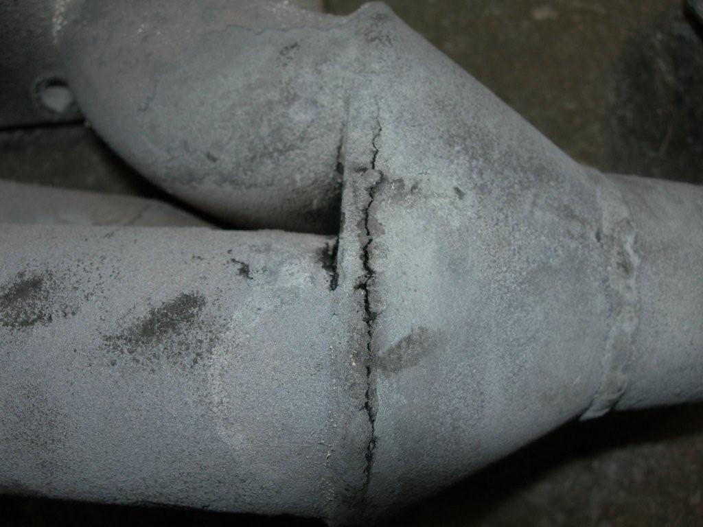

i think the awe crack where the autospeed ones crack
autospeed cracked manifolds.jpg (91.3 KiB) Viewed 801 times

the welds are only on top of the metal - you need to grind the welds off and weld them but get a good enough weld to melt the 2 metals together.

Doug_S2 wrote:the welds are only on top of the metal - you need to grind the welds off and weld them but get a good enough weld to melt the 2 metals together.
thick headgaskets are good if you want the most out of it. going to 450+ you should really have heads off to inspect the conditiopn of pistons/heads/valves etc.
If it is a really early S4 - you might have thin headgaskets - i have had one s4 heads off and the headgaskets look like normally aspirated thickness -so that car will be high compression andwill not run decent boost on ko4s.
So you are saying that the cracked manifold scenario can be prevented or the chanced minimised by rewelding? I think I need to explore this before putting mine back together. So no amount of bracing of the turbos will help this situation?
My S4 is 1999 facelift but with the earlier "C" ECU.
Hmm that welding doesn't look at all good to me, I will inspect mine fully and beef up if necessary.
The cracking will be due to vibration so bracing the turbos will help, rewelding will also help, when I do mine I will report back with solutions and piccies.
Doug, I think that when I arrange with yourselves for a book-in, to get the fuelling kit and remap done I will arrange for MRC to do the head gaskets, I would prefer yourselves to replace head gaskets than myself.
Pics of your solution will be very interesting, particularly if you can beef up the welding without doing anything that disrupts the flow internally.
