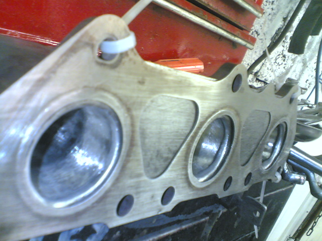

How well are the manifolds matched in standard form?

Post by quattronutter » Fri Jan 11, 2008 4:46 pm
the exhaust manifold is very poor,i have removed a good 3 mm all the way round from each mani exhaust port,should help flow slightly better,inlet doesnt look too bad although there is a fair amount which could be removed on both the head and manifold,im not going that far though

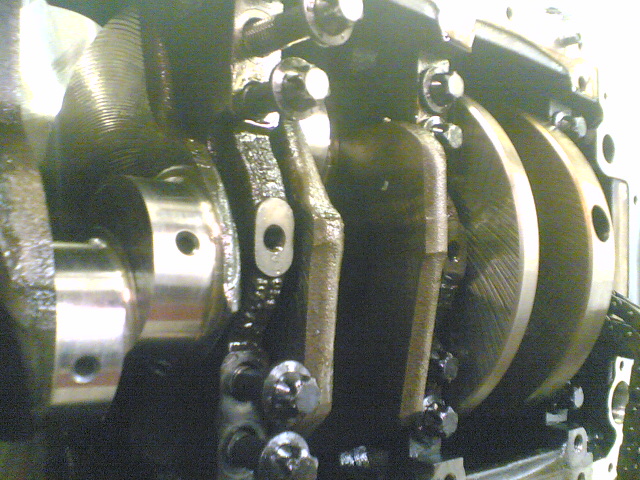

the car is a pre facelift but has the later type double bolted main caps the same as diesel block :?

Post by lemond » Fri Jan 11, 2008 7:51 pm
They all have the double bolted main bearing caps AFAIK

Post by quattronutter » Fri Jan 11, 2008 7:55 pm
main stealer said only 2000my onwards came double bolted,then again what do they know...

Post by lemond » Fri Jan 11, 2008 7:59 pm
I evn think in that Audi tech guide issued in 01/98 also called self study program 198 it shows the main caps four bolted....
and the middle two are cross bolted too!

Post by quattronutter » Fri Jan 11, 2008 8:02 pm
bottom end looks pretty tough all helps to stop the block twisting i guess,just the standard rods which let it down

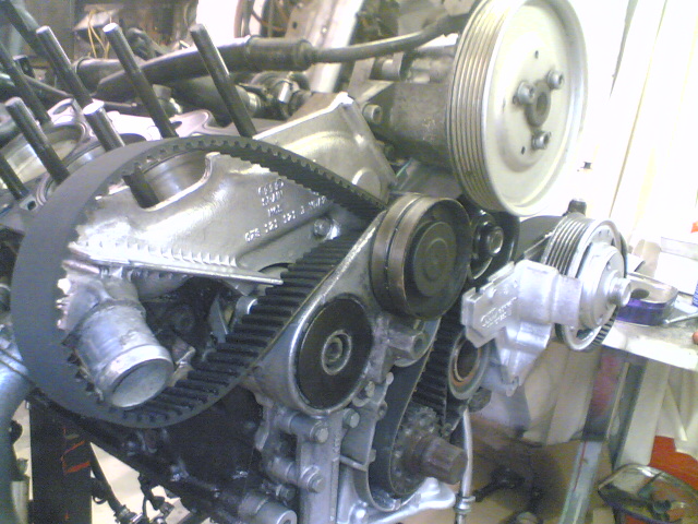

Post by quattronutter » Wed Jan 23, 2008 12:01 am
pistons and new rods in,head studs in...

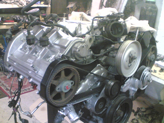

Post by quattronutter » Wed Jan 23, 2008 12:03 am
low comp gaskets and :shock: heads on,all timed up,just a mass of wiring and vac pipes to re attatch

Post by Harper--D » Wed Jan 23, 2008 12:31 am
Wow youve cleaned that up well! Or is it new parts all rounds? Cam covers and main block look really clean! What bhp and torque you going for? and what spec are you making it? I.e turbos, intercoolers, injectors, FP, clutch ect.
Dave.
White MK2 Golf.. Slightly modified :D
quattronutter
Posts: 352
Joined: Fri Sep 07, 2007 12:11 am
Post by quattronutter » Wed Jan 23, 2008 12:42 am
gave it a good clean up,loads of new bits,k04 hybrids,ported manifolds,no cats,lower compression,rods from dahlback,fmic,water/ methanol injection, as well as nitrous,already has 10 bar fuel pump and bigger injectors,was running around the 400bhp previously,no idea what it will run at with this concoction though :)
