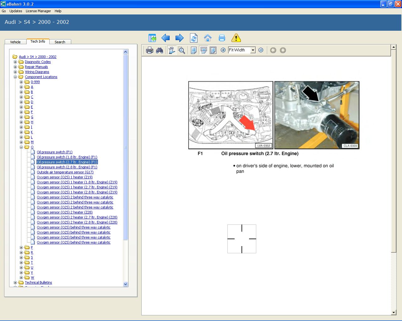

Step 4; Look up and over the top of the oil filter from around the subframe point and locate the switch. It points towards the rear of the car. (mine had a red/white wire running to it) and remove the connector followed by the switch which needs a deep 24mm socket.
