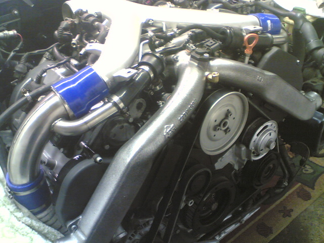

got bored today...

yep mrc ones,taken 4 weeks for rebuild in my spare time,about 3 of those waiting for bits

Those inlet pipes look so cool. Are they the MRC ones?
i think MRC use clam welded pipes..they dont look like there 1's..mandrel bent 1 piece pipes look even better..no welds at all..and when polished...mmmmmmmmm

So excluding labour obviously coz it's your own...... How much has it cost in parts etc...

so .. what the damage so far. and how much to replicate it all..

well.........with new hybrid rs4/6 turbos,conrods,lowered compression,tons of new bits,water pump,belts,bolts etc...etc...home made front mount intercooler,bi pipe and water/ methanol injection just under 6k..so far

where did you get the rods from and what pistons did you use. also any over size.?

almost there...

just noticed your water injection jet in the front. i was looking at doin the same thing with my bipipe. but didn't. only because having used water injection. before. it can make the intake sensor very cold and 'could' make it think its too cold. and dump too much fuel in.
but i dont know these engines very well- still new to me. should be fine. i went for 2 small jets on the upside of the box section. 200cc.
what size jet did you use and where are you putting the pump. looks like the same kit as mine.

not sure where the pump is going yet,was going to put it up near the battery but theres surprisingly little room,i was going to use a seperate water tank but might just use the washer bottle

I have fitted the pump under the washer bottle, on the original intercooler bracket.

nice work. what turbos are you goin for? they look like KO4's but i think they are the BIG04's, no? LMK.

yes they are k04 hybrids...tried starting it earlier but its having none of it throwing up code 16621 and 16490 which could be lots of things,these would undoubtedly throw it into limp and <beep> the timing making it even worse to get going with the extra fuel being pumped in,tried warming the plugs but to no avail....any ideas anyone?

Fuel pipes on the wrong way round ?

has fuel and a spark,trouble is being stone cold its on choke pumping in loads of fuel which is drowning the spark,warming the plugs up is not helping either..
