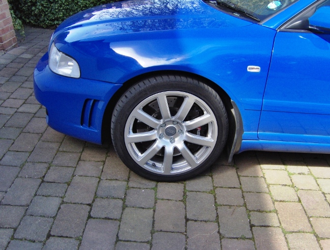

There are a number of RS4 reps out there, which vary widely in quality, exact design, and fitment. I had some, ET35, but the inside of the spokes cleared the calipers by just a "Rizzla paper" (credits to Rollskii for use of this technical term
). The manufacturing tolerances on these cheaper wheels obviously aren't to the same level as the more expensive ones.
I still have the MTM bimoto reps on mine - same as Paulm's - plenty of clearance and seem to be reasonable quality too. I still have the B6 18s in the garage, which I'm still in two minds about as they look so good and OEM, but they do need 10mm spacers to clear the brakes (ET45).
I prefer the 235/40s as they give a little bit of protection to the rims and a slightly wider track.
Enjoy the wheels and new brakes - some pics please...

Pics
Yep - RS4 B7 brakes...
