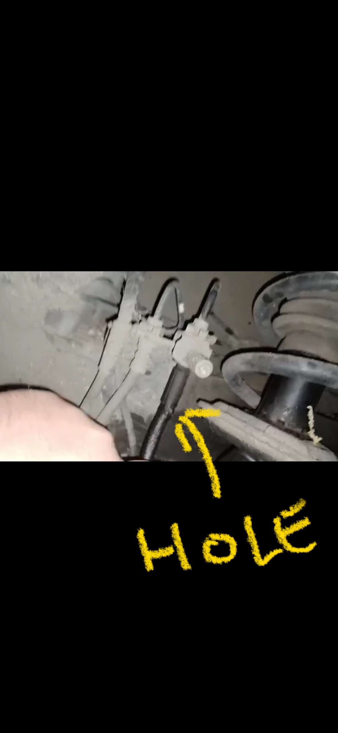

Had leaking fluid coming from the passenger wheel and lots of it - was worried it was brake fluid on my newly refurbed wheels but it looks like a drc pipe has given up and wet itself - by the time I nursed it to my local garage the suspension was not nice at all.
They’ve showed my the pipe that has gone and said it’s a specialist or main dealer only - which I kinda new.
After a few arguments with the AA they sent a patrol to the garage (after insisting it needs a truck) the guy arrived took one look and said why have they sent me, AA then called to say you are already at a garage so we can’t recover you to anywhere else. Anyway long story short I explained 99% of garages can’t replace the pipe and repressure this system so you are leaving me stranded at this garage. They then sub contacted the recovery for a time slot of 9 to 11am the next day, had 6 missed calls at 6.03 AM from the truck driver, who said you didn’t answer so we cancelled the call - Back to the AA I go - Rant Rant
Anyhow …..It’s now on the way to Chelmsford Audi and awaiting the call to say it’s going to be ££££££££££
Poor pic attached - I do have a video but can’t see how to upload

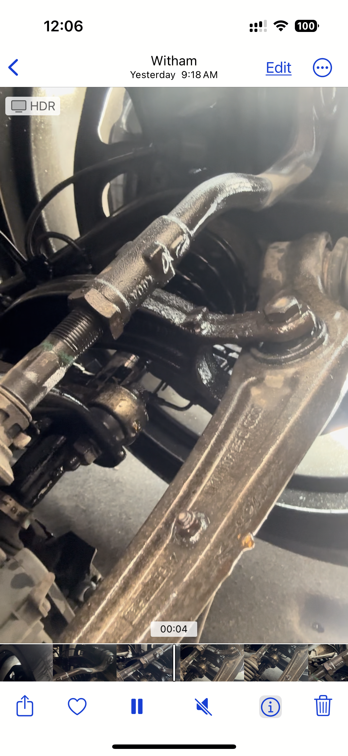

Pic from front passenger side

Post by Bobminda » Wed Jun 26, 2024 1:24 pm
Now been recovered to Daniel James performance (Southend Essex area)
They have the tooling for the recharge and have worked on many cars with DRC
All 4 flexi pipes being changed at over £800 (parts only)
Quoted c £1500 all in parts /labour /fluid /recharge
They are also doing a service/ health check ( separate cost)
So far very happy, better service and price than the stealership !
