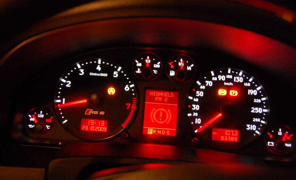

Some propper errors C5 RS6 :)
Got the following errors on VAG-COM
Any help would be greatly appreciated.

A lot of stuff looks like it's linked to the battery being removed. Also most are intermittant. What came back after you cleared the defects?
I pulled a bunch of fuses earlier to find a blown one and I had a whole lot of similar errors afterwards.
Have you checked the ECU connections? Can sometimes be corroded.
tartan_rob
- Posts: 2990
- Joined: Thu Sep 04, 2003 1:45 pm
- Location: Swindon, Wilts
Clear the lot and go for the comfort unit in the front passenger footwell. If an Avant, the rear wash pipe enters the car just below and to the left of the glovebox, a connecting pipe is hard plastic and cracks. I had the same (but without the errors) and replaced with a piece of rubber pipe. Then attack one at a time, but it looks like something simple to affect so many moduls at the one time.

It's still under Audi Freeway plan thankfully, now the middle error has stopped but the car is definately odd nothing no turbo's or anything then it's like as if they turn on and it goes like stink.
Going to try book it in with Audi soon. Trying to get an RS6 to stop once it's going with no ABS and no esp the brakes just lock and it makes things quite interesting.
Nightmare. Thank god for the warranty.
And practice your cadence braking
