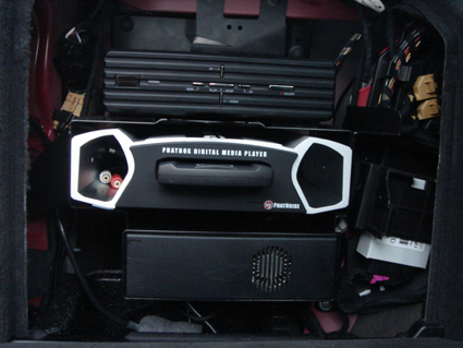

Media player and phatnoise

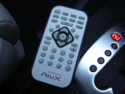

Remote Control for media player

The Nav units I fit all the time, so for me it was pretty straight forward, about 2 hours work and a straight swap, some wiring changes etc.
The TV is upgraded as well to the latest revision tuner, that takes about 30 mins, but needs a new connector at the HU end.
Phatbox is a 30 minute job as it needs to be repositioned in the CD changer cradle for a good fit.
Telephone, around 3 hours work, running the mic cable up to the lighting dome is a pain, but the rest is fairly easy tapping into the HU woring harness.
The Media player was the biggest job as it required some wires to be run from the front to back for the remote control and switched live. Also the media tray in the boot needed some work to house the player.
