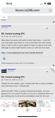

Shoppinit. Just came across technics100 2009 extremely detailed procedure to fix the door locks/micro switches. From when you had a similar problem.
Ps can you remember that far back.
Basically FCUK THAT for a game of dominoes. If it’s not the CCM then I will live with the problem.

Re: CCM repairs
Here you go Ben.
Great write up by Technic100
