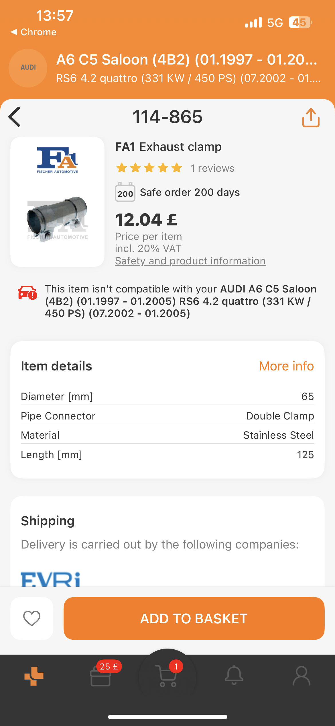

Is that the £12 ish ones Ben Auto doc. 65mm x 125mm
I think they are stainless steel.
Which is good
OE ones look a lot more substantial
$150 Canadian dollars. Waiting for a email from them.
Last resort this as high shipping costs import duties etc.
Just heard. They only ship to the USA and Canada.
Just ordered 2 from Autodoc.
Many thanks Suz / Ben
Says it’s not compatible. But it is the right part number.

The s/s clamps from Autodoc should do the job.
At £30 worth a punt.
