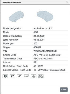

Just seen your update Jim - heres the info.JamesLawrance wrote: ↑Mon Feb 24, 2025 11:35 pmNever got chance to do it! Been fitting the engine/box in another C5 I'm doing. Will be doing it at some point this week so will keep you updated! The vin of the fugazi RS4/6 is WAUZZZ4BZ1N078538
As I suspected that a Audi C5 A6 with the 300hp V8 engine, not S6 or RS6

Thanks pal! Yeah, a bummer. The seller was great and refunded me the money for that car! So I've ended up with two cars for the price of one so I suppose there's my silver lining haha! Someone also converted that A6 to a manual, so if I can't use that specific box, at least I'll be able to use things like the pedal box and what not! Surprisingly, after 7 years of standing, both run after a small amount of work!TOPMAN wrote: ↑Fri Feb 28, 2025 10:05 amJust seen your update Jim - heres the info.JamesLawrance wrote: ↑Mon Feb 24, 2025 11:35 pmNever got chance to do it! Been fitting the engine/box in another C5 I'm doing. Will be doing it at some point this week so will keep you updated! The vin of the fugazi RS4/6 is WAUZZZ4BZ1N078538
As I suspected that a Audi C5 A6 with the 300hp V8 engine, not S6 or RS6![]()
