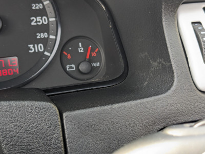

when cleaning it i didn't find any major paint scratches i didn't know about. I did find some scuffs on the dashboard trim infront of the instrument cluster.
now i've seen them, i can't unsee them.
i think this happened when the garage fitted the FIS controller for me. lesson learned. no more interior work by anyone but me. i think they scuffed the plstic while refitting the dash.

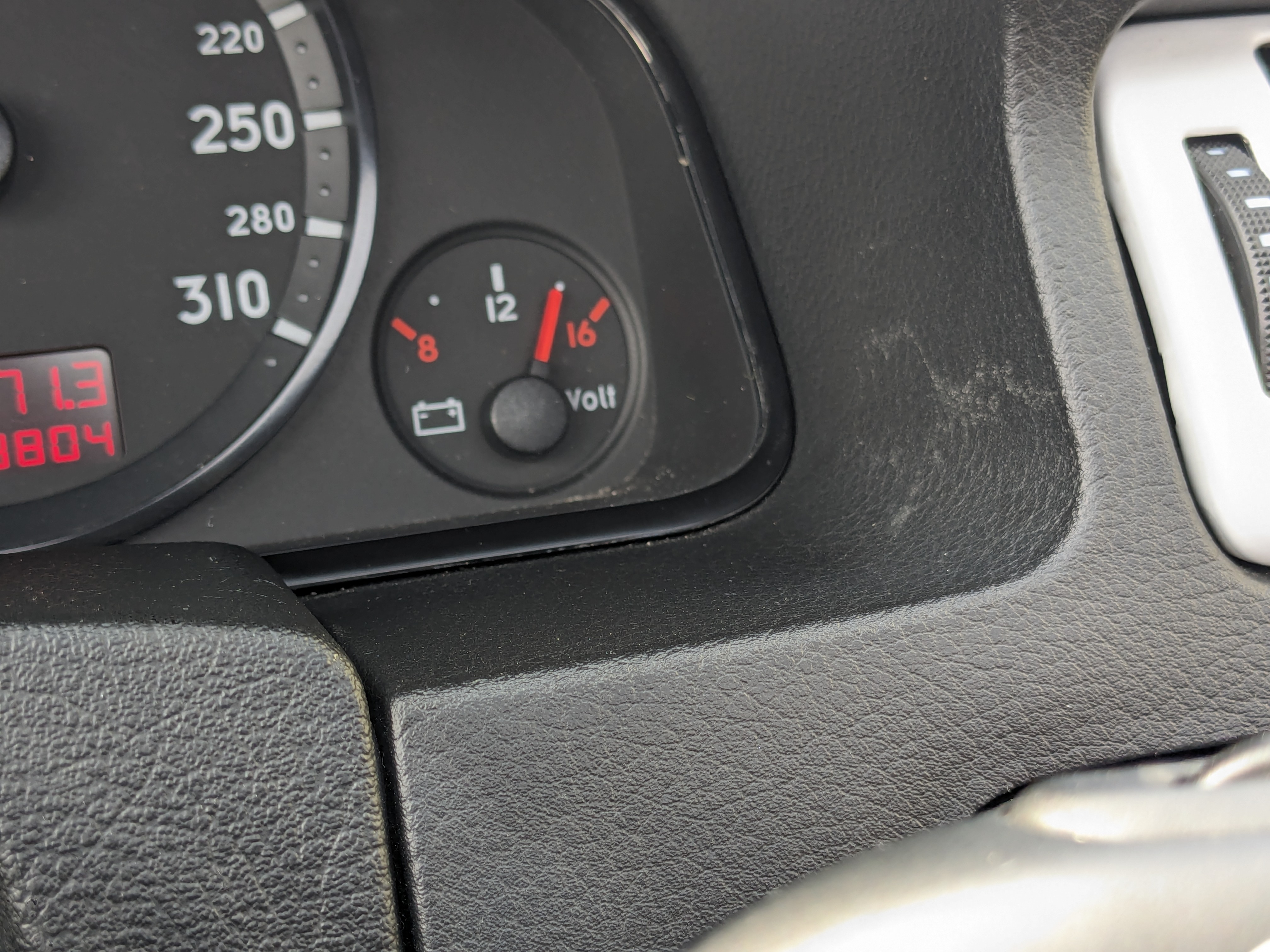

this is the scuff

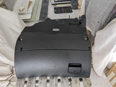

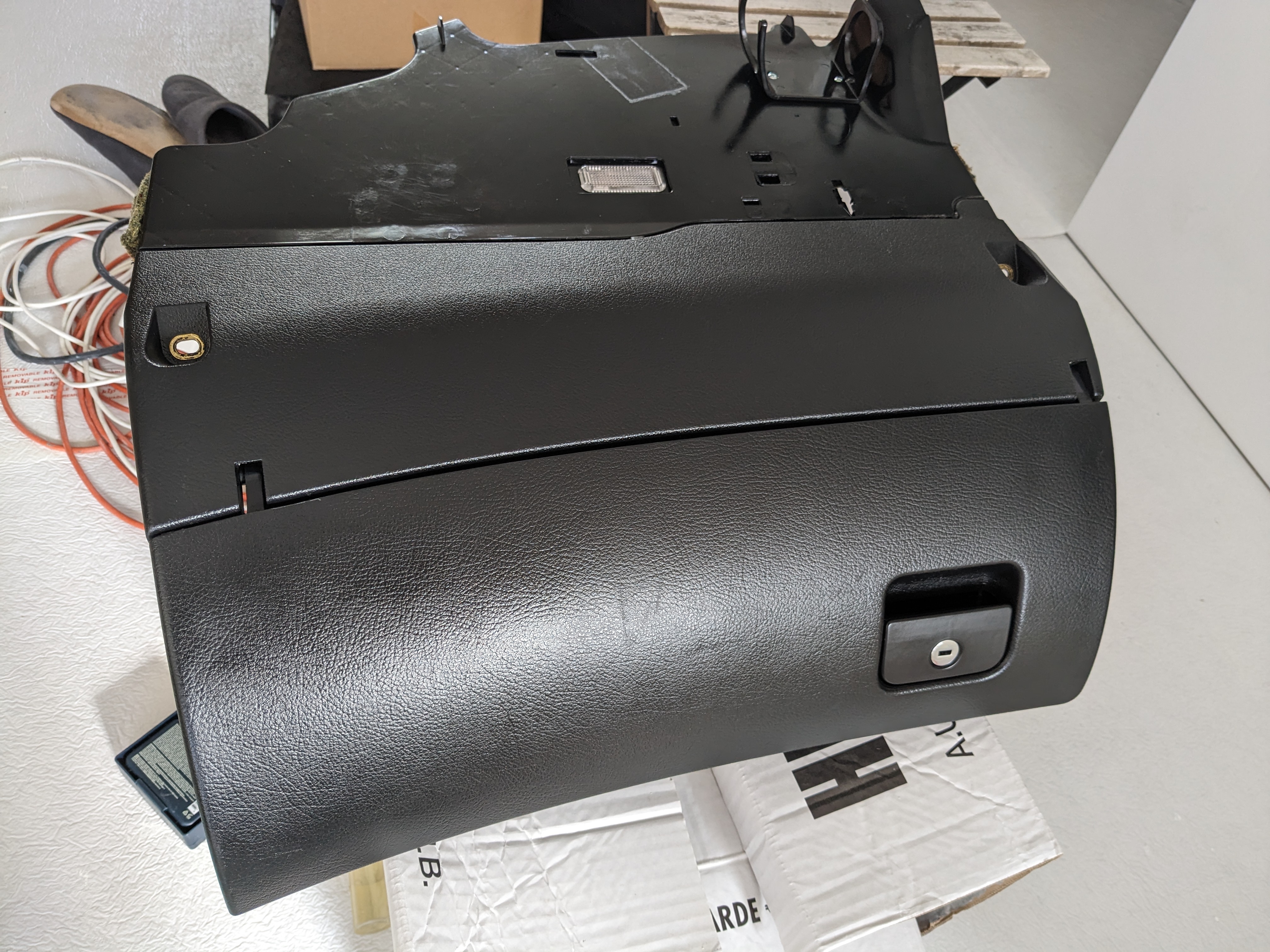

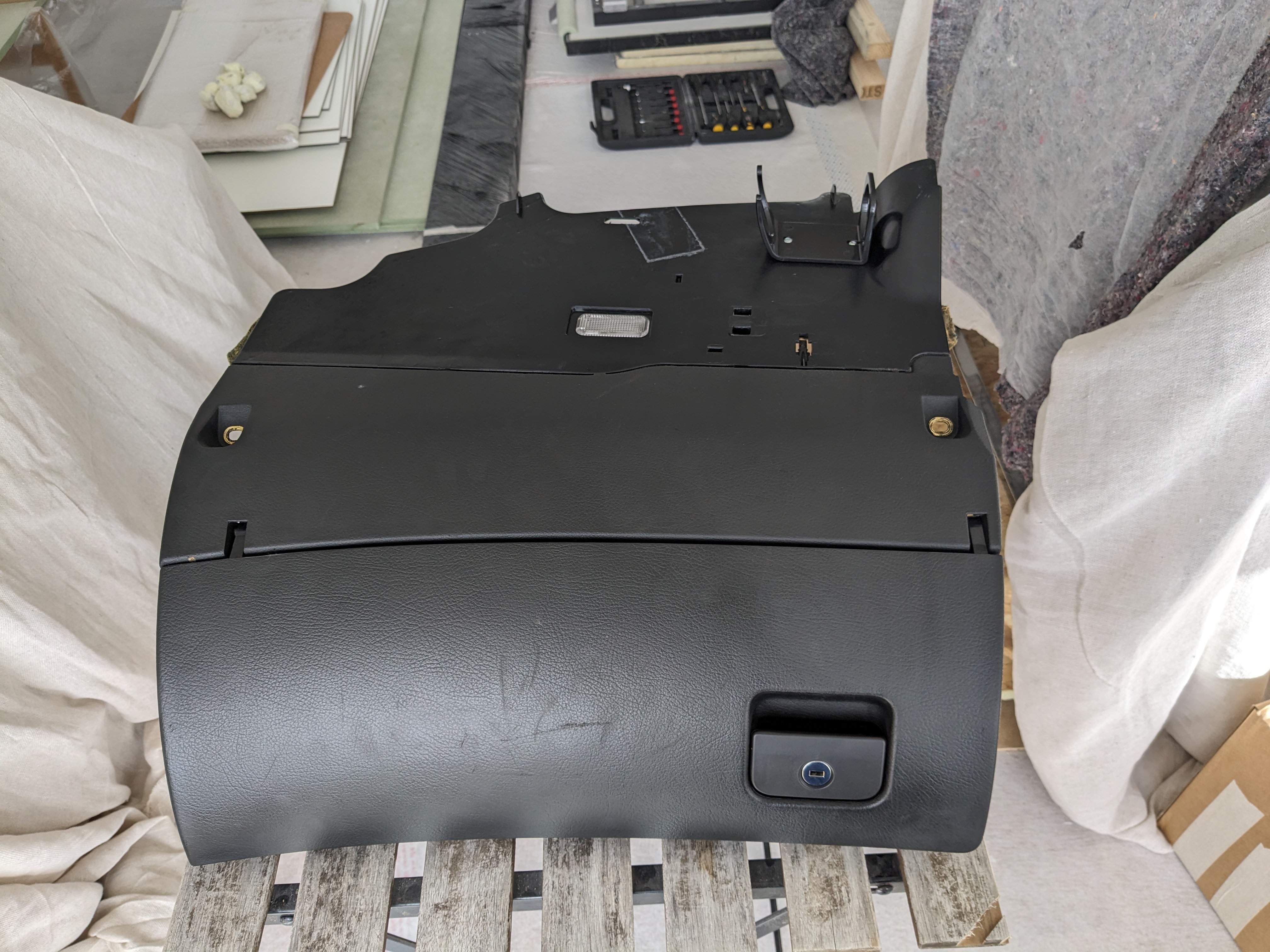

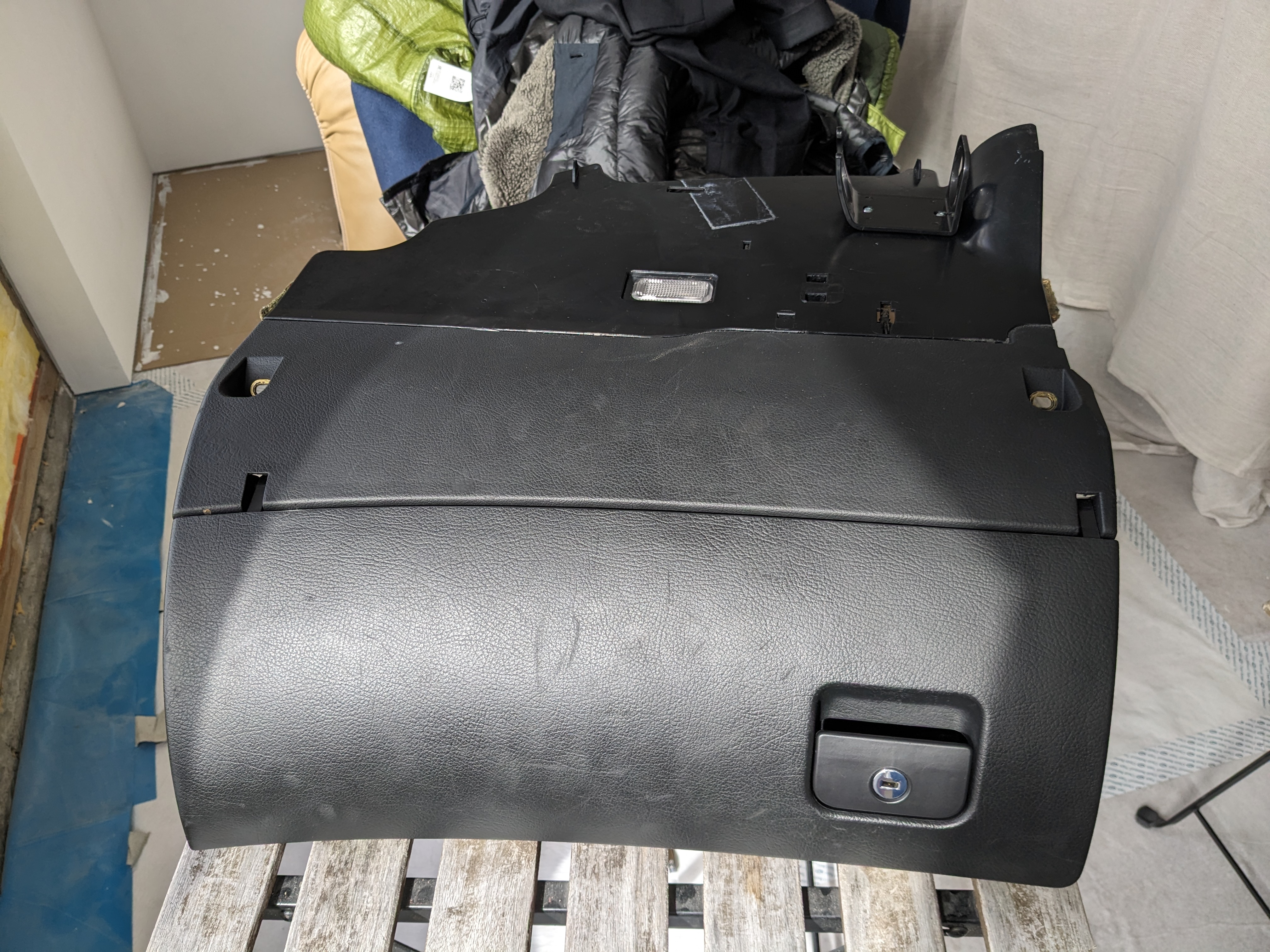

I decided to give this heat treatment a crack.
the glovebox door was scuffed and a bit more out the way.
here is before:
here is before:

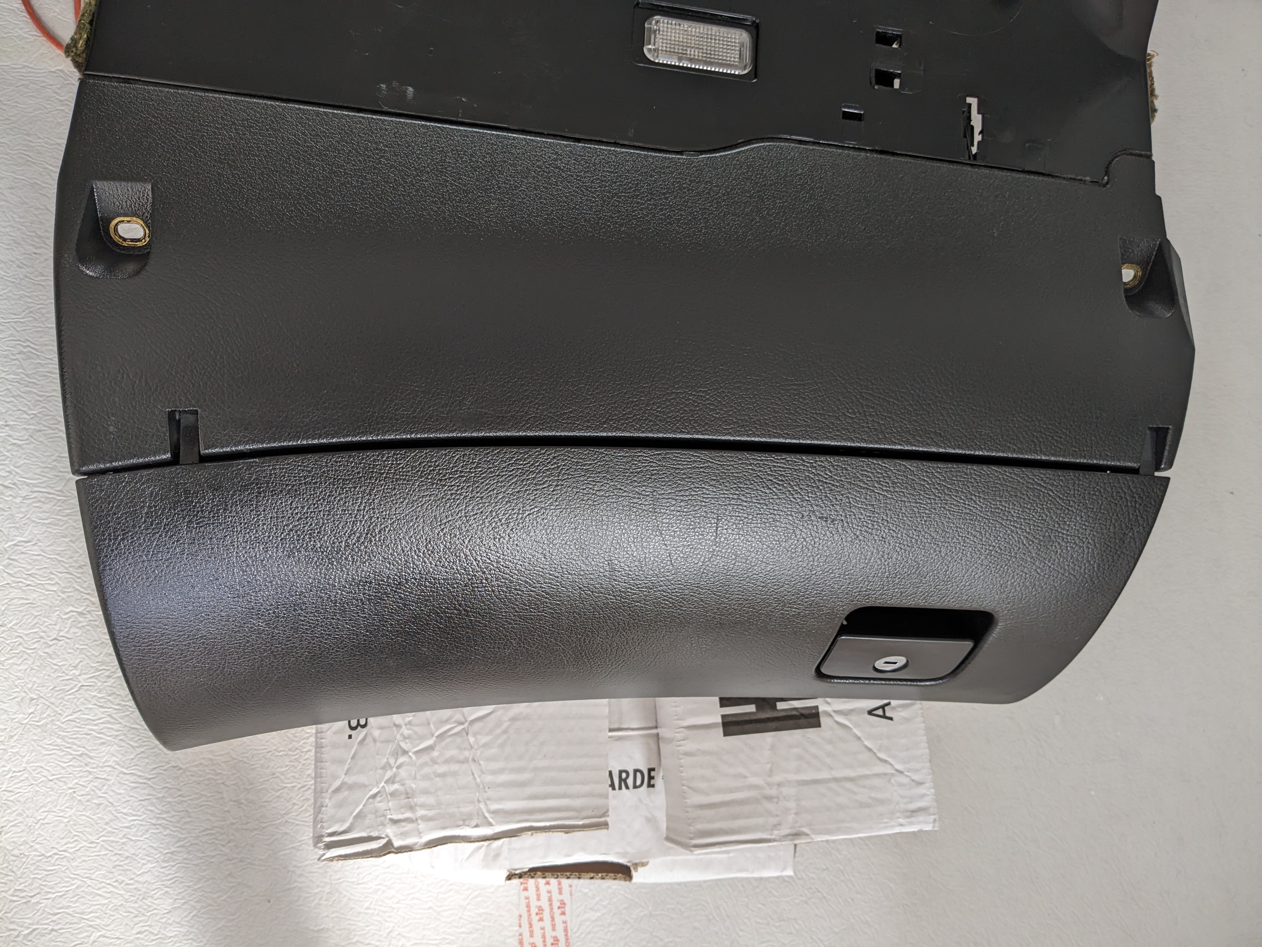

Re: dashboard scuff repair... heatgun+CarPro Perl (waterbased silicon oxide)
i don't I could get enough heat with the hairdryer. i think some of the very light scuffs faded. the plastic didn't get that hot.
i think a lot of the change came from a good clean and the carpro perl silicone oxide treatment. not convinced it'll touch the scuff at the instrument cluster.
Yeah, you'd need a paint stripper, but you'd have to be really careful. I can see why it might work. Small scratches are probably quite "hairy" up close which reflects the light. The heat gun would make them shrivel and make them less visible.
The cleaning product has a similar effect, making them less reflective, albeit temporarily.
