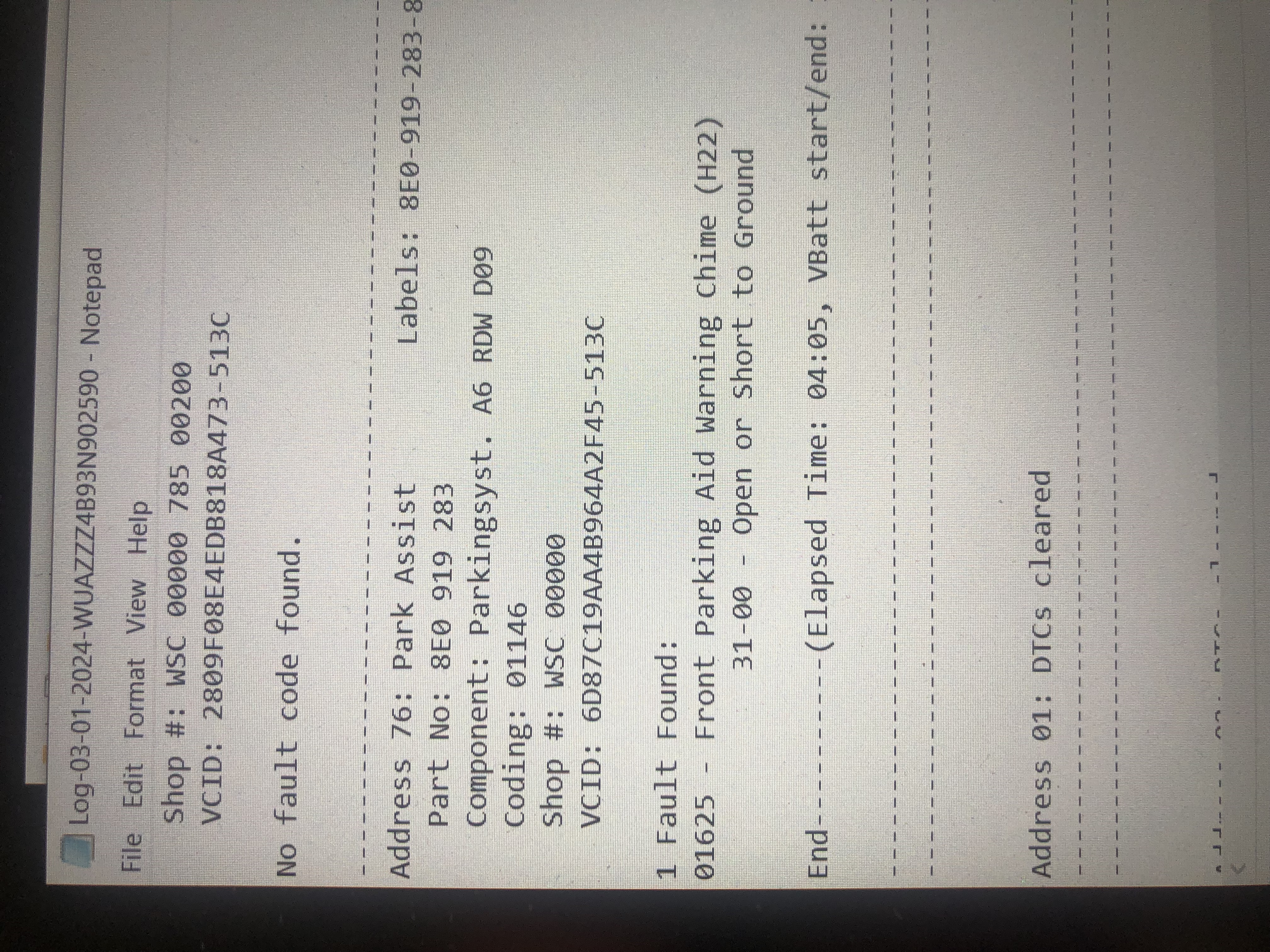

Might be the front buzzer I need (8E0919279) and not a sensor as originally thought.
Or a control unit 8E0919283.
Update. Sensors all tested ok. Front buzzer and control unit installed. Parking assist now working as it should.
