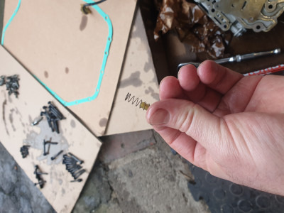

Just on with servicing the gearbox an I think this plastic bit and spring has come out from the valve body.
Anyone know where it goes before I put it back together.

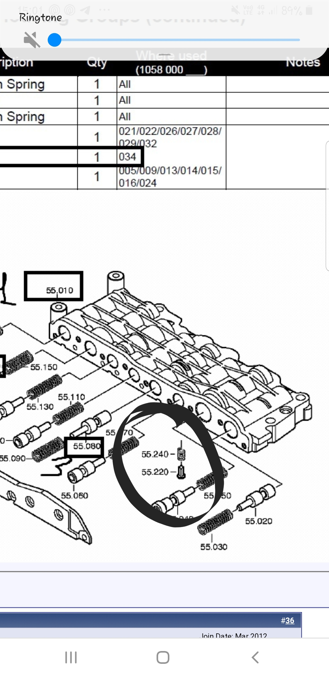

Have a look through the repair manual to see if you can spot it:
https://procarmanuals.com/pdf-online-zf ... ir-manual/
Is it part number 748 here?

This is the part. Need to see where it goes now.

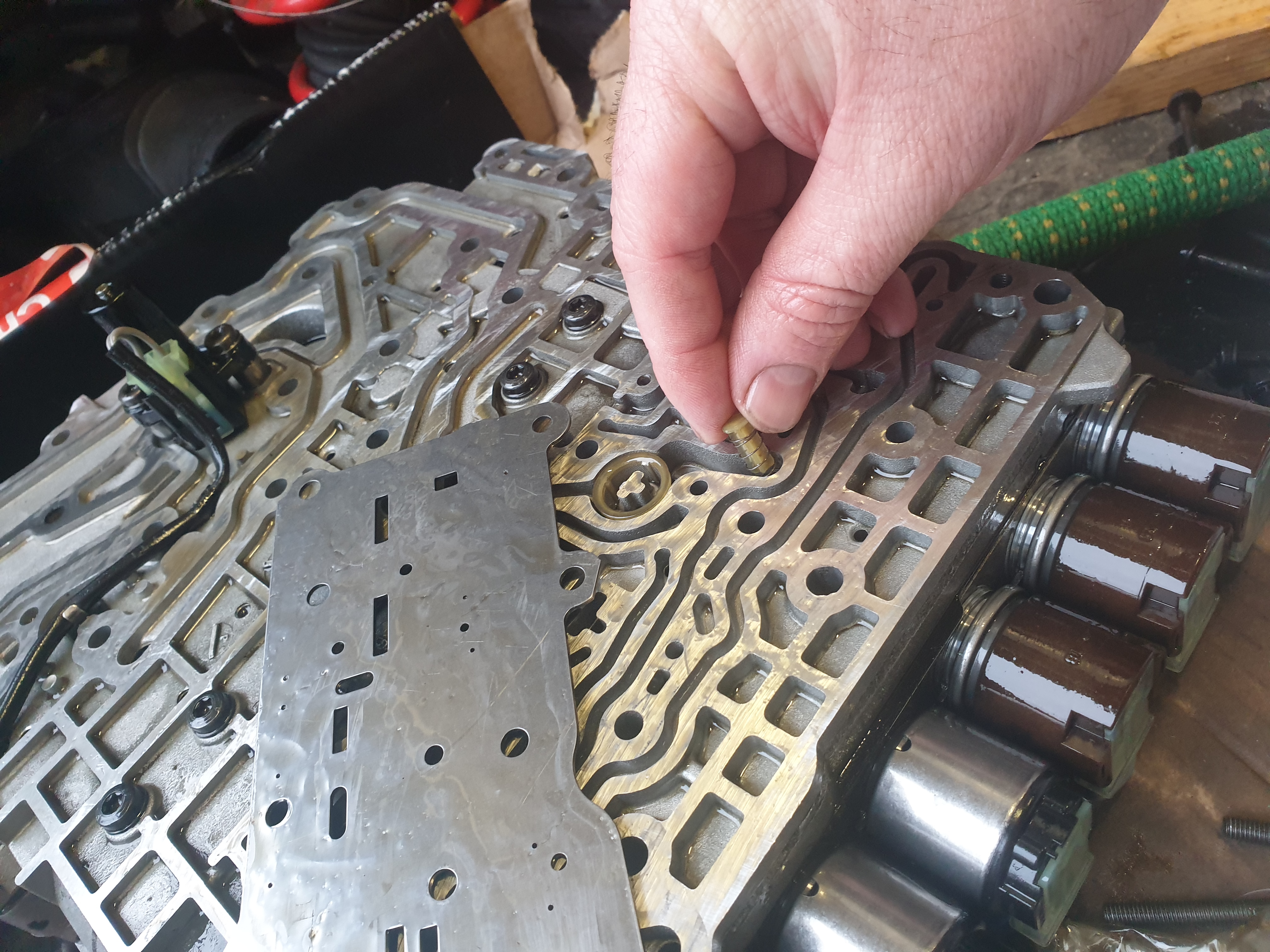

Think it maybe here

Found where it went so all back together. New filter, harness and a clean out.
Still getting 18223 and 18243 fault codes but only if u lewve ignition on a second if u turn key and start straight away there is no fault codes.
Going to the f125 switch next.
