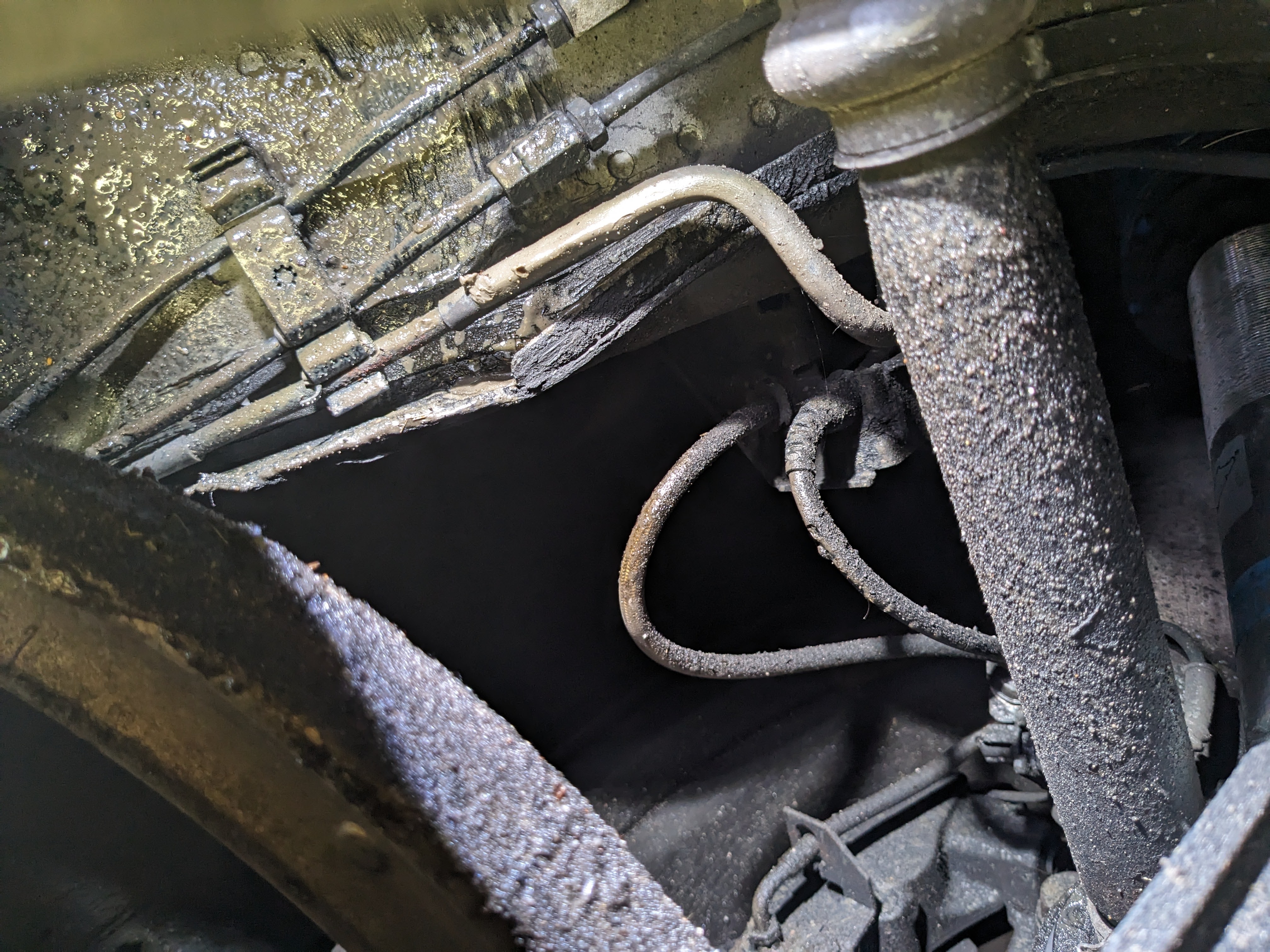

i made it to basel.
in the end so did the 6.
i had to get it valued for the insurance before i left (eur37k). when it was on the lift i noticed what looked like oil around the front left wheel arch. upon inspection the interior boot of the driveshaft had a tear in it and i was looking at grease which had heated up and dispersed everywhere.
i found a new local audi garage, the mechanic said i was good to do the 680km journey so i set off the next day.
i now get a creaking noise from that area when i tune the wheel at low speeds, i guess it's all the time but i can't hear it.
is this something i should be worried about?
stop driving?
about 1.5hr work?
anyone know of a performance audi who might know/want to deal with these cars in southern germany? (switzerland is too expensive for me)

You definitely want to get it fixed. I don't think the creaking is related - possibly just coincidence.
You could just get a new drive shaft and fit it yourself.

I think he's talking about the inner CV joint boot.

Re: driveshaft boot tear - stop to drive? southern germany garage?
the issue is the rubber boot on one end of this shaft.
you can see the grease everywhere in the image.
apologies for my lack of knowledge.
I assume i'll also need someone to redo the tracking?
The top right? That's the inner CV joint boot.
You don't need to mess with the track rod ends to get the drive shaft off so you won't need to do the tracking unless you remove something you shouldn't.
You could something like this to *temporarily* fix the boot to be able to drive it to a garage a reasonable distance away (check fitting first obvs):
