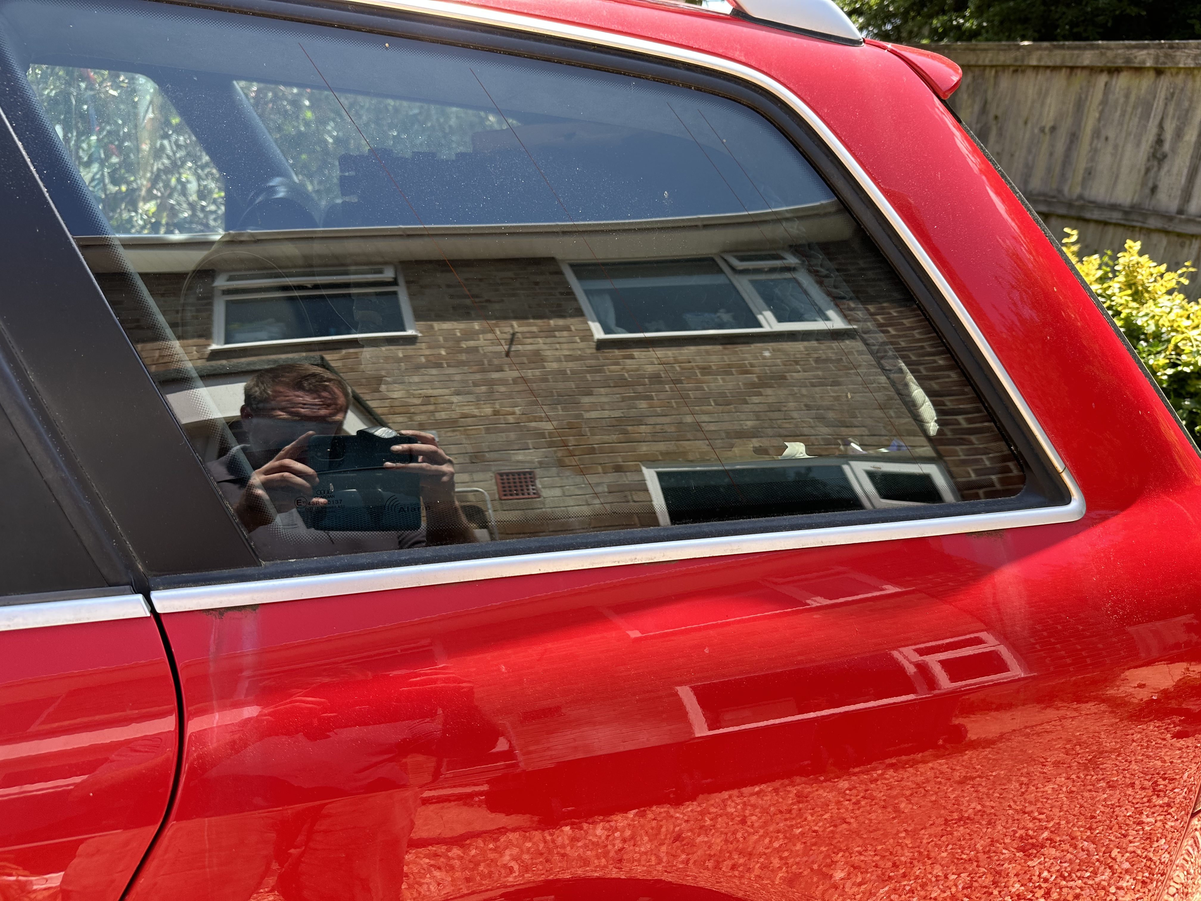

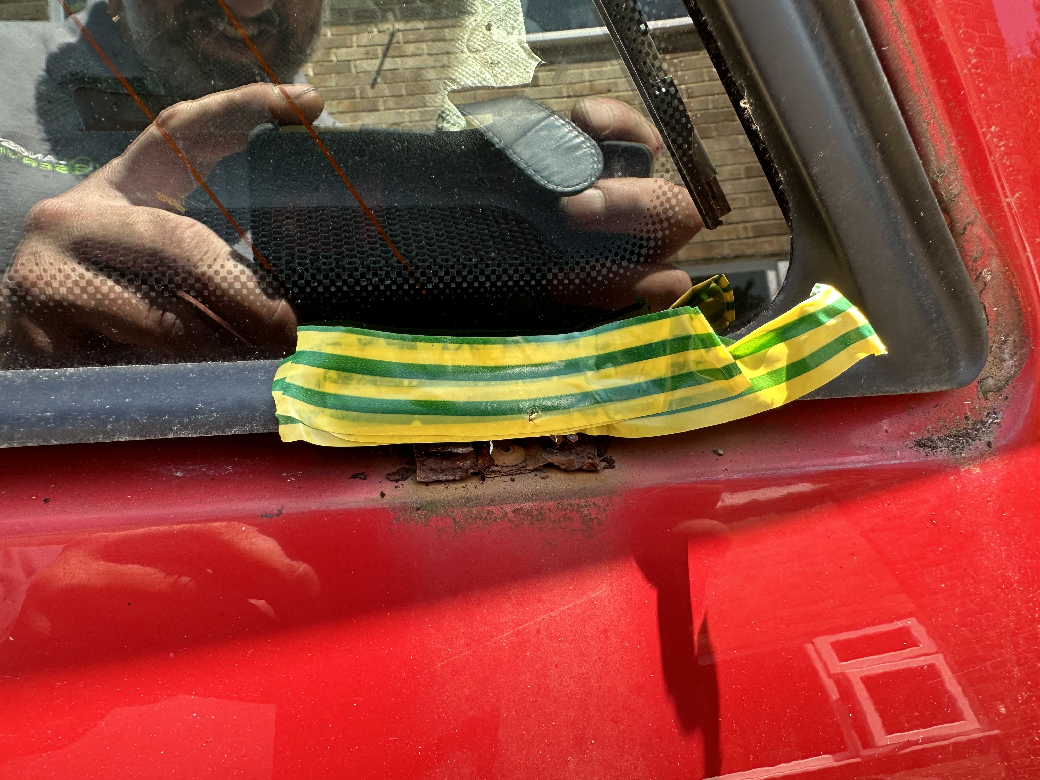

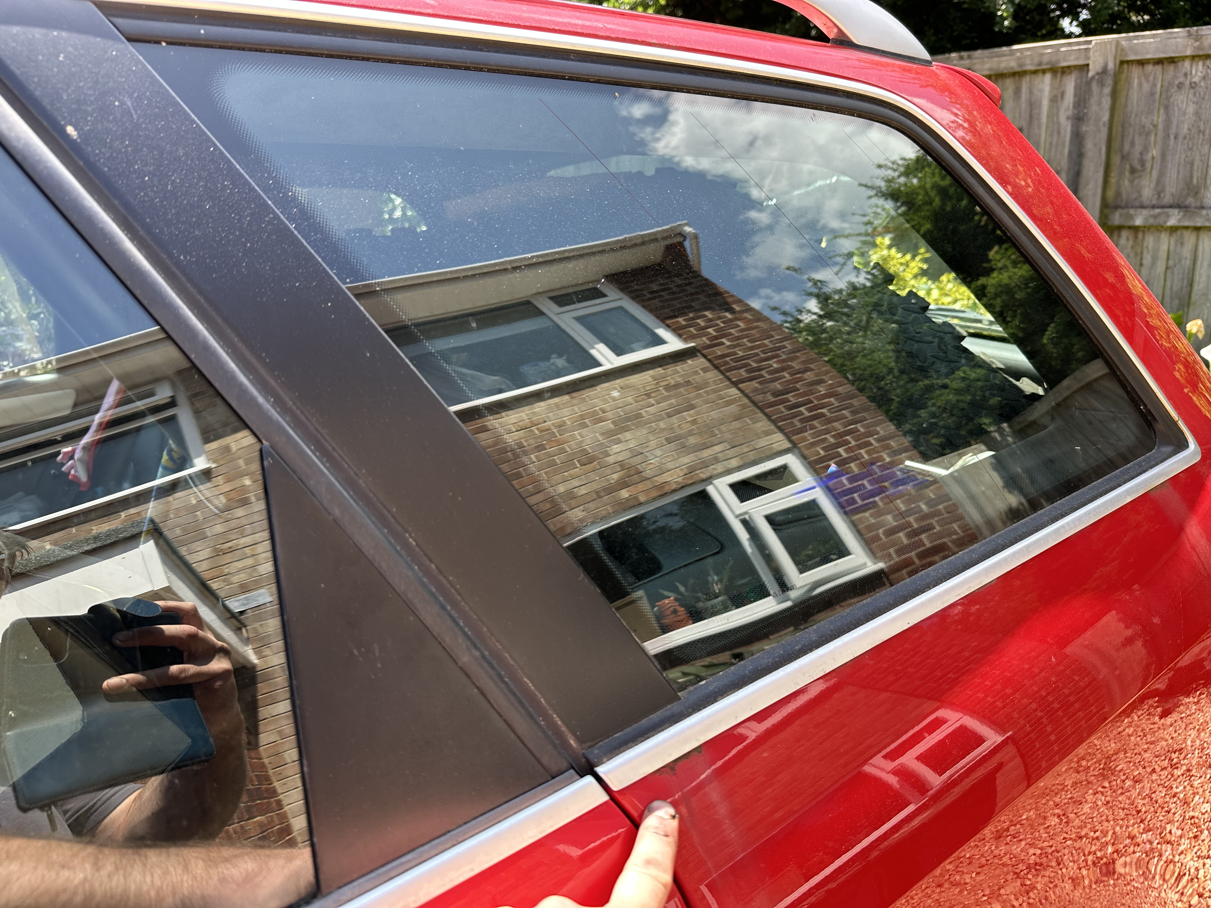

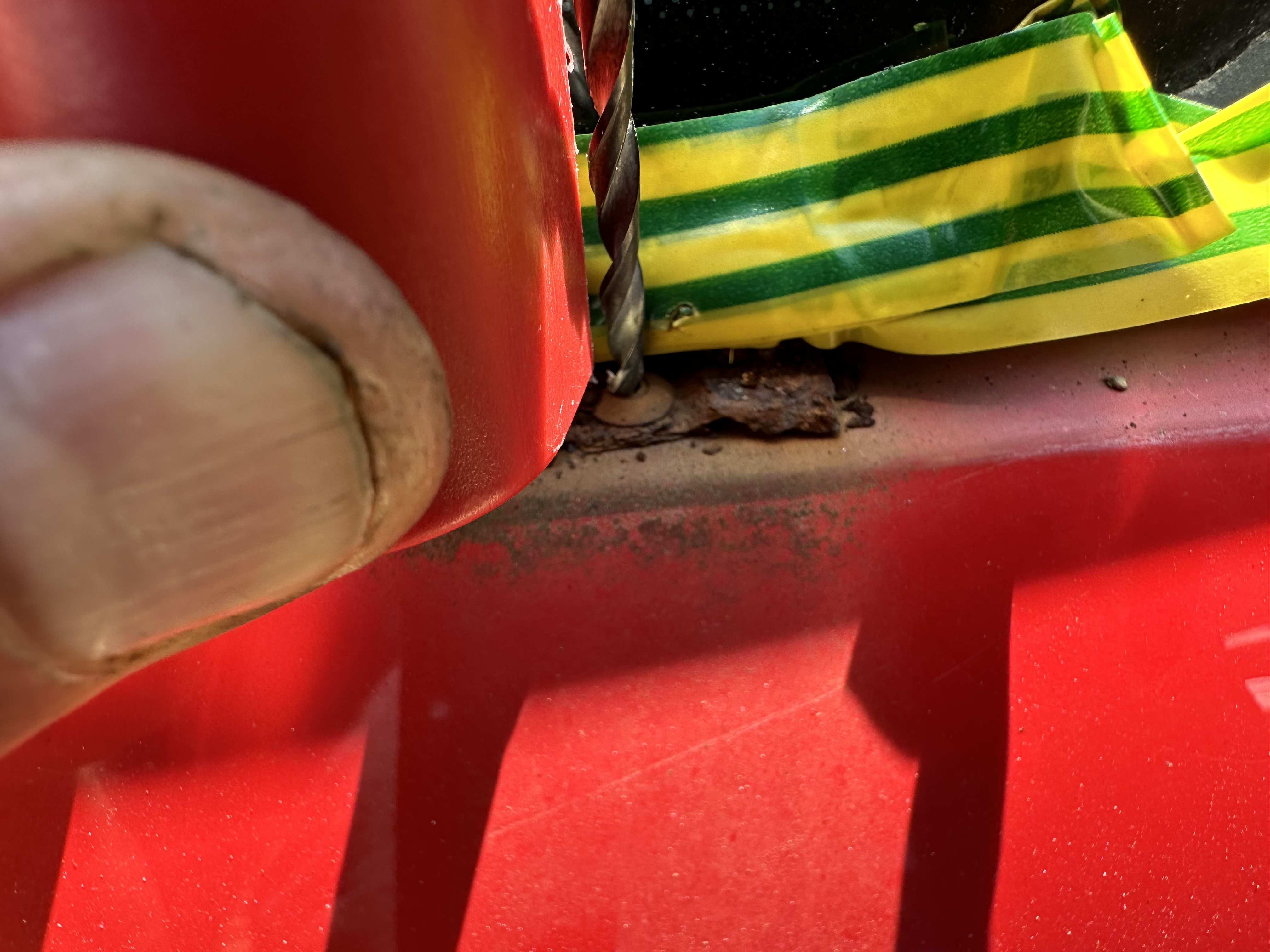

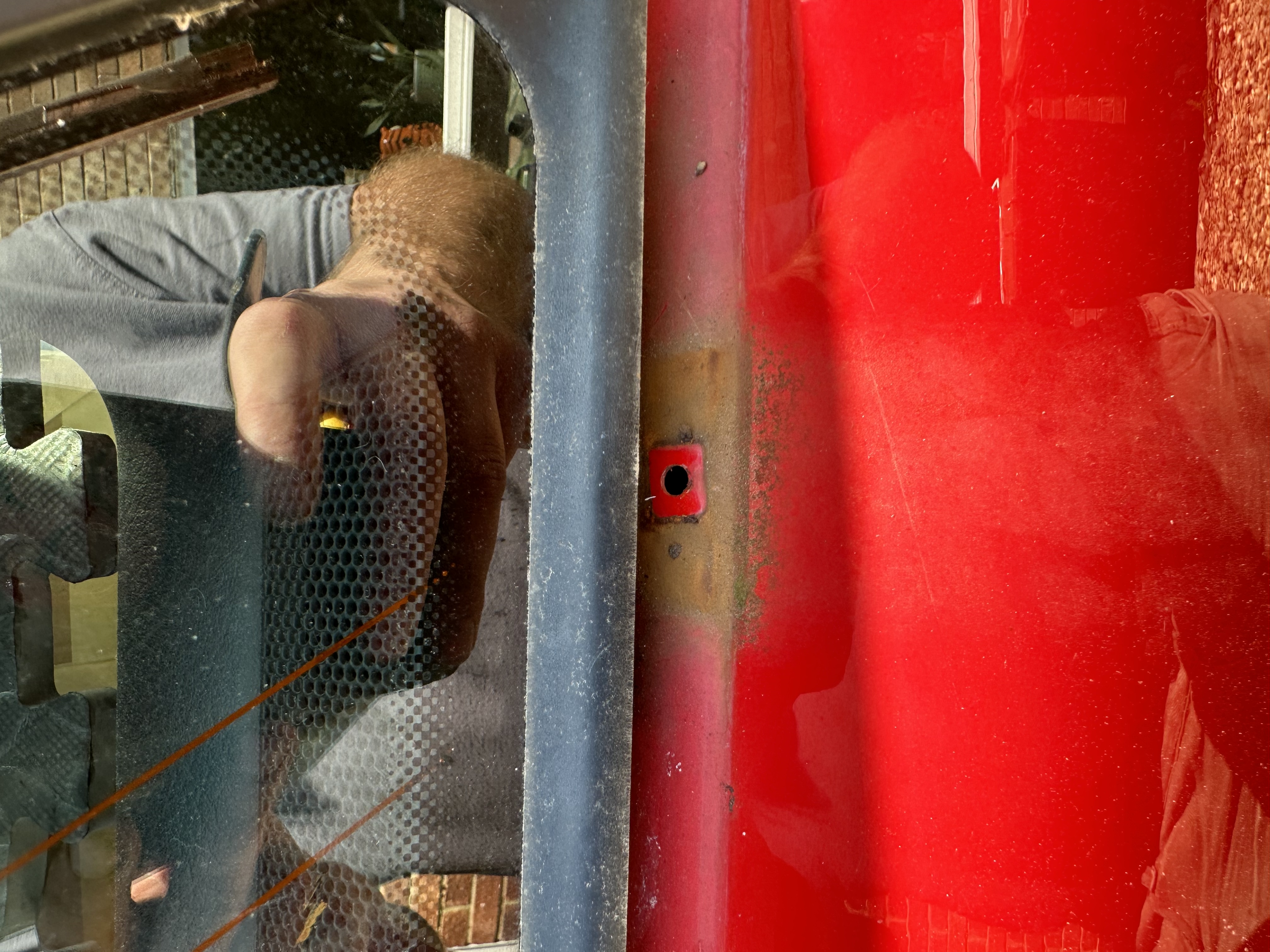

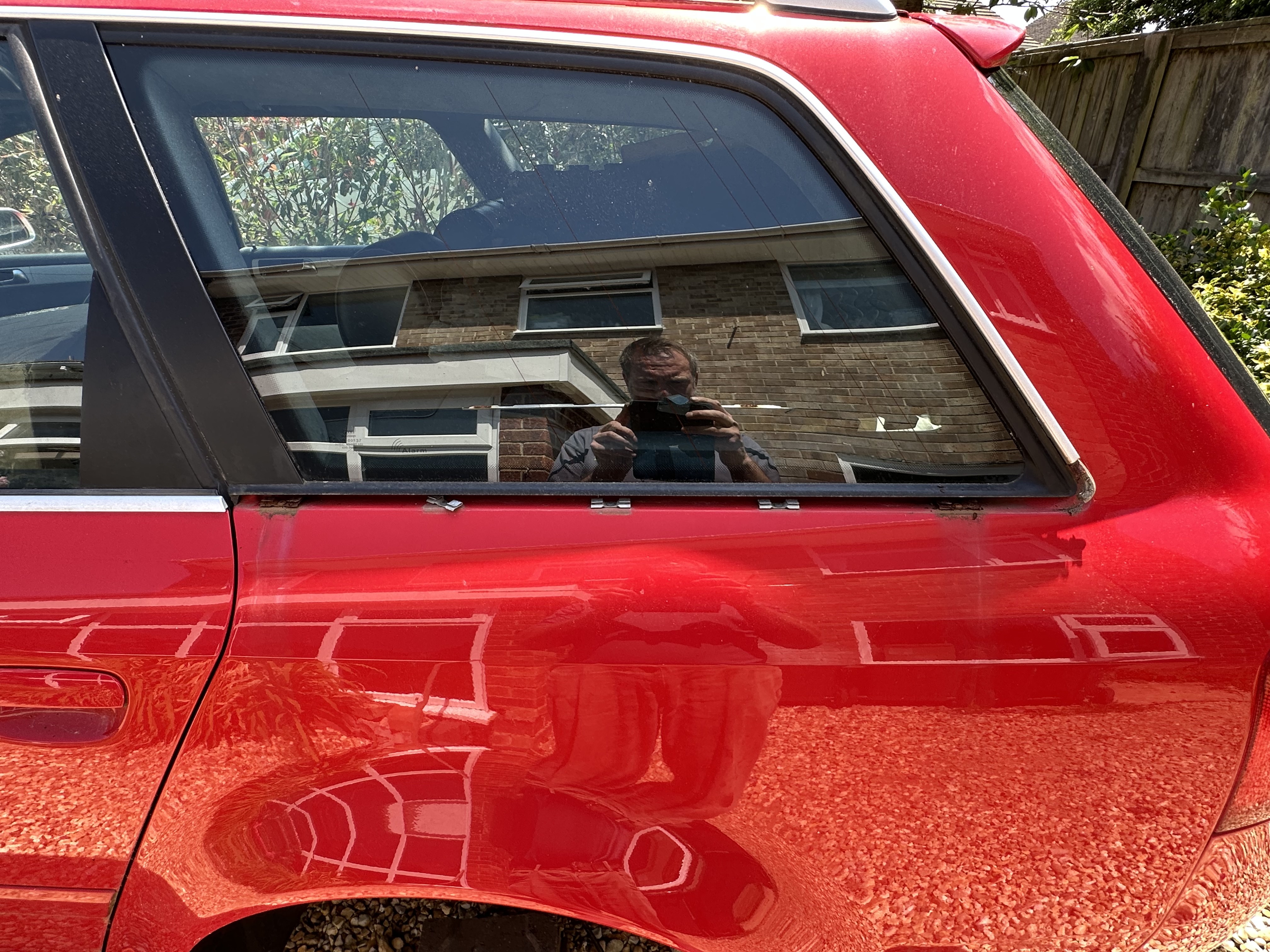

Post by ChrisA » Wed Jun 21, 2023 3:16 pm
This is a satisfying little job that’s been bugging me since I brought the car, replacing the rear quarter lower ally window trim clips. No more rusty water marks. 😎

Ahhh! Very interesting, I have to admit I have the rusty water marks on mine & was fearing the worst thinking it was full on blisters on the paint work under the trim

Post by ChrisA » Wed Jun 21, 2023 3:29 pm

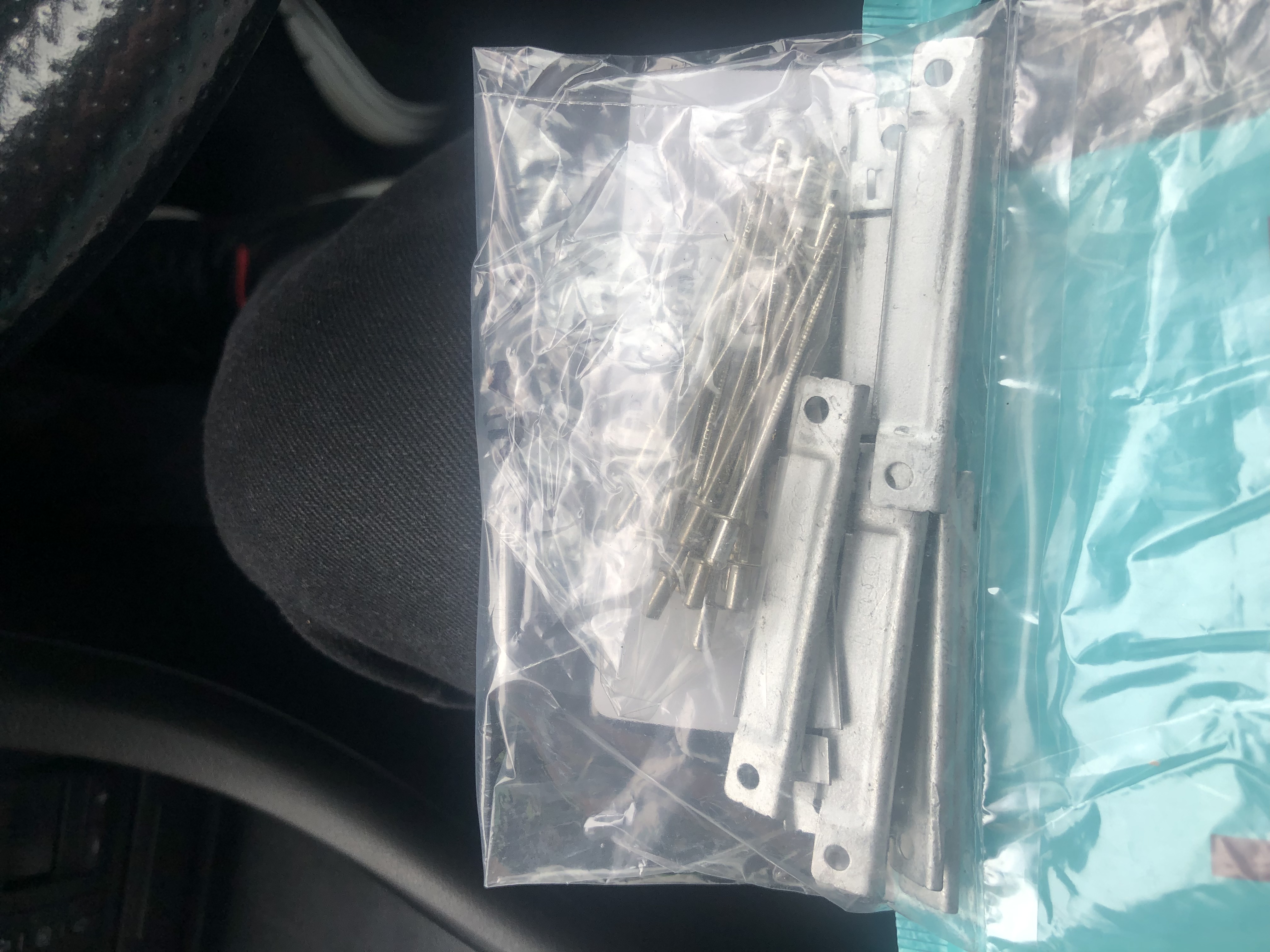

Piece of cake to get the trim off once you know how. The only issue is that it looks like the clips are NLA now. Thankfully I’ve just brought a load. 😉

So your rear quarter lower trim retaining clip is different to the Avant (Loon is 4B5853929 and the Avant is 4B9853929A)

I need 4 of these, just rang TPS and NLA :( Anybody know of any available anywhere please?

The ones for the window side trim that Chris has replaced (4B9853929A)
