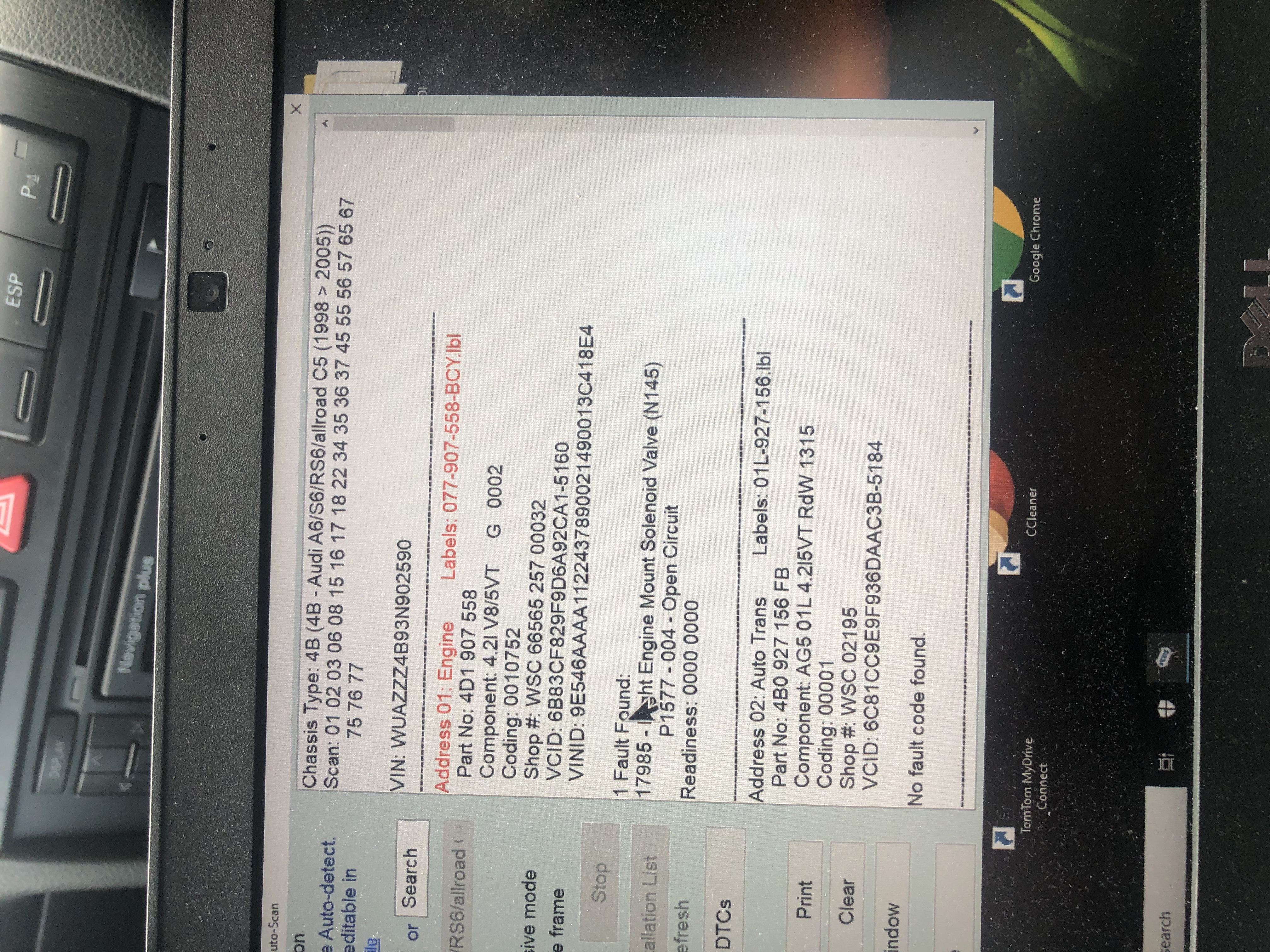

I ran a auto scan this morning as a matter of course and noticed a N145 solenoid error.
Hopefully get this sorted at the same time.

Are you sure it wasn't just unplugged and not plugged back in last time it was worked on?

Thanks Ben. Will see if it was disconnected.

Right engine mount solenoid error. Unplugged contacts cleaned. Seems to have solved the problem.

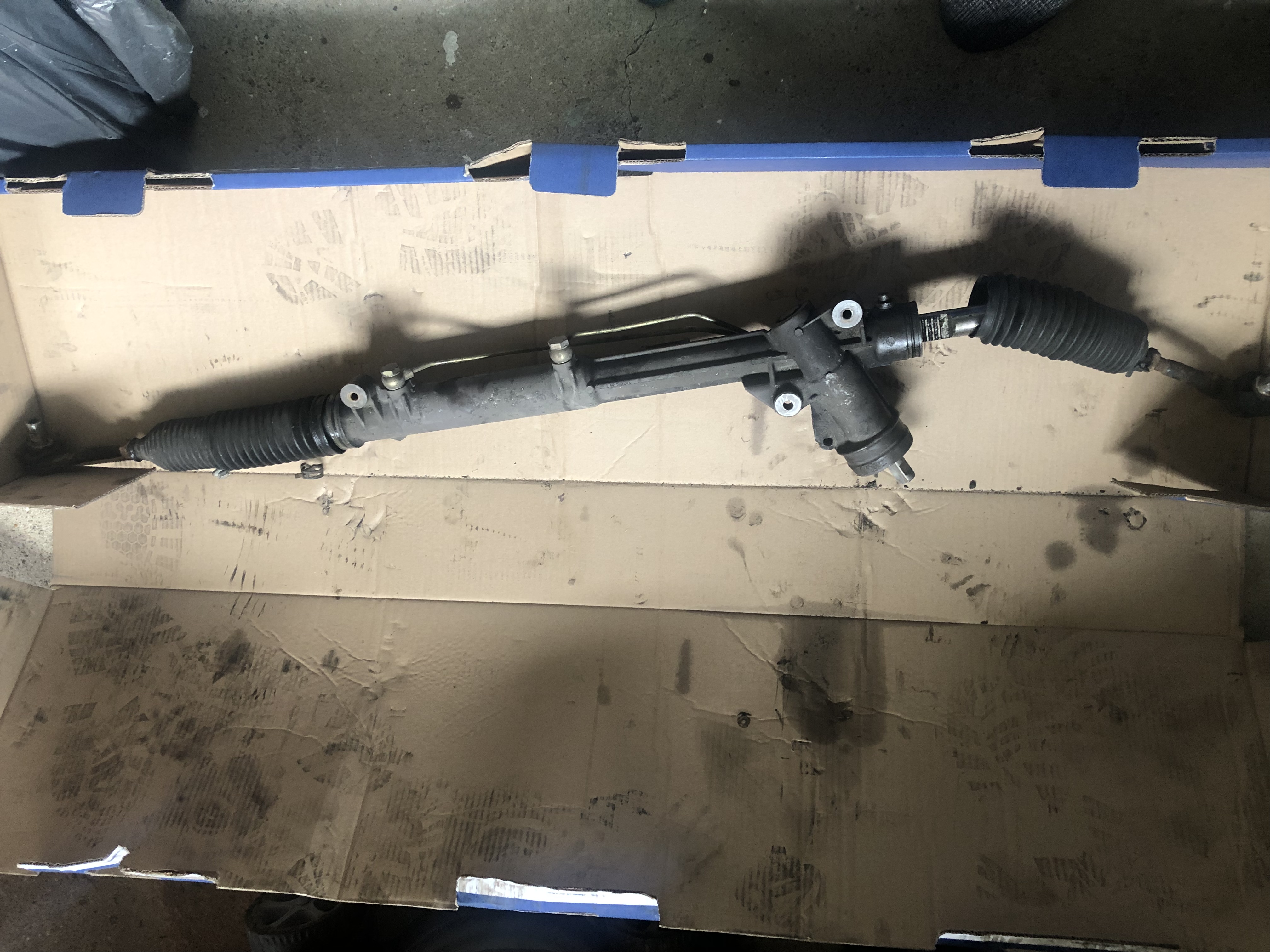

Matt are you still interested in buying my original rack.

Re: Steering rack
I was chatting to Chris A the other day and he'd quite like it I think - so he can have first dibs on it, if OK with you?steve2003rs6 wrote: ↑Wed Apr 05, 2023 12:11 pmMatt are you still interested in buying my original rack.
- Posts: 2956
Re: Steering rack
£250 plus freight.
The full refurbishment of the rack cost around £260.00.
The track rods were another£138.40
Gaskets/ seals were £24.97
And power steering fluid was £14.27

Yes Matt they did mine. Must admit it looks brand new and straight from the factory. And has 12 month warranty.
Re my old one. I will have it overhauled for the price they charge. Definitely ain’t going in a skip it’s far too good.
Only fault it had was a very very slight oil leak.

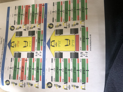

Pleased I did as it was miles out.
