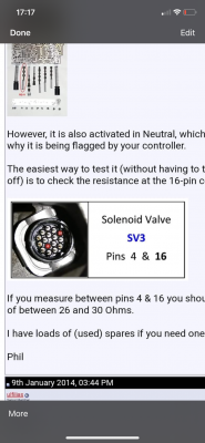

-checking the reading between pin 4 and 16 on the harness at the front of the trans (reading fine) and cleaning that connection

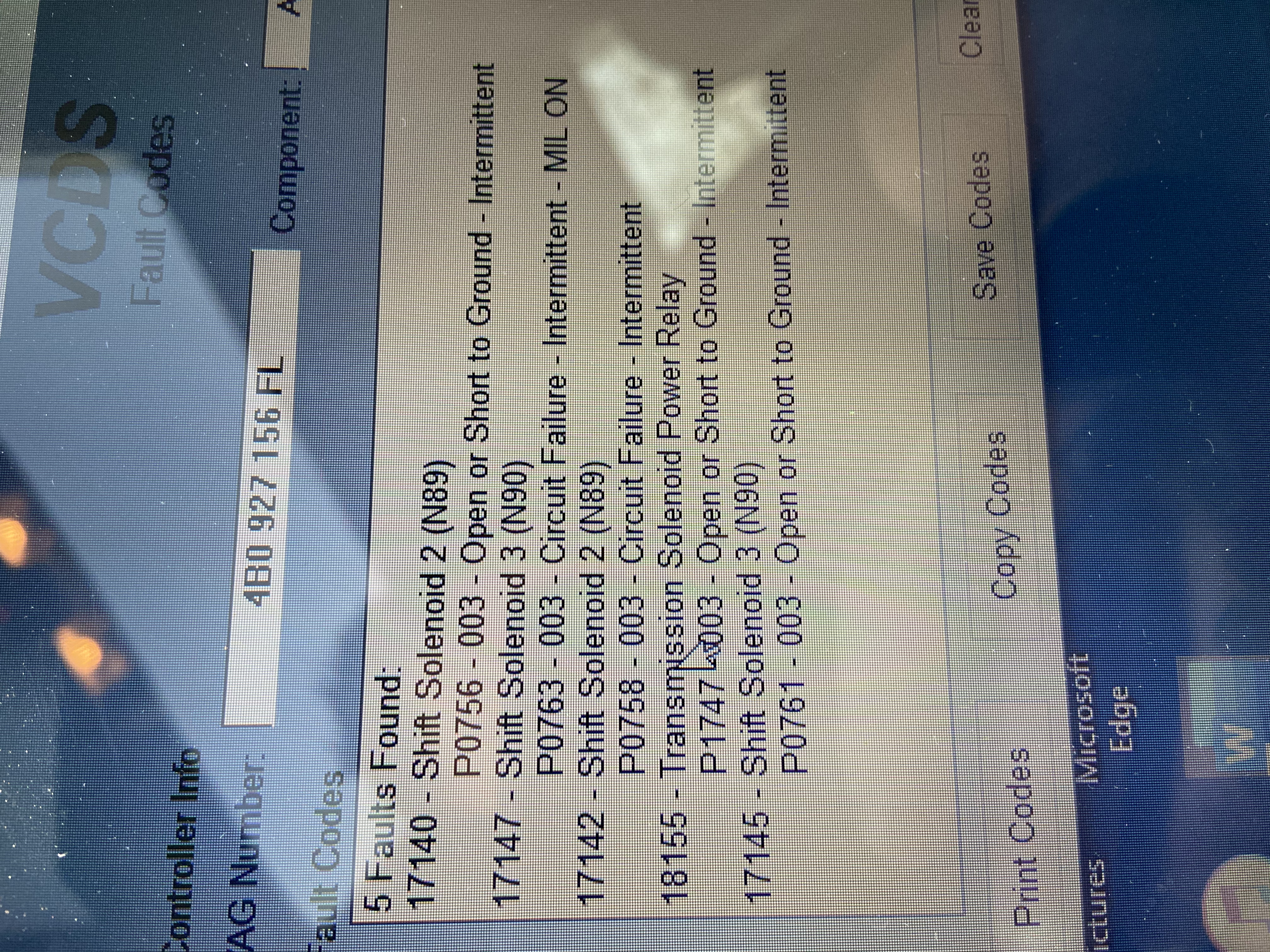

Post by Hixrs6 » Fri Nov 06, 2020 9:11 pm
Shoppinit wrote:
Sat Oct 31, 2020 5:08 pm
Maybe the solenoid is dead and it had burned out the input on the TCU. Then when you moved it, it burned out the other input, too.
If your carpet is wet, though, I'd definitely want to fix that first and I'd suspect a damaged TCU.
Could also be a harness issue inside the gearbox. Maybe there's a short occasionally.
You could log the TCU currents while driving to see if anything funny happens.
I have my buddies Vagcom, do you know off the top of your head how I can log TCU currents on it?
Thank you! Also here is my new fault code list. I’m starting to believe what you said about the input burning out because at first it was just solenoid 3 (N90) and then I moved it to solenoid 2 (89) to see what happens and that one is throwing a code now too.
