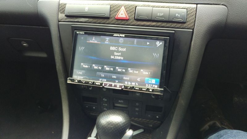

I recently purchased a 2002 RS6 Avant. Nice big solid car with a couple of niggly problems that i am slowly working my way through. One of the main problem was the GPS location on the RNS-d, checked the connection and tried another antenna but to no avail. Only option left was to ditch the RNS-d and look at alternatives, after some research i opted for the Alpine INE W987D and proceeded to crack on with fitting the kit. First up the supplied plug and play lead was faulty, replacement made the speakers pop really bad when ever the ignition was switched on or off then i found out the supplied lead was of the wrong type. The one i needed apparently used the speaker output of the HU and not the RCA output as i was told to use.
Now the unit is fitted and operational without any popping, the problem i now have is battery drain. The car will last about 2 - 3 days and then nothing. When i sit in the car with the key out the ignition i can hear static very slightly. Put the key in the ignition, the HU screen comes on and everything does and sounds as it should. When i take the key out the HU screen goes off but i can still hear some coming from the speaker very slightly.
