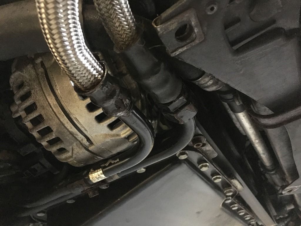

Audi have got me the part number M V4B3 317 816 C for N/Stock Line at a price of £190
Anyway, anyone know the best place to get this part?

Thanks I think its the bottom oneShoppinit wrote:Shoppinit wrote:Depends on the VIN of the car. Looks like there was a change halfway through production.

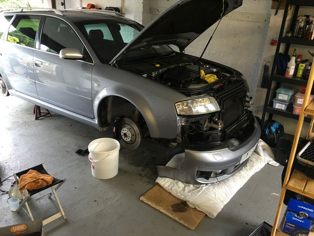

Y7TSY wrote:Currently half way through this job on mine! Same pipe that runs past the front lower grill and into the passenger side lower side of the cooler, was going to just take mine off and drop it into a hydraulic hose specialist and get one made up, but don't really fancy the flexi hose in sight through the grill but will let you know if I find any other alternatives.
Are you going to split the pipe at the joint seen in the picture or is the pipe from Audi the full line up to the filter?
I just took the under tray off and both front arch liners to give them a clean and check a few things and makes getting to the bolts on the inside of the front bumper a bit easier!
Interested in the hydraulic hose specialist thing, was thinking the same myself, saw it in wheeler dealer since, much better alternative. Know any?
I am getting mine done in a garage, have no time to do myself.
