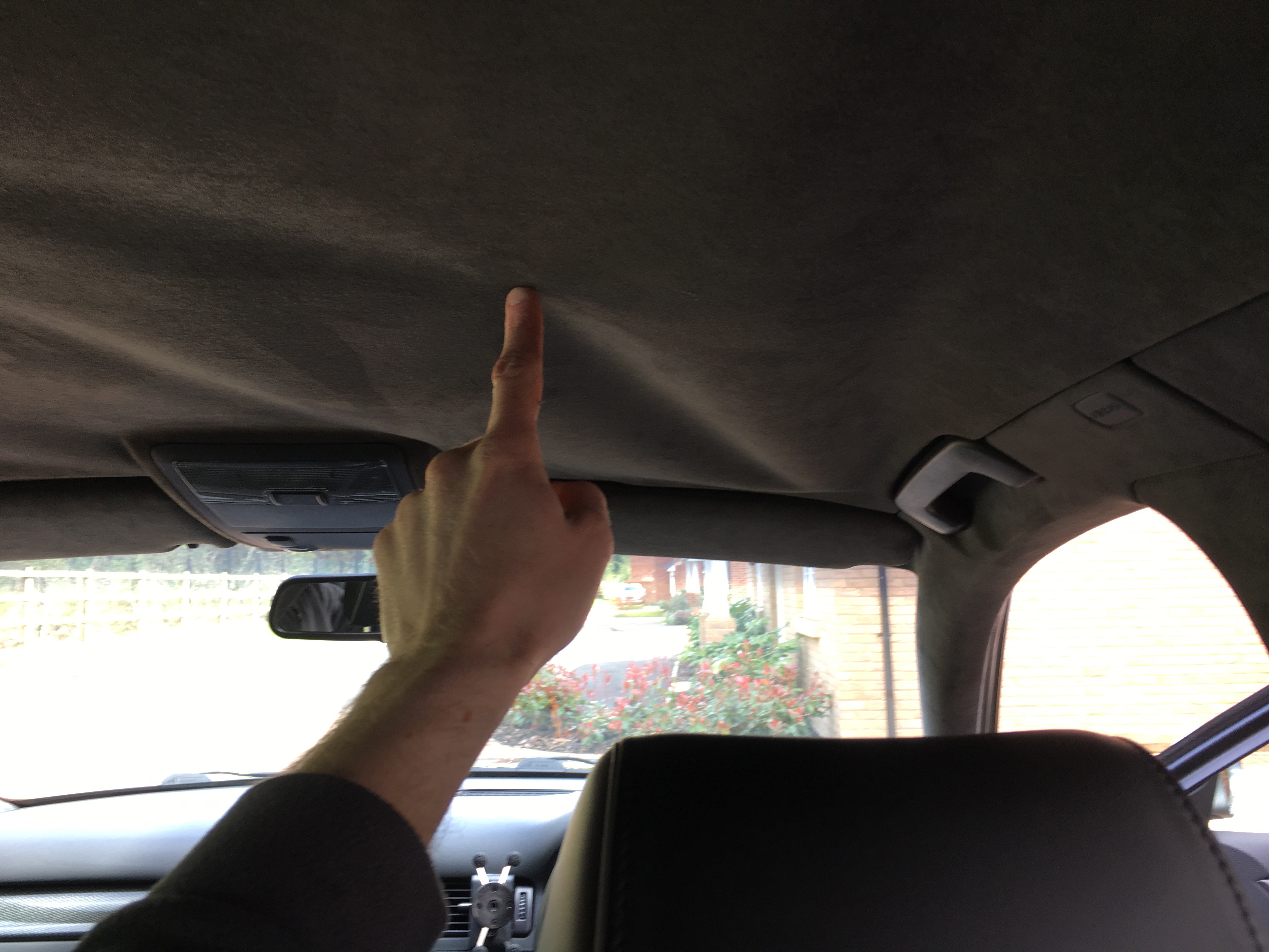

OK from the area above the drive a couple of weeks ago it is now much worse, so I had a go today.
Steam did not work, I tried an iron and that did not work. So without much left to loose I used some contact adhesive, gained access through the vanity mirror light (the other fixings have metal surrounds) not ideal but good for a spray and pray. Got a good chunk of it stuck but also got too much in one area and it came through. So OK as a tidy but need to take the headliner out of the car, remove it all and restock knowing how much adhesive is in each area to do it properly.
I have attached a couple of photos of the before.

exactly where mine has dropped also, thanks for the feedback as these were options i was going to try. headliners coming out then by the look of it

I wonder if the steam doesn't work because it's alcantara and you can't get enough heat transfer through to the glue underneath.
I wonder if it's worth trying with a hot roller. Or a butchered hair straightener or something.

Tried steam on the other car (Jag) and it didn't work. Apparently with the Jag, the foam substrate rots with excess humidity (of which there is generally lots in the sieve Jag) - it's not the glue that comes unstuck.
At least for the Jag I can get a "new" one for £130. I suspect that for the RS6 it's going to be more like 2k.
I think for the RS6 it's going to involve removing the headliner and resticking it with a high temperature spray contact adhesive. At least the Alcantara is robust and the glue won't show through it.
