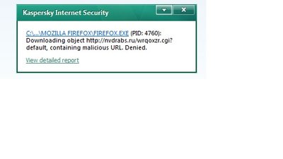

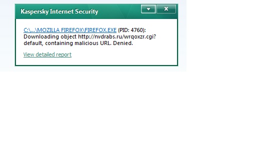

Post by ahoooga » Tue Apr 29, 2014 10:33 pm
I got the following from that link :bigblink:

Post by saulcupra » Tue Apr 29, 2014 11:11 pm
edited above post to remove the link
