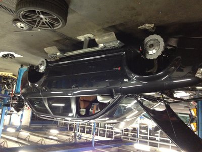

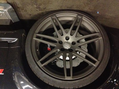

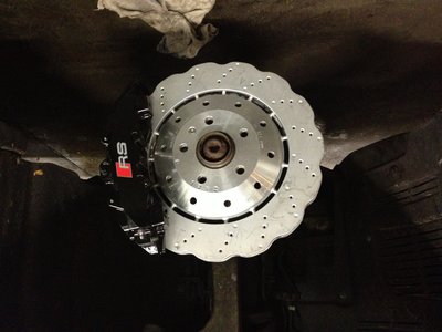

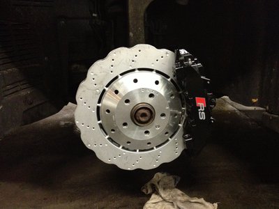

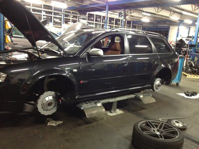

I got myself some new brakes.

According to Audi improved airflow and coolingmavada wrote:...whats the purpose of the shape?

Mounted behind the large wheels are internally vented wave disc brakes with high gloss black-painted callipers. The front callipers with their eight pistons and prominent RS logos measure 365 millimetres in diameter. The steel friction rings with their wave-like outer contour are perforated and connected to the aluminium brake caps via pins. This concept reduces tensions, quickly dissipates heat and prevents transmission of temperature peaks. The new shape of the friction rings shaves a total of roughly three kilograms off the unsprung weight."
Weight saving on R8 is a total of 2kg according to literature so obviously differs according to rotor diameter/radius.
As an engineer I would guess the primary design objective would be to increase the edge surface area to aid cooling and a by-product is weight saving as there are far easier ways to save weight without effecting the rotational mass and balance however it's easier for marketing men to sell weight saving!
