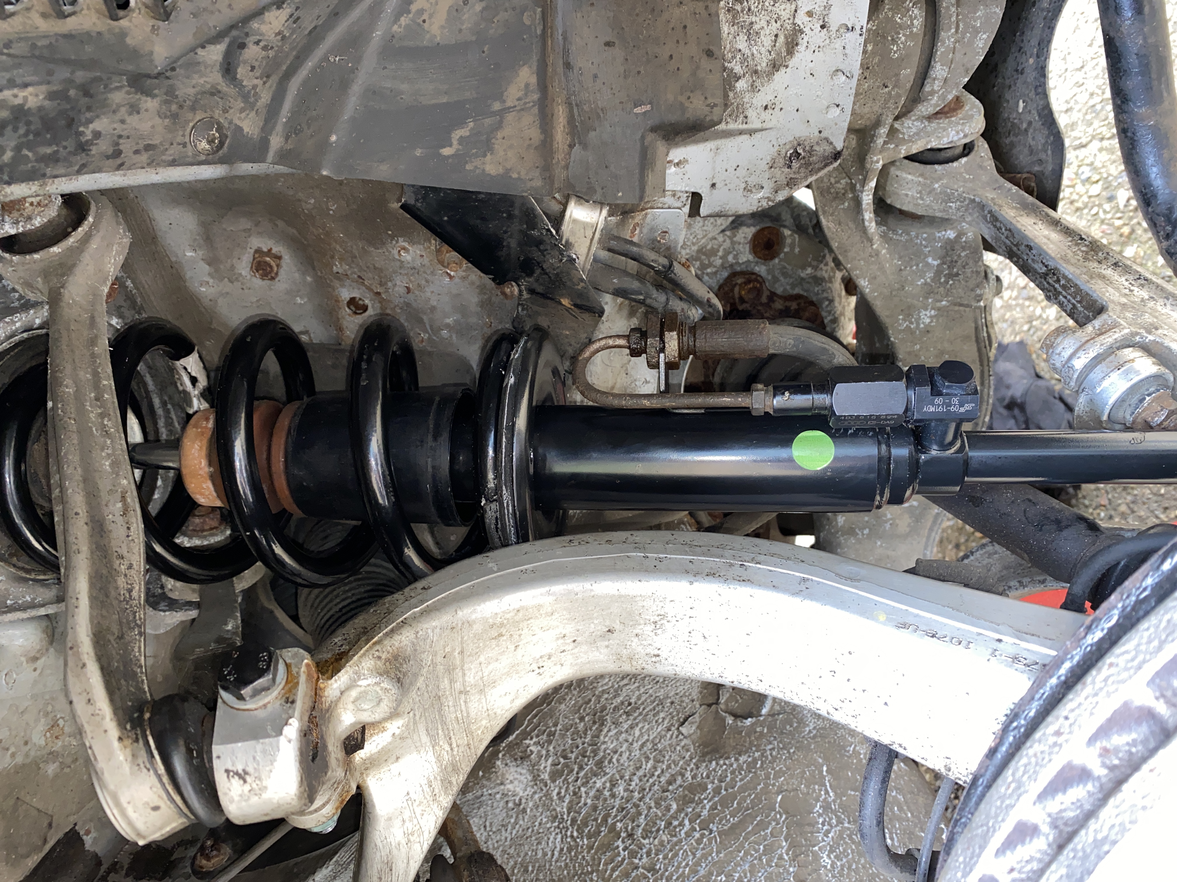

So far the cost has been pretty much in accordance to expectations. On the basis of hope for the best, but plan for the worst, I had budgetted for suspension and brakes. Thankfully my time at the weekends is free and I'm lucky with access to workshop equipment and tools.
This weekends plan is to fit the new front dampers and springs and get the car on its wheels and mobile again, and then can prepare for the cam belt, water pump and thermostat change for when the loan tools arrive.

Big box of dampers arrived today. Cambelt tools being posted to me today, so I've got a busy couple of weekends coming up.

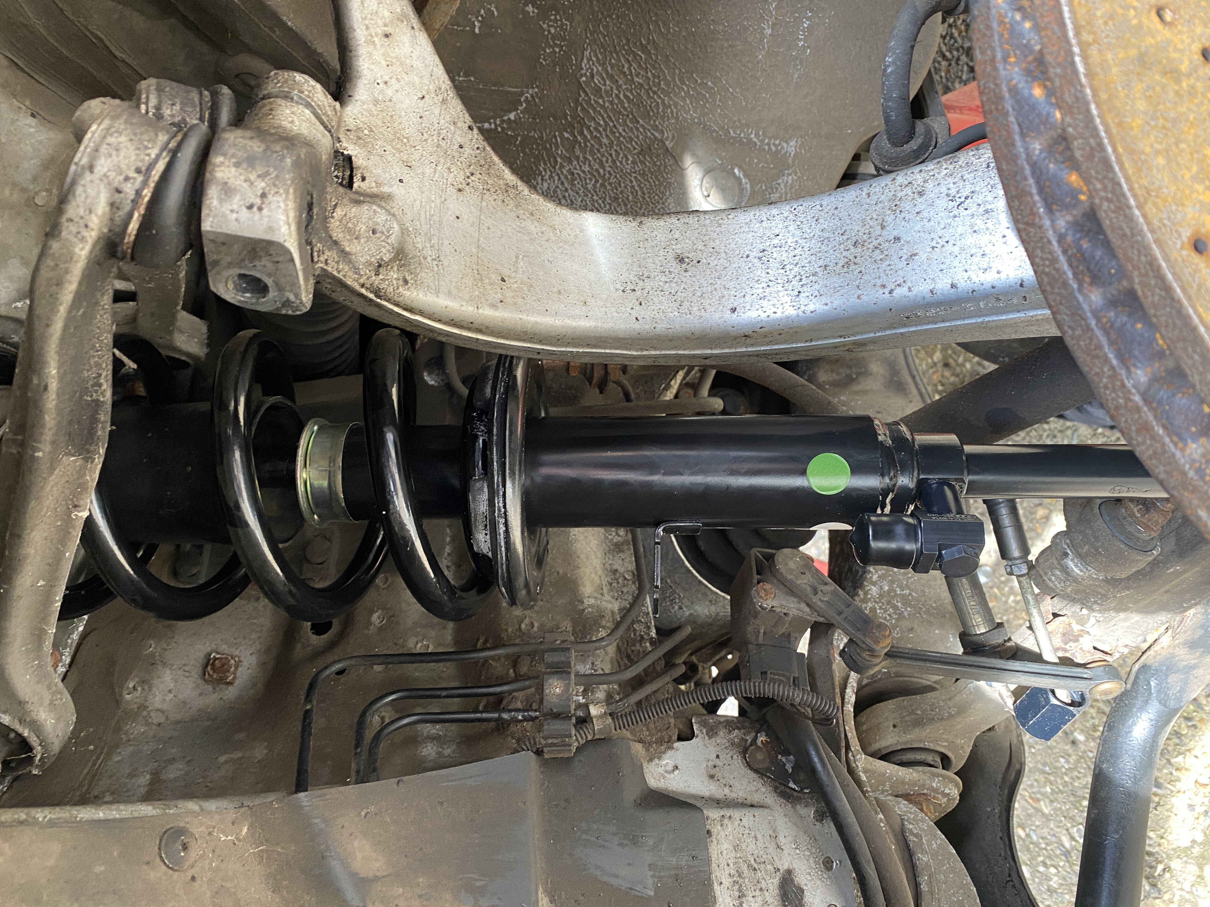

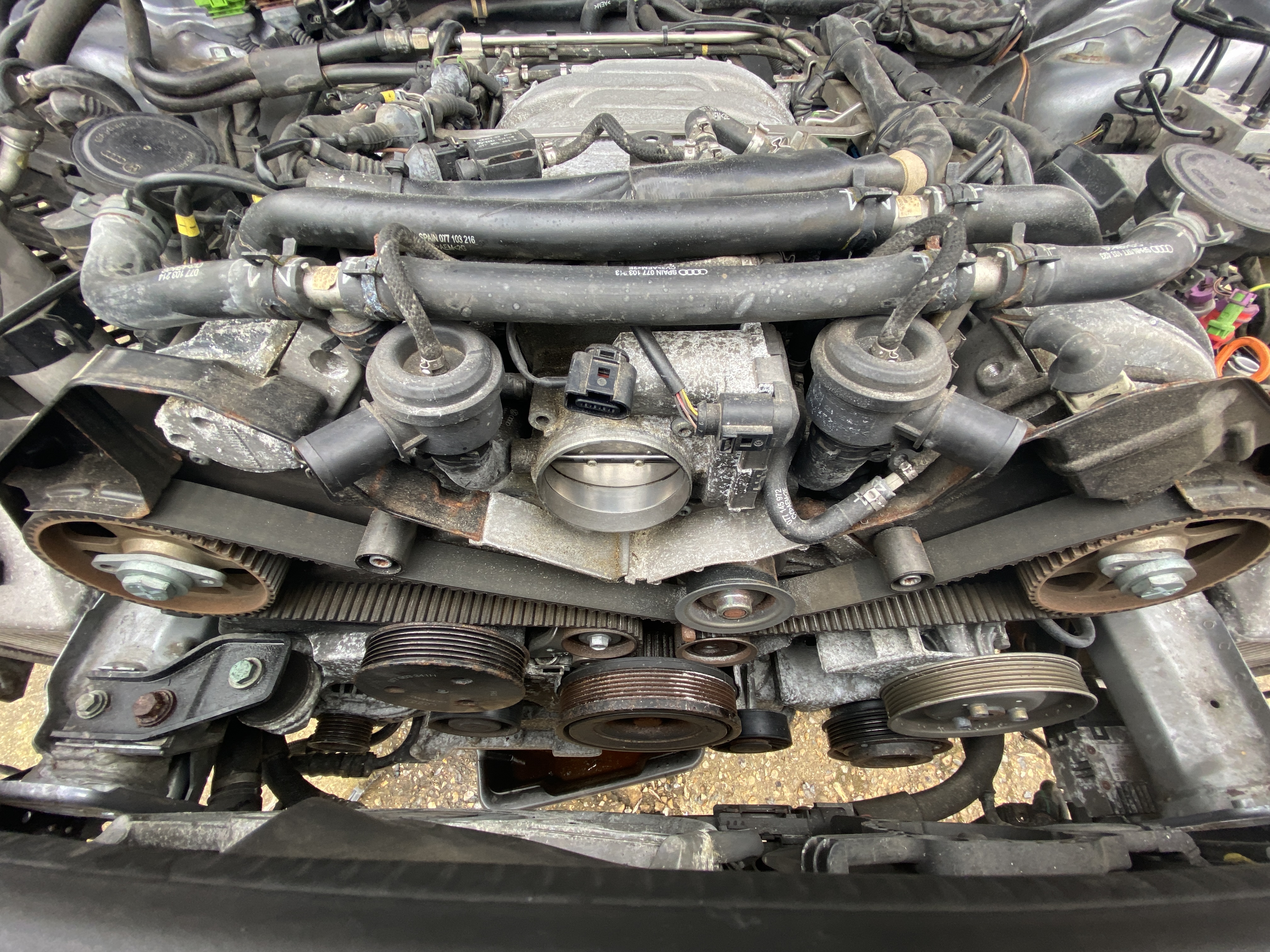

Re: New owner of 2003 RS6 C5 Saloon

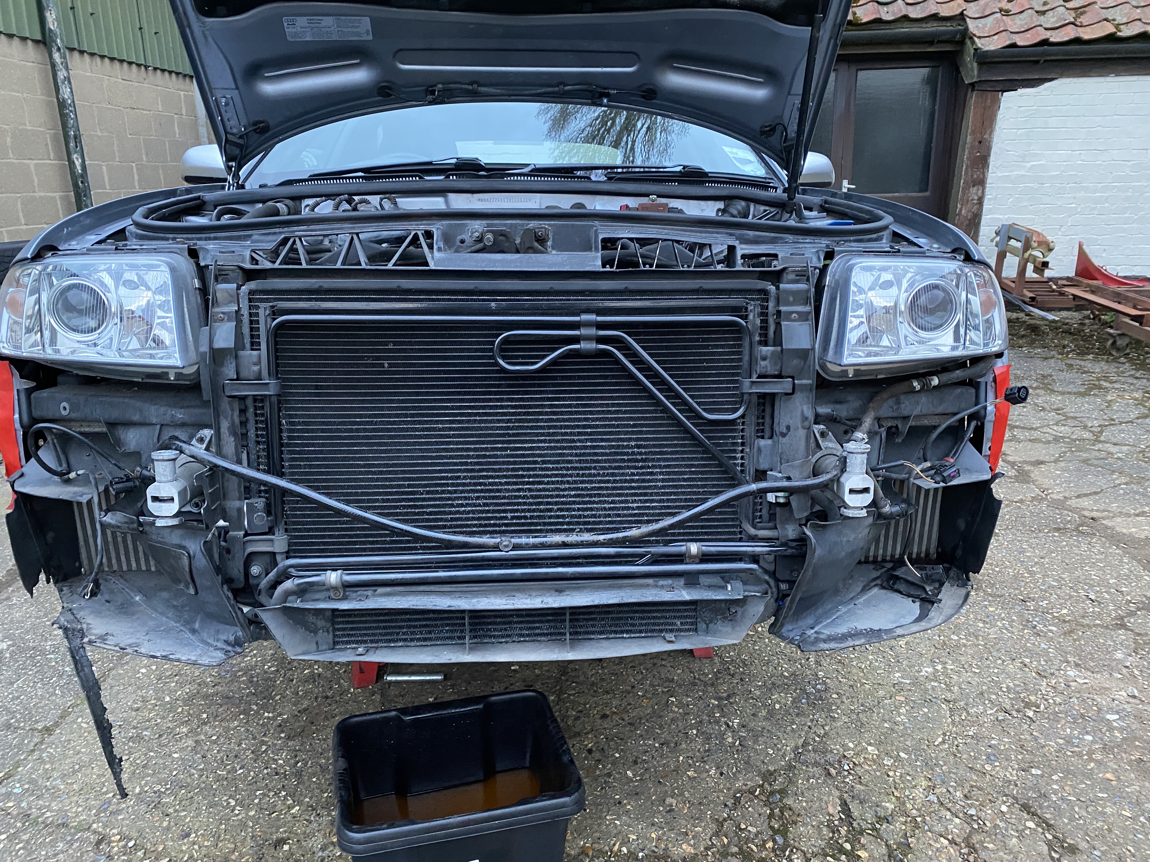

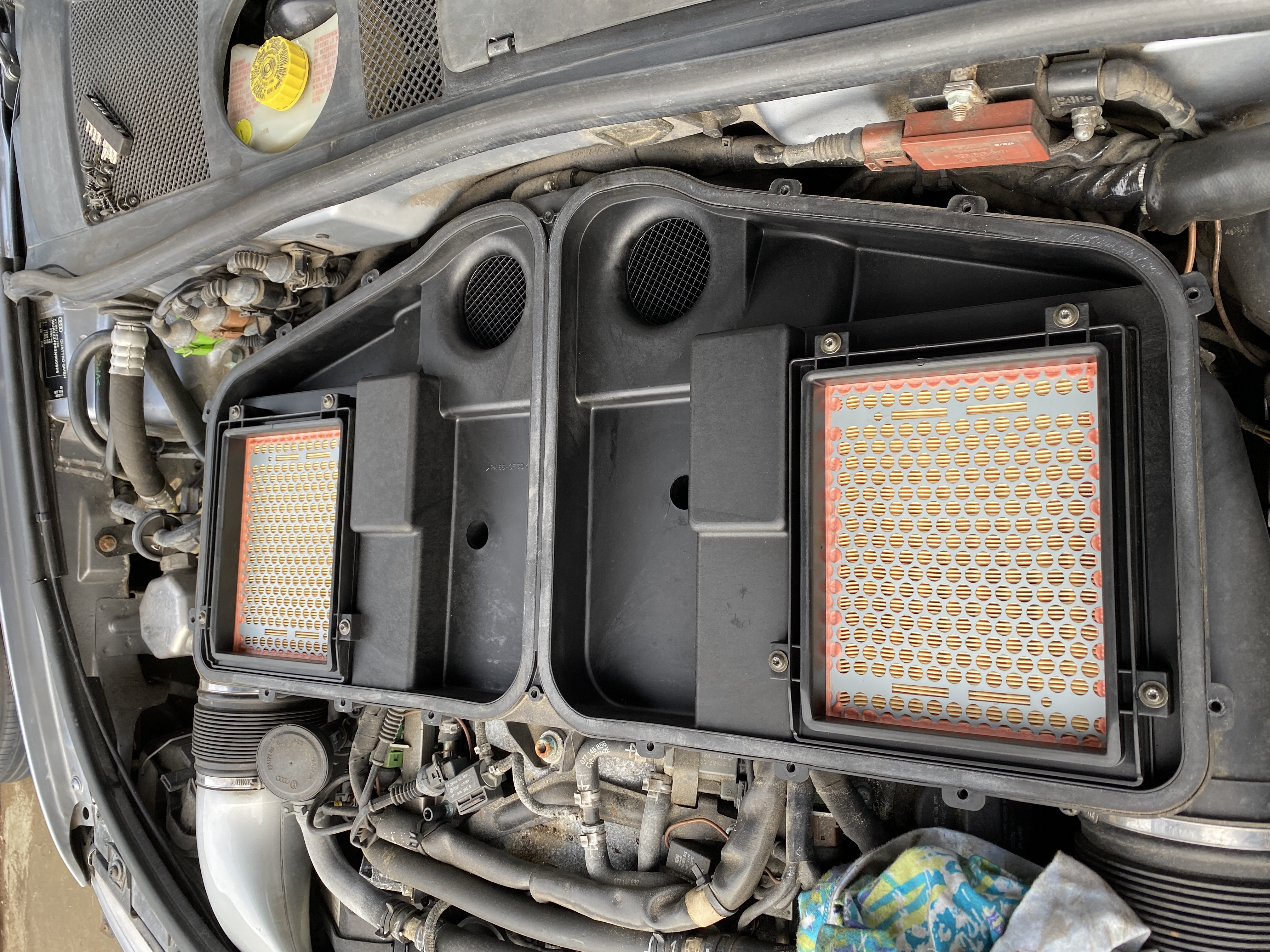

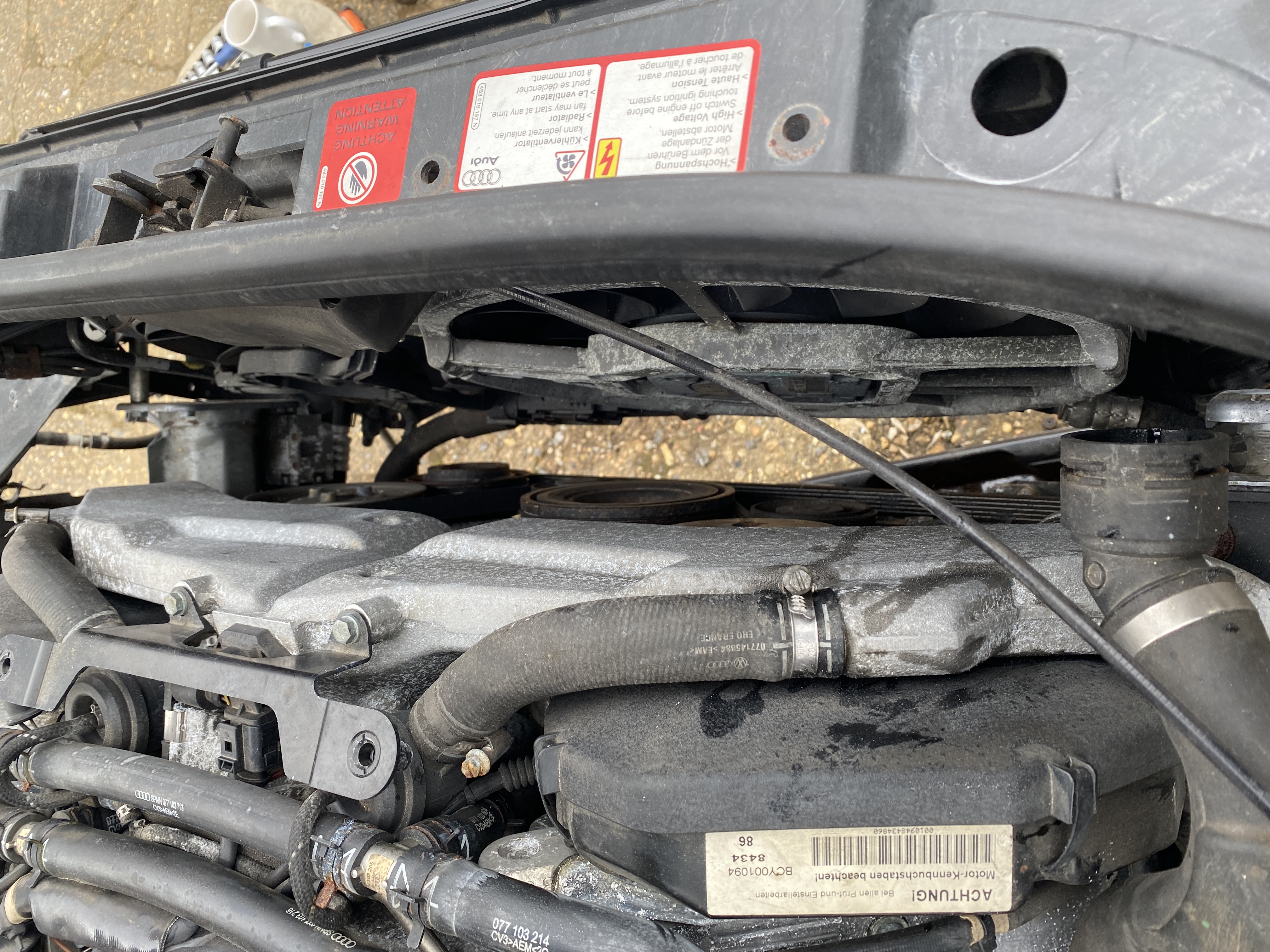

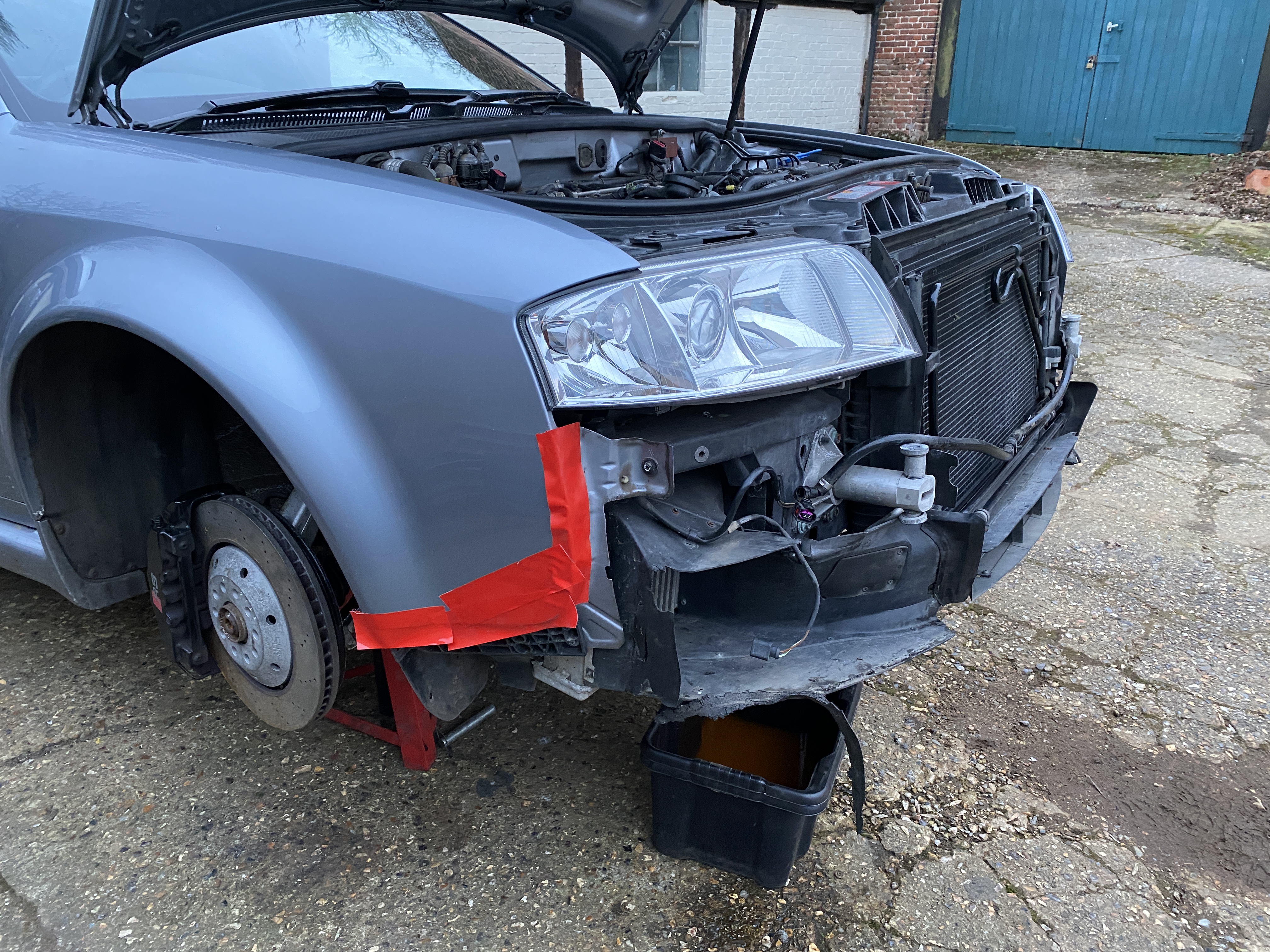

Front dampers done and back on the car, so started to do the cambelt. So far bumper and undertrayoff, Coolant drained and air box off. New air filters fitted as well, so could tick something off my to-do list.
Some of the rubbers on the air ducting between bumper and intercoolers are perished and rotten, so will see if I have any sheet rubber in stock and cut replacements.

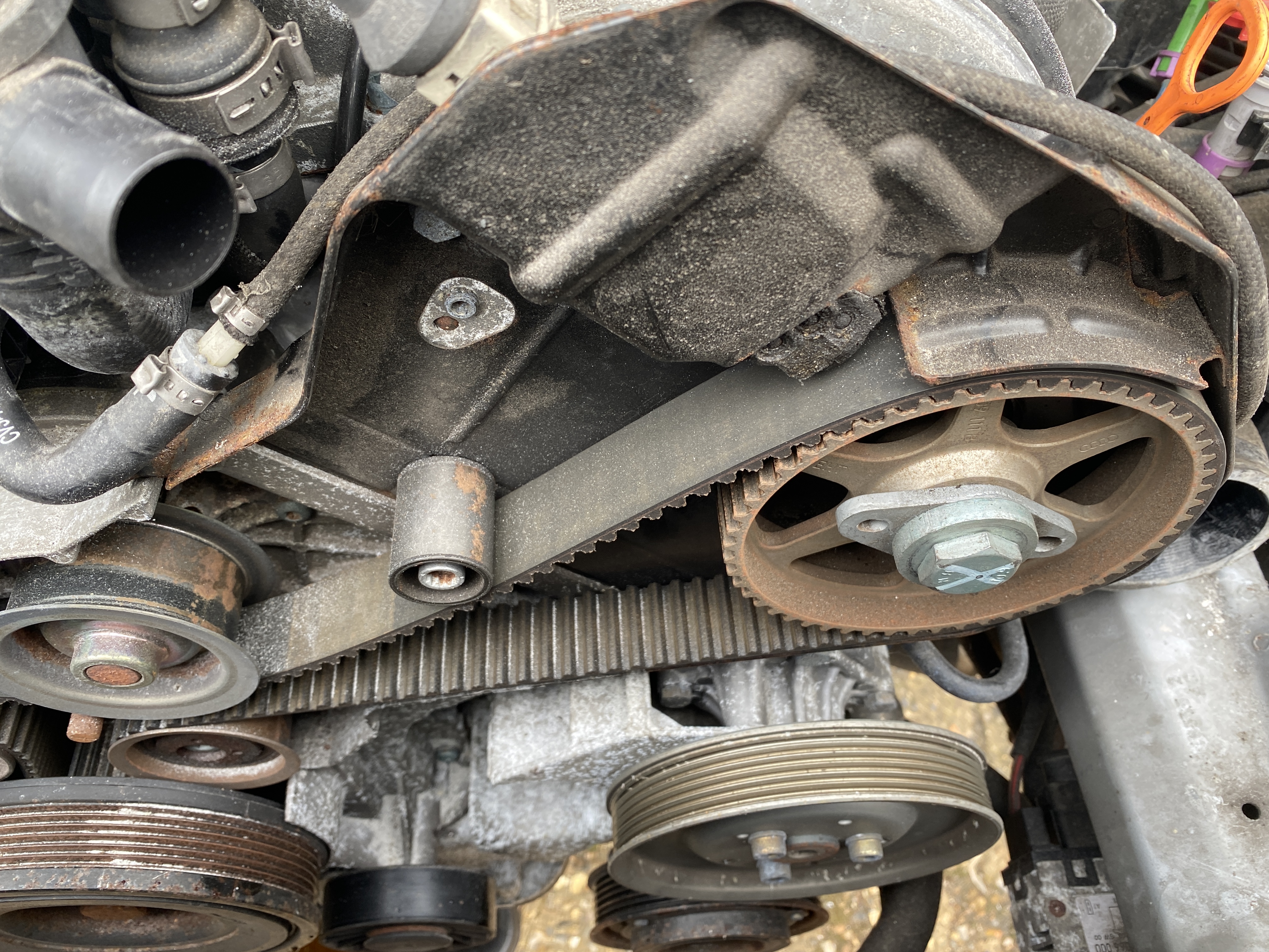

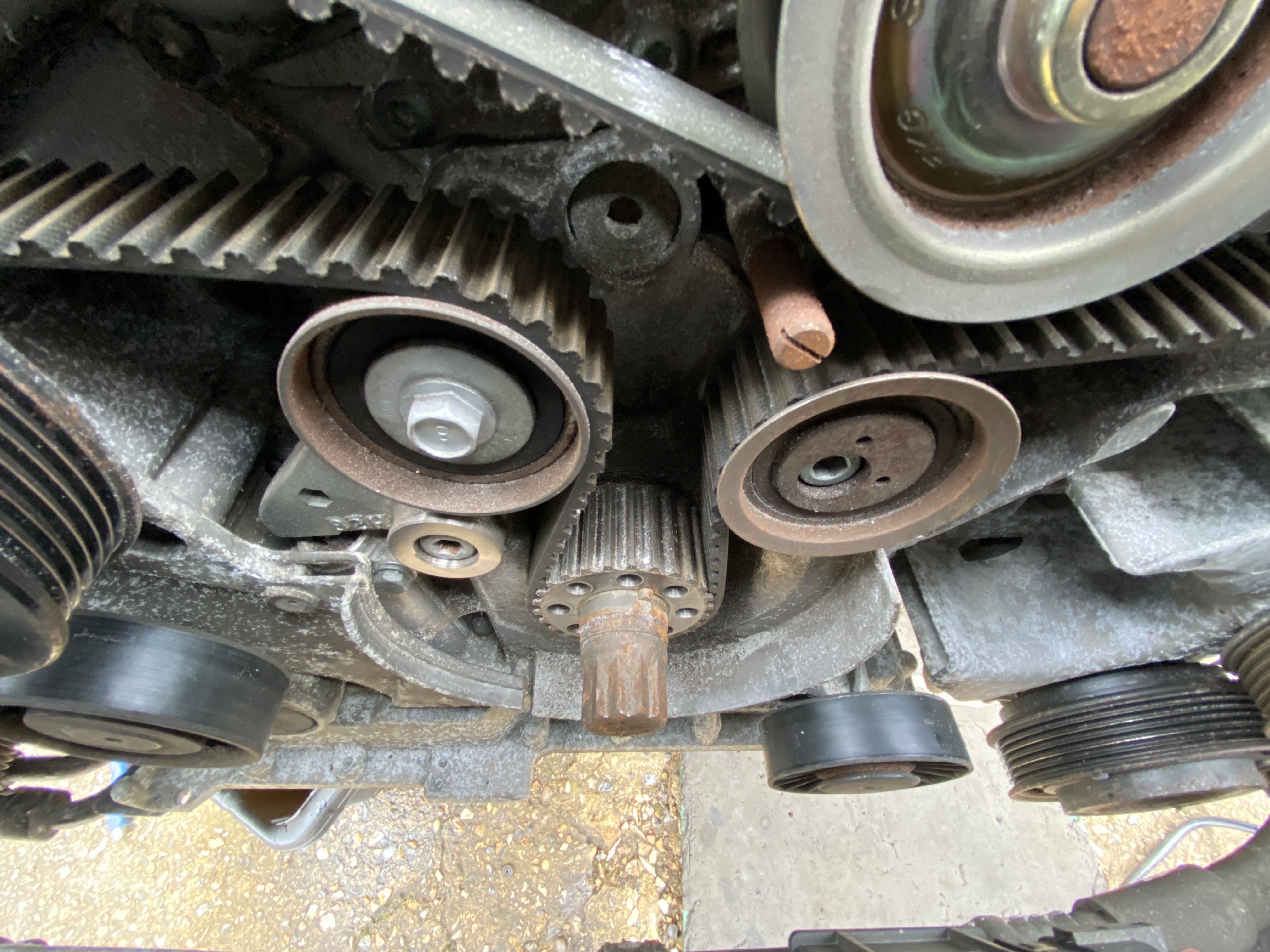

Moderate progress today. Auxiliary belt and cambelt off, thermostat and water pump replaced. All pulleys and tensioners replaced. Now at the stage of refitting timing belts.
Whilst I can’t work on it during working hours I will spend some time during the week cleaning fixings so reassembly will be quicker.

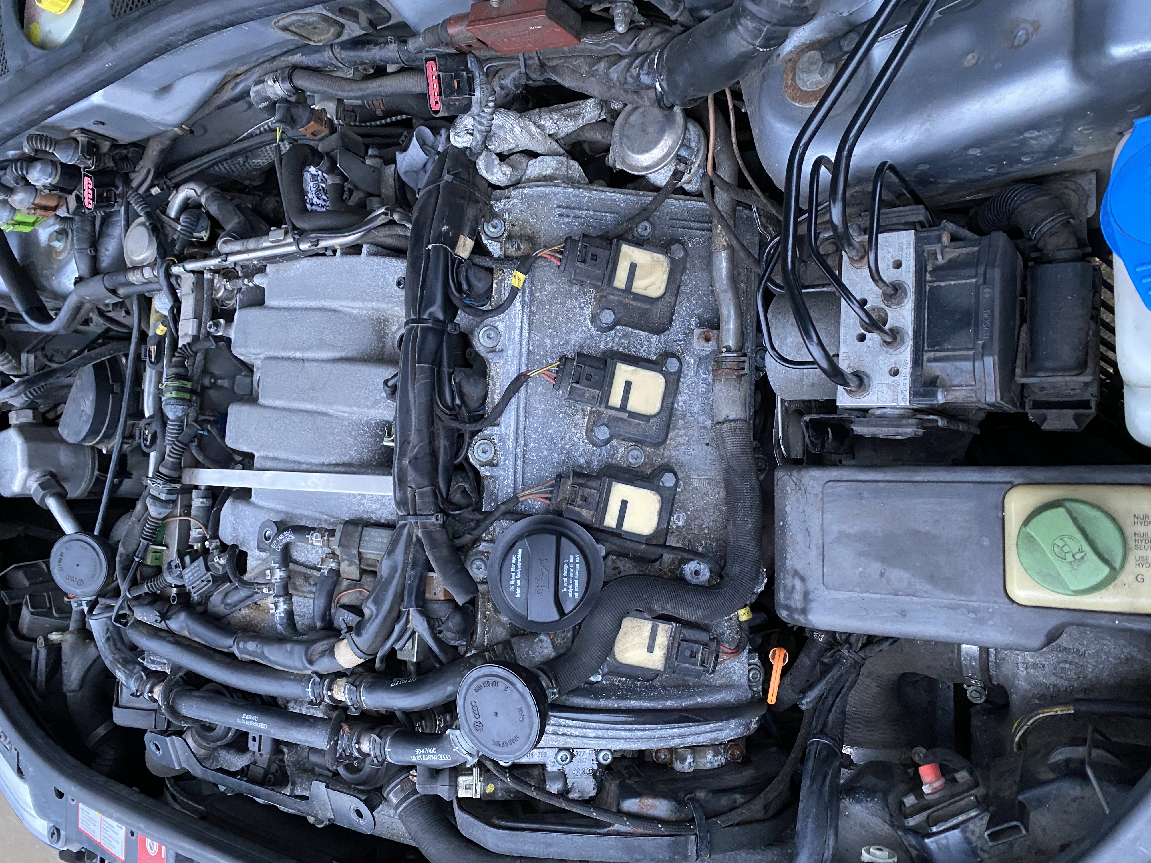

A long weekend coming up which I hope to complete most of the outstanding jobs.
- to finish installing the replacement cambelt and auxiliary belt, and to re-assemble the front end.
- to drain oil and refill with fresh oil and a new filter
- to fill new coolant
- to change spark plugs
- to change fuel filter.
- to refit front wheels, and lower to ground
- to change wiper arms to Allroad ones with fresh wiper blades.
