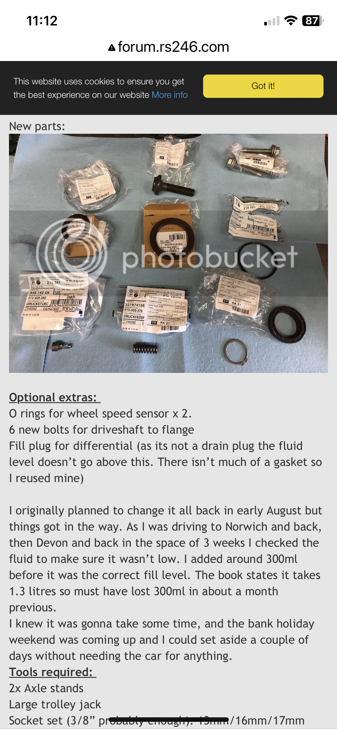

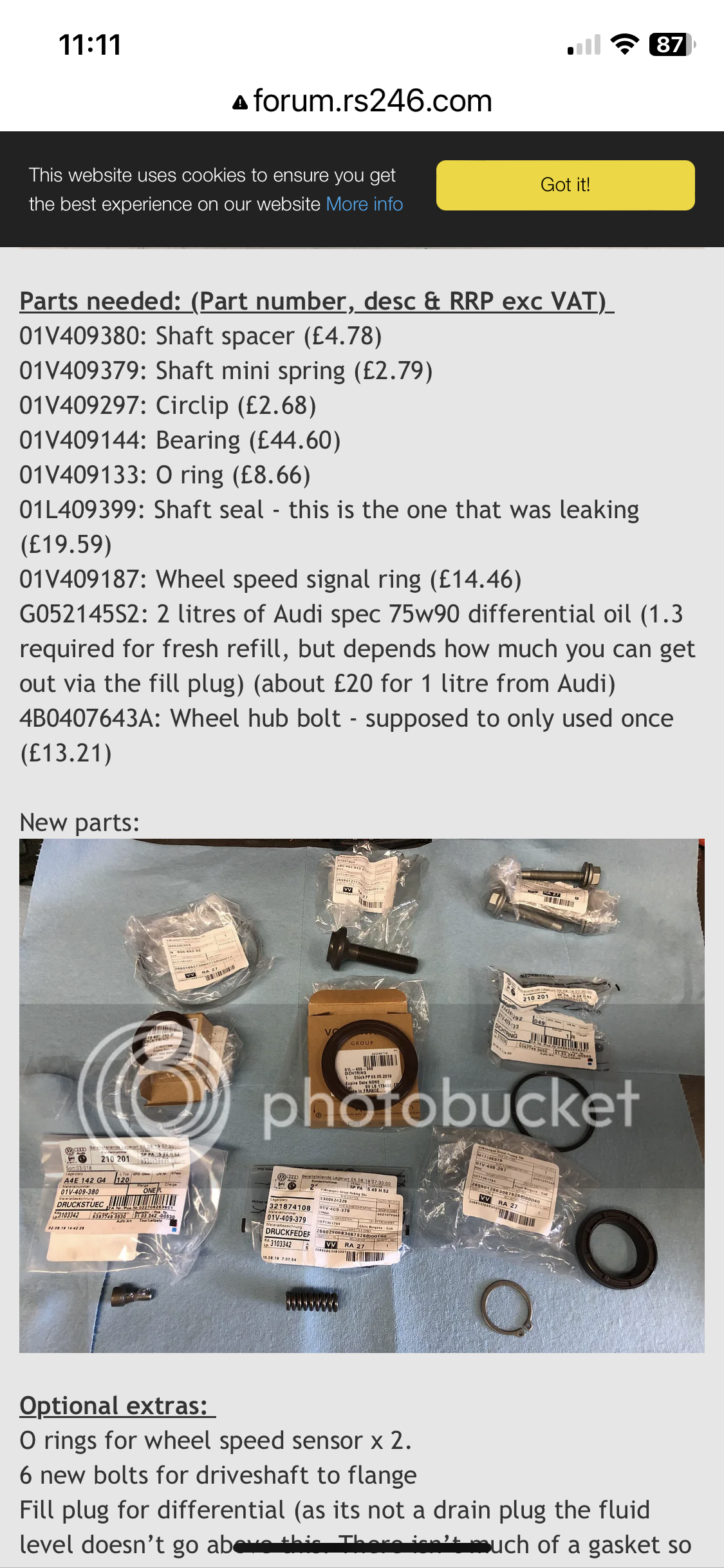

The remaining three parts are due to arrive tomorrow and car is booked In to have the work done.
Hopefully soon have the tiny oil leak sorted from the nearside front driveshaft. It has been a real pain in the backside to identify where the leak is coming from.
Parts have now arrived.
Car booked in 28/07/23 to have the work done.

Hopefully oil leak is finally sorted.
Time will tell.
Cannot believe all the parts on nobbys list were needed and replaced.
Just to renew the ns drive shaft oil seal.
The parts shown on the invoice are those that the garage purchased on my behalf.
I obtained the rest from Germany.
