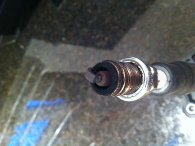

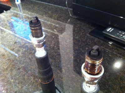

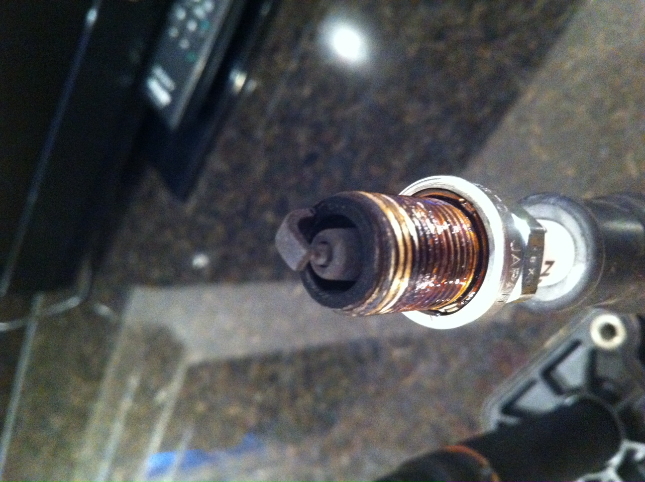

Right plugs from cylinder 6 & 7 out.
There are genuine Audi NGK PFR7Q as suspected
Both plugs quite sooted other than that there fine, cyc 7 one is slightly red around the spline of the plug. Unsure why that would be or mean
Pictures in2 mins
Pictures in2 mins

Re: Possible Issue - New Logs Added - Update 25/3/12
I've seen bright red plugs when using tesco99 or v-bastard, so not something I'd necessarily worry about. They are pretty sooty though! Anything out the ordinary on your long term fuel trims?
You got a set of feeler gauges to gap them? I'd be interested to find out if number 7 is over 0.8mm.

Ok good to know about colouring.
Dont have feeling gauges here, can take plugs to work tomorrow and check, but visually (I know not exactly precise) they look identical gap wise
That is nasty. No point gapping them. They should NOT be adjusted on these plugs.
They are really coked up. I don't believe they have done less than 20k miles.
Mine looked like this after 20k miles:
