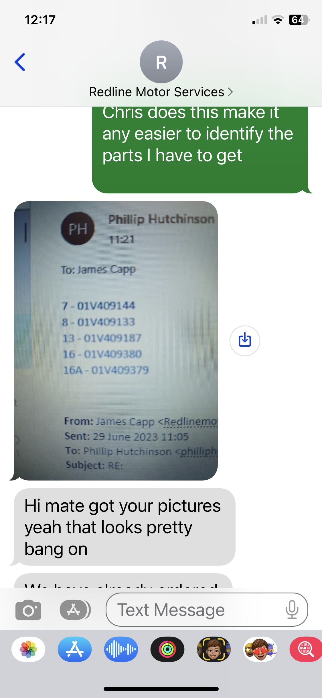

After reading nobby,s excellent how to in the faq section. It became apparent that additional parts are required and not just the seal.
Obviously they are NLA.
Trying to get them from Germany at the moment.
Update to follow.
Update to follow.

I forgot nobby did that DIY. Looks fairly straightforward. What's NLA that you need?
- Posts: 2956
Re: Afterrun fans
Waiting for Germany to get back to me on the other three missing parts.
