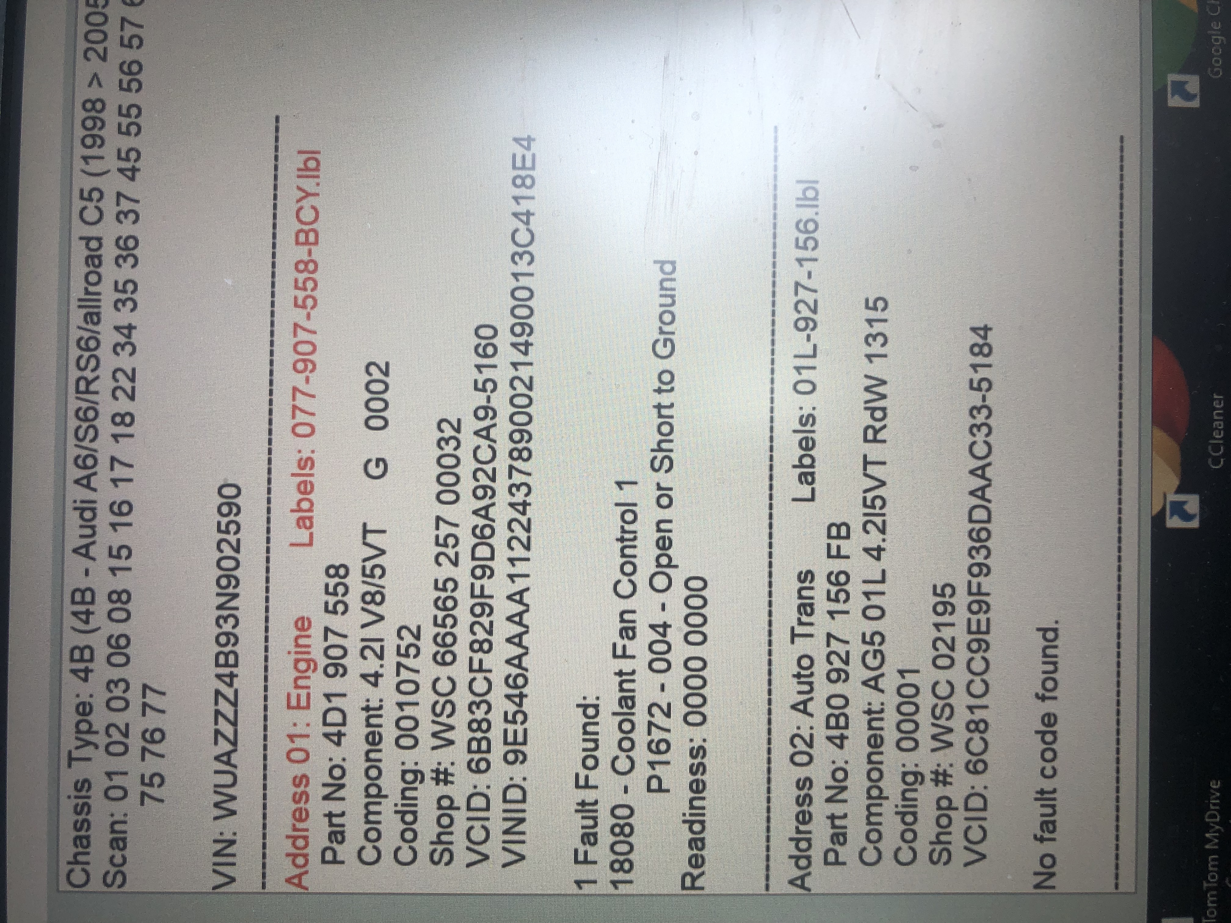

Ran diagnostics.
Error code 18080 p1672 004.
Could not start fan via Vagcom.

Got to go back and check the fuse. The power to the fuse, then continuity from fuse to fan.
Then check the pwm signal at the fan. If no signal, trace back to ECU.
What is the text of the error code?

Hi Ben.
The message was Open or short to ground.
Hope we can get it sorted as the oil temp was at 90-95 on the gauge on short distances.

Success. Problem solved. Bad connection at the plug and socket.
