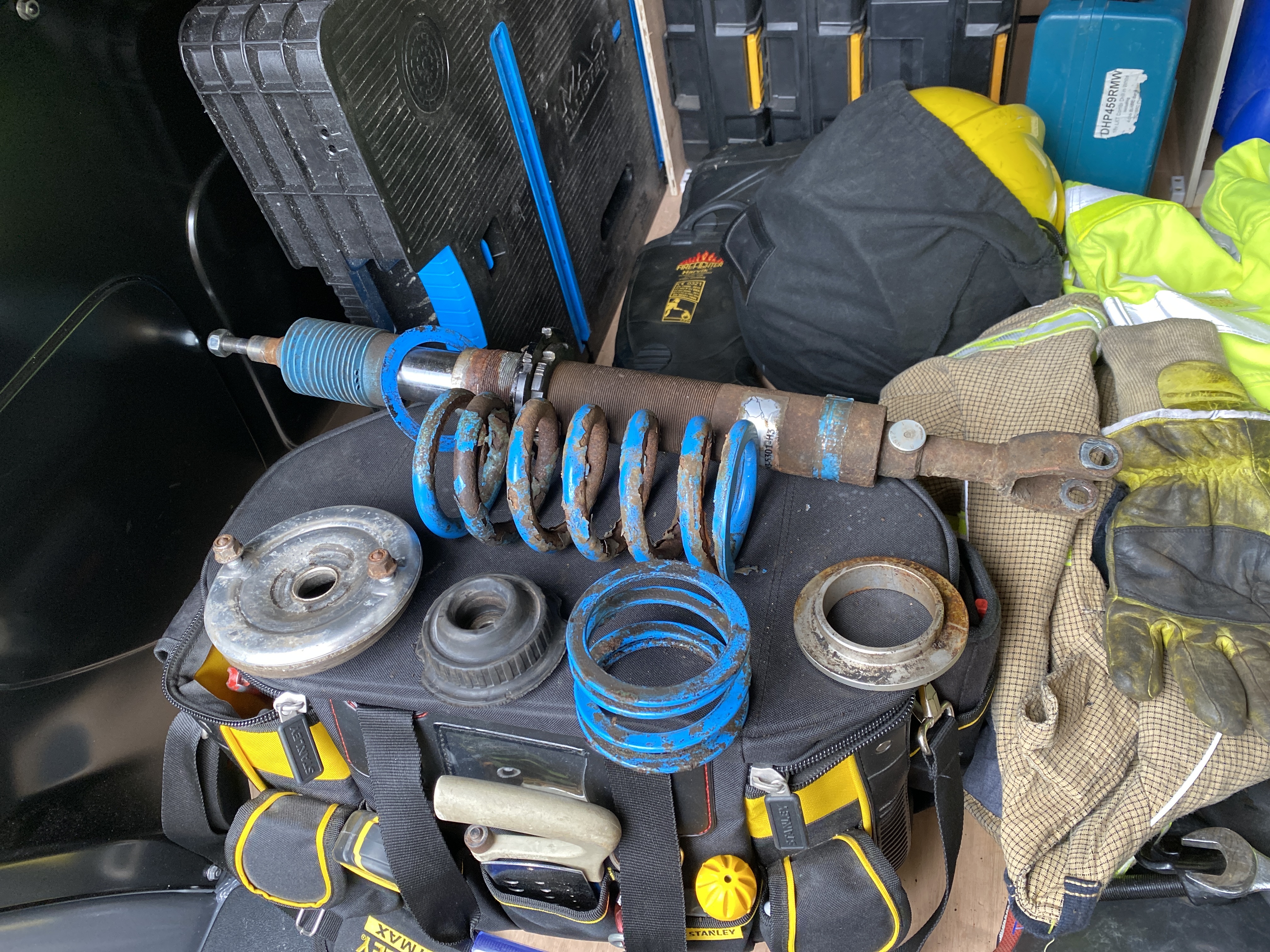

How would you stop the shaft rotating?
I've got a DTD154. I wonder if I can get a 1/2" drive for it.
Mɐʇʇ
Posts: 2725
Re: Coilovers
Post by Mɐʇʇ » Wed Feb 02, 2022 5:40 pm
I wouldn't just bang it on and run it - I'd give it a squirt and expect the nut to come off PDQ. TBH, you could probably just hold the shaft in your hand, that'd likely be enough resistance.
Unless the nut is truly and properly seized on, then you need to get more creative.

Well that was interesting. I ran it up to a mate of mine who works in a garage. He stuck an impact driver on it and it came straight off without needing to hold the shaft. Worth remembering that little trick. 👍

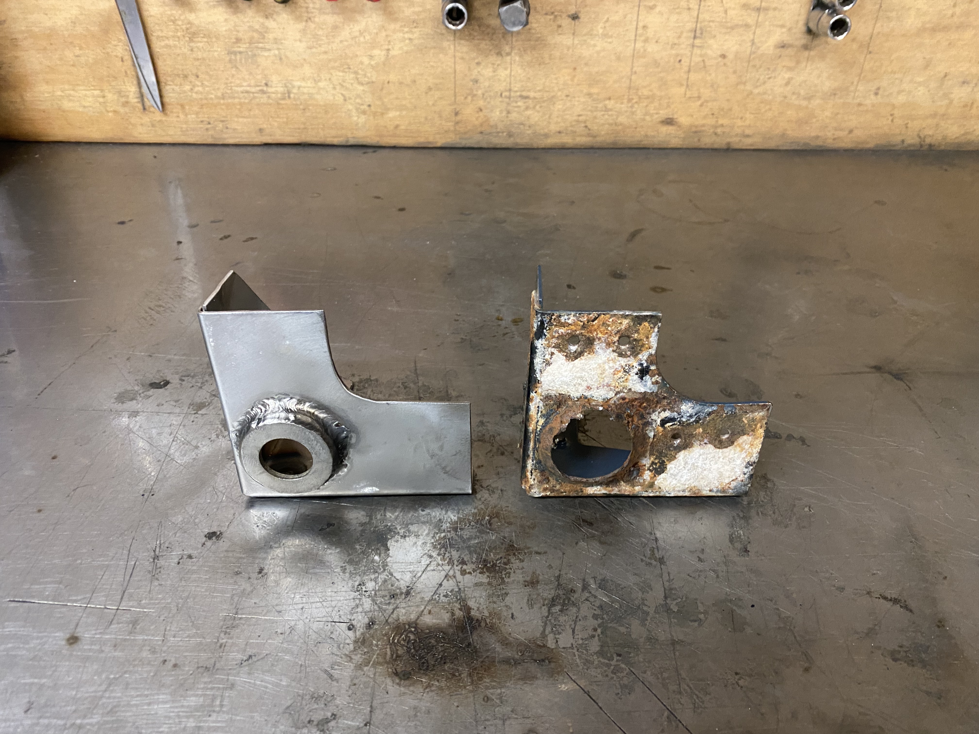

This was last weekends job, which was quite enjoyable - new bracket for the landrover (they don't make those brackets that you can buy) and started removing the bulkhead to make more space inside it too.

Really nice work Matt

Do I need to make a note of which coilover when on which side of the car, which spring when on which coilover and what way round the springs went?
Posts: 20318
Re: Coilovers
Post by Shoppinit » Thu Feb 03, 2022 12:51 pm
Can't think that it would matter, but I would do that as a matter of course.

Chris. Having gone to that trouble. I would find a grit blast cabinet and then give them a good paint job.

I'm with Steve - you want them to go back on looking smart. I got all my springs & steel suspension arms (rear) powdercoated.

Yes, already booked in for PC. I love getting things pc and plated. 😍
